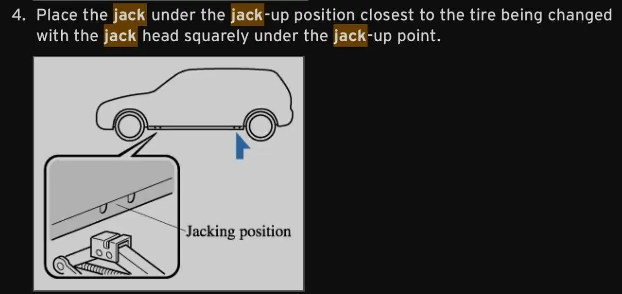

Confirmed by the manual, the car needs to be lifted by the jackpad head contacting the underbody rail and NOT the pinch weld. Available adapters online (rubber and the ones with the.magnets) do not have slot deep enough to accomodate. The deepest one is 0.62 inches and was confirmed by another forum member as a perfect fit. Guess what, I ordered one, just arrived and NO, the slot depth 0.62 does not suffice. With it the car would be lifted against (point of contact bottom of the pinch weld) what contradicts the manual instructions and my intent to have the car repeateadly lifted safely and without bending the weld pinch.

There is no question about the jack placement. See the screenshot. Mazda CX5 2020 manual. You DO NOT lift on the pinch weld.
The OEM scissor jack does a perfect job contaning the pinch weld in the head slot, providing a protection from slipping / sliding agreed. However the pressure for the lifting lays against the inner portion of the underneath rail surface, not the weld pinch.
