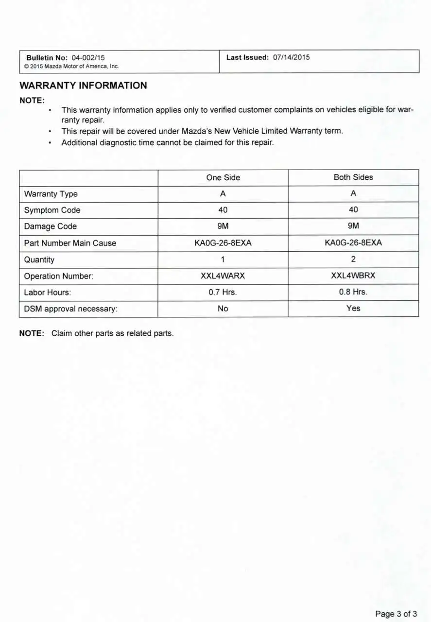

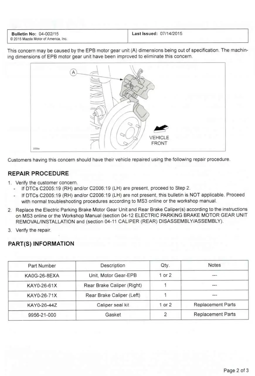

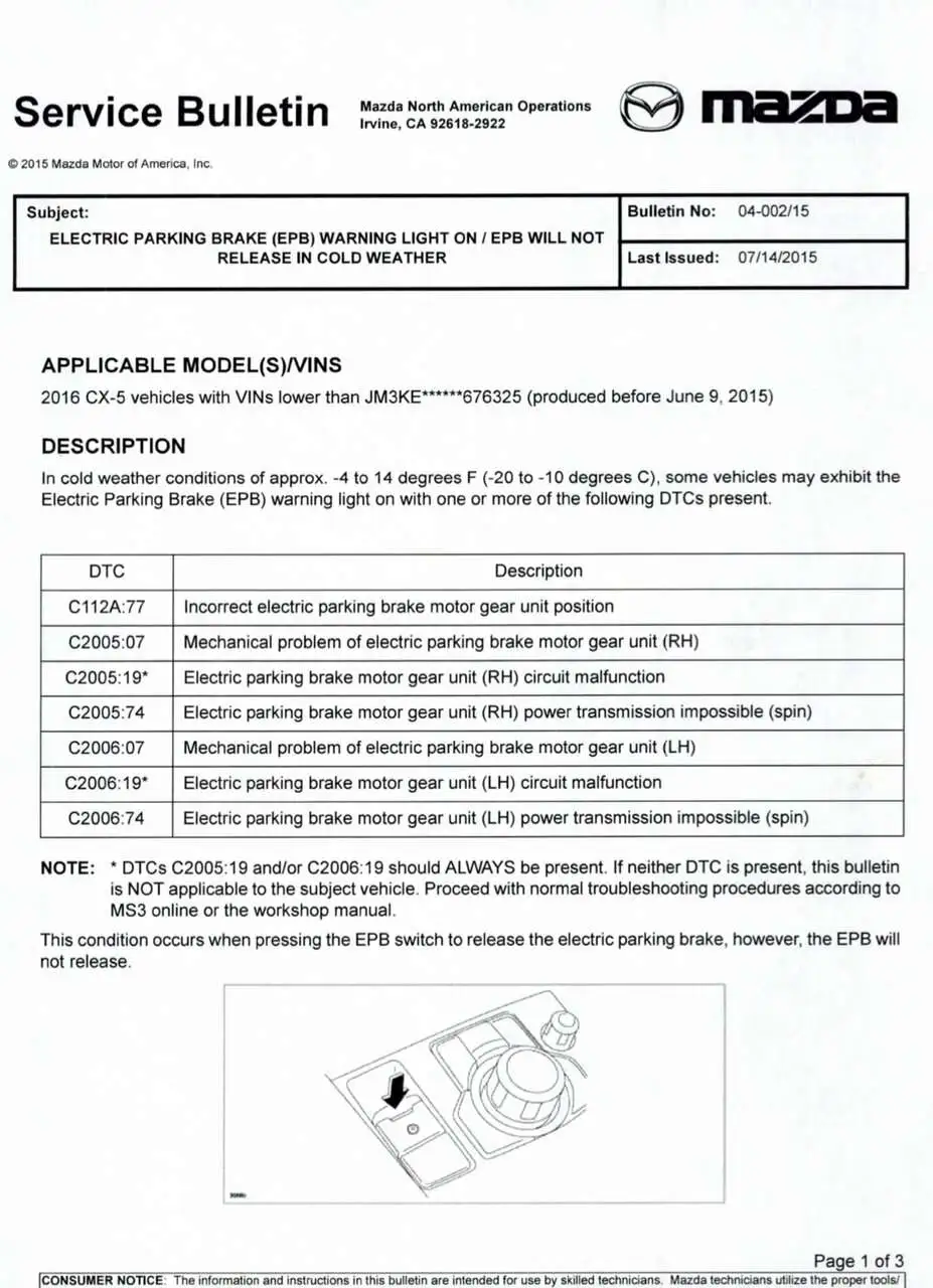

Your 2015 CX-5 with EPB is the US 2016 CX-5 with EPB. Here is a TSB outlined EPB related DTCs such as C112A and C2005 / C2006 for US 2016 CX-5:
TSB 04-002/15: Elecrtric Parking Brake (EPB) Warning Light On / EPB Will Not Release in Cold Weather
CX
