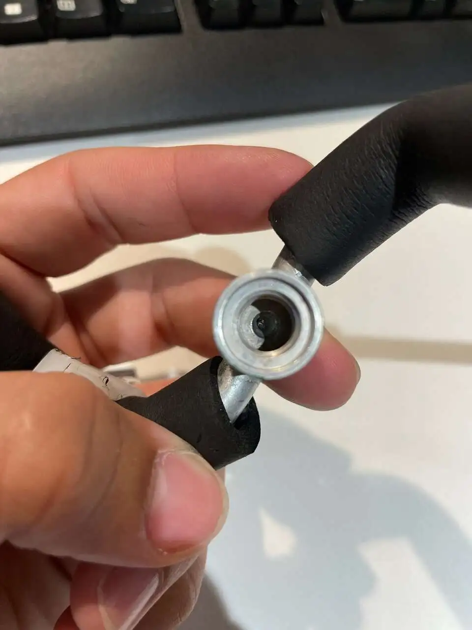

So it appears we have a fix! :) And no, it was not from the flush. The service advisor called my wife saying the flush did not work, as I expected, so he went ahead and had the high pressure line removed. To his and our surprise, he found the line was not bored out?!:eek: He took some pics and I am going to ask to see this in person. A new line is local and they should have it tomorrow morning so we are hopeful that we can pick the vehicle up tomorrow night after work.

Here is pic of the 'blocked' line looking in from the high pressure switch. No wonder it was not working!
