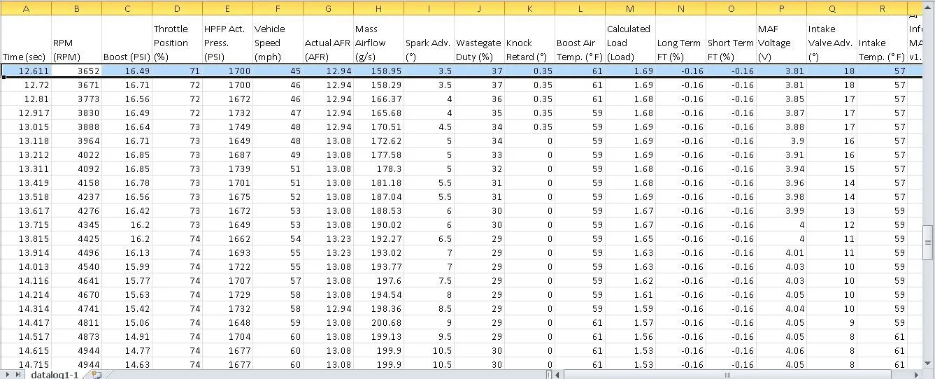

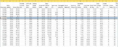

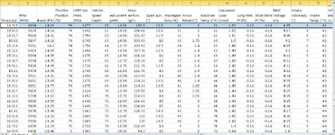

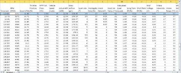

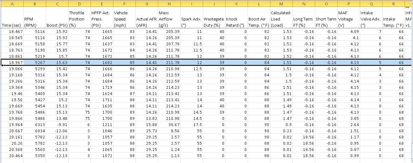

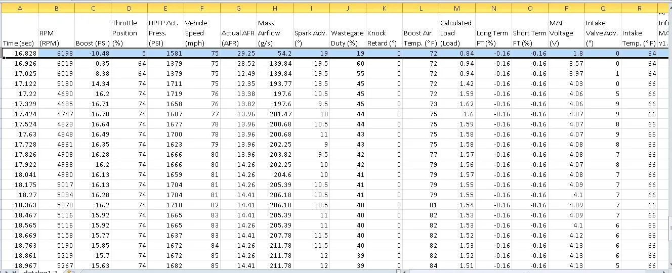

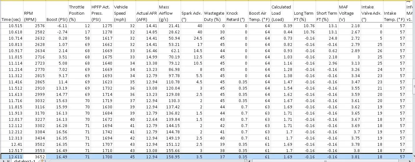

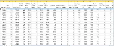

Hi guys, I've been doing some searching but haven't been able to find any posts about a healthy datalog.
Is anyone able to post one up for me or if you all would be so kind as to review mine?
--Sorry does not look like i can upload the csv, so grabbed some screenshots
At WOT my fuel pressure seems okay but there is a slight drop to about 1300psi, in between shifts.
AFR sits at about 13 and based reading seems okay.
This was a 3rd gear pull into 4th.
Running Stage1+SF 91 v234 Map
Mods:
TIP - 3in
MAF adapter with cone filter
Test Pipe
CBE 2.5 inch
Step colder plugs
DogBone RMM
TIA for any help.
