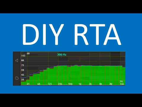

You will need to use an RTA to measure the signal for yourself. The DIY Audio Guy has a video on how to make an inexpensive one.
Yeahhhhh, I had my hopes up that maybe somebody had done this to save me the trouble lol. From my lamens understanding of DSP's you'd need an RTA to "truly" (not just by ear with test tones) tune one anyways, so I guess therein lies my only option. Fingers crossed the signal is flat coming out of the head unit like previous generations to save me from having to get a DSP too, but we'll see!
