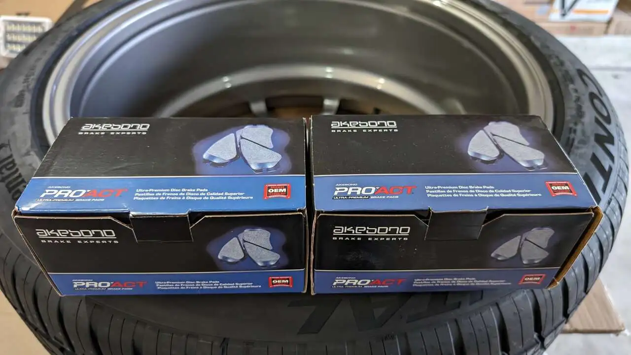

I also ordered Akebono ProACT pads, part numbers:
Front: ACT1258
Rear: ACT1846
