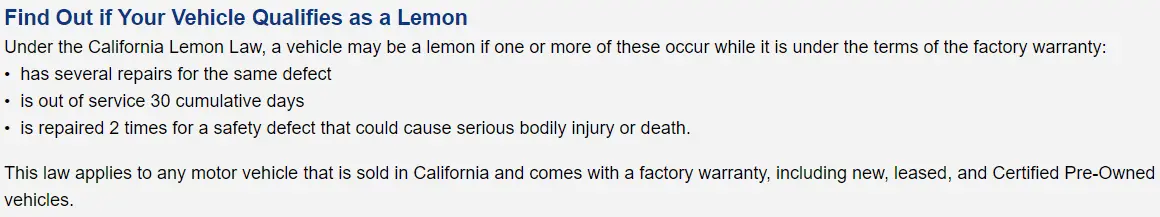

OP,
Keep records of all your visits to Mazda dealers.
Cite Lemon Law when it meets the requirements.
CA law below, but it should be similar for other states.

OP,
