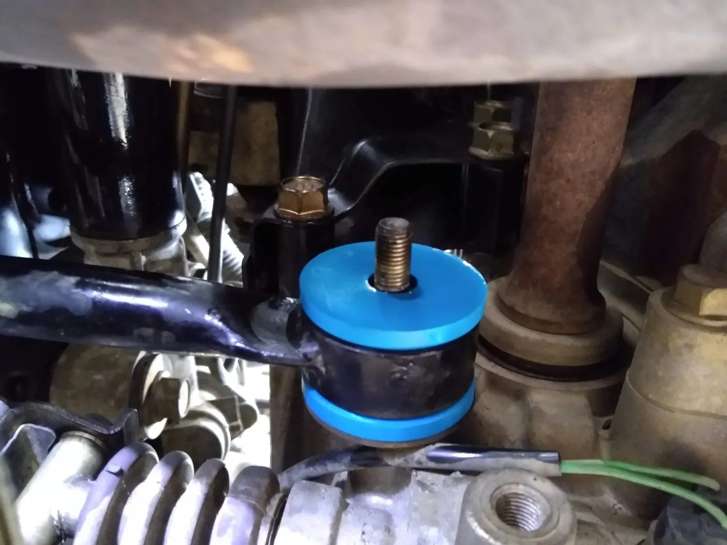

I've replaced all three shifter bushings (including the one that requires drilling/cutting) as well as the other weird one which seems to stiffen everything up (picture attached). I have the Megan Racing short-shifter. Most of my play appears to come from the linkage directly under the shifter, but if I tighten it any more than it is now, it makes shifting very stiff and challenging to get into 1st/reverse. I believe there is also some play coming from the short-shifter pivot ball joint as well, and it rattles in gear. I need to look at it again and see if I can reduce play and stiffness together. I'm looking for a notchy but easy to move feeling.
My rear motor mount is shot and the car bucks some in every gear. I have a new OEM mount, but I haven't attempted to install it and am dreading doing so. Likely going to fill it with something, and also buy the AWR side mount inserts. Everyone I talk to says not to attempt to do it without the manifold out, so I was planning on removing it.

... Everyone I talk to says not to attempt to do it without the manifold out, so I was planning on removing it.
Apparently, you can do it from the top without removing anything.
A few extensions and a 6-point socket.
Break the lower stud off and reach down from the top.
The extensions give a tiny bit of wobble room so the socket fits squarely.
Push down on the breaker bar at the pivot and crank it with the other hand.
Push down hard so you don't round the nut.

Man, it would make things so much easier if I could do it without taking the intake off, but I really don't want to screw up those nuts and get to the point where I just end up taking it all apart anyway. How do you get the mount out and the new one in? Where do you put your hand to get at it? I know you have to support the engine. I've just seen so many nightmare stories of people having so much trouble even with the manifold out.
Someone convince me that I'm not going to screw it up if I don't remove the manifold, because I'm 95% sure i'm going to screw it up if I don't remove the manifold 😬. I'm looking at the replacement mount right now, and I've got other vehicles to drive, I just don't want to get myself into something I can't get out of.
Man, it would make things so much easier if I could do it without taking the intake off, ...

I did it 3 times. All from the top without removing the intake. It sucked all 3 times! But the 1st was the worst. It had just over 100000 miles on it. Those 3 nuts on top were difficult to break loose. Use pb blaster or some kind of penetrating spray. 6pt socket and like 18-24" worth extensions. I used 1/2" drive. The thru bolt i got with like 3' extensions thru wheelwells. Once freed it pulls out from top.
My final install was a DEA filled with 60a urethane hoping iit would last way longer than 100k. So far about 50k on it and Im still happy. Minimal vibes for a daily auto but firm enough to not move the block.
LOL I love the word hearsay, let me just say that. And it turns out I spelt that wrong the first time I posted.
sleeprp5 and pcb have it right.
In my one experience doing it on a 100k mile Michigan vehicle with the engine still in the car, it was:
- pull battery tray
- remove flexy intake doohickey
- take 12" and 3" extensions, put universal joint at the end and a 10mm deep socket and do your damndest to remove the plastic loom housing from the firewall. (2) nuts.
- bust the bottom 10mm stud off the firewall because you don't need that sort of negativity in your life
- find a deep well 17mm socket, and put it on the rear nut first, because that's the one that's most likely to be messed up. (3) nuts.
- remove those bolts and be happy you got the mount off
- somewhere in there you'll have pulled out the 17mm through bolt, which would have been the easier step in the grand scheme of things

Doing it without pulling the subframe, I'd estimate it at no more than a few hours all said and done. Bearing in mind this was done now, easily 3-4 years ago.
Removing the subframe, or at least dropping it, you'd need to:
  • remove the bolt holding the steering column to the rack, marking how the column sits on the splined shaft coming out of the rack
  • undo the outer tierods where they bolt to the knuckles
  • find a way to gain enough slack from the power steering lines so you can adequately drop the subframe without "breaking the seal" on the P/S system OR resign to doing that and remove the supply line on the P/S pump itself, and the suction line from the P/S reservoir. Bleeding that system isn't too hard, but it's just a matter of making sure the pressure line o-ring doesn't decide to be a turd and leak on ya (it shouldn't/ won't. Mark the banjo bolt so you can tighten it back up without worrying about over/under-torquing it)
  • undo the front motor mount - either the mount from the member, or the mount from the bracket
  • undo the longitudinal member - THE BOLTS GOING TO THE CORE SUPPORT ARE FINELY THREADED so be careful when you reinstall. Paint mark those bolts too if you don't have access to a torque wrench/manual. There's also one nut on the backside (nut? bolt? cannot recall)
  • I can't remember if the shift linkage is in the way or not, undo that if required
I think that's it. It'll be a bit more time, but provided everything goes as smoothly as it would if you did it from above, I'd genuinely estimate about the same time spent. But you've accessed the sway bar bushings, which would otherwise have been non-accessible.
Really it's a "pick your poison" scenario...
I'll chime in. My experience with the rear motor mount was fairly easy and the only thing I removed was the intake pipe and strut bar. I will have to say that my experience is the best case scenario because the motor mount was installed for 5000 miles before I decide to change it to something softer. The solid rear was too drony for my personal tastes. I had the car jacked up and with plenty of extensions on hand, I was able to break all the hardware loose. I did have to go underneath to deal with the bolt and nut that goes through the motor mount though. I didn't take as many photos as I usually do but here's what I ended up using to remove the 3 nuts from the motor mount on the top side. Under the car I used some weird combination of extensions to break loose/torque down the bolt and nut. Took me about 4 hours start to finish but again, I didn't have to deal with seized hardware.
I must agree with 323 and 31N007. My 1st try was about 6 hrs. but probably 2 of it was waiting for an extra set of hands with the thru bolt and borrowing a 6pt socket for the 3 nuts on top. After that is was about 2 hrs to change it out. Firewall stud is a pain. Don't even try 12 pt if you've got high miles on it or corrosion. You don't want to round those nuts or worse... break the stud. LOTS of penetrating fluid! Once you've swapped it you will see how the next time will be easier. Not any more fun, just easier lol
