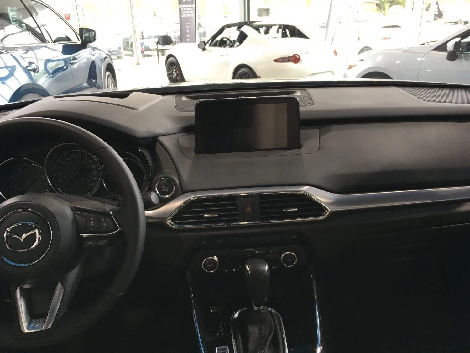

Here is a photo of the screen in my 2018 CX-9 GT (Old photo taken before picking it up). You can see the black edge around the screen.

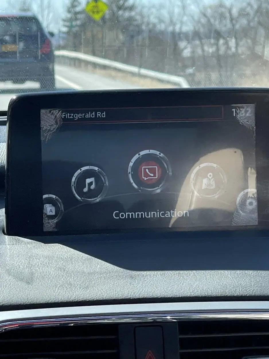

I had the same issue after the cold front came in and warm back up last week. Took it to the dealership they asking over 2k to fix it. Called mazda directly they said my vehicle is out of warranty. Isn't mazda suppose to fix this for free? Or was this on a recall issue?

A special service mailer was sent out, but apparently it was only applicable to 2016/2017 models. Here is a link to a post that shows the mailer. The mailer says that affected models will have the warranty for the screen extended to 7 years to cover the issue.
Attached is the TSB related to this issue, which does include the 2018 MY. I would contact Mazda Corporate again and reference the TSB. If they still refuse, advise them that you will be filing a complaint with the BBB and the NHTSA (you can say the cracked screen makes it hard to read the map when Navigation is used, thus making it a safety issue). Unfortunately the existence of a TSB does not mean that Mazda is on the hook for the cost of the repair, it just means that they have acknowledged that there is a problem and the TSB advises how to fix the problem.
