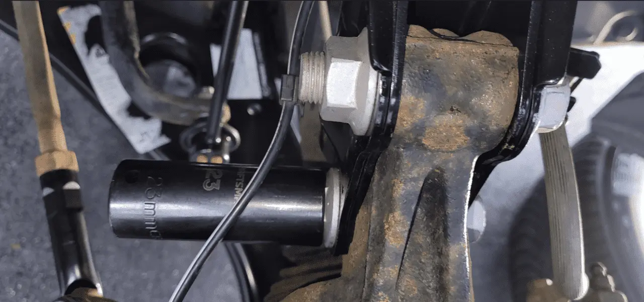

  1. (Highly Recommended) (1/2) Impact Wrench: Used to remove the (x2) 23 mm nut holding the strut into the knuckle. Each nut is about 164-180 ft. lb and would require an enormous amount of force to break it loose by hand unless you use a cheater bar or something else.

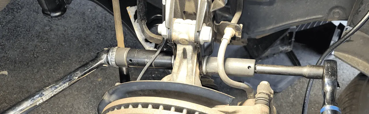

  9. (1/2) 21 mm deep socket: Used to remove the (x2) bolts that hold the strut assembly into the knuckle. If you opt to use the 21 mm deep socket on the bolt side, you will need to dual-wield another breaker bar in order to stop the 23 mm nut from spinning on the opposite side and vice versa.
  10. (1/2) 23 mm deep socket: Used to remove the (x2) nuts that hold the strut assembly into knuckle.

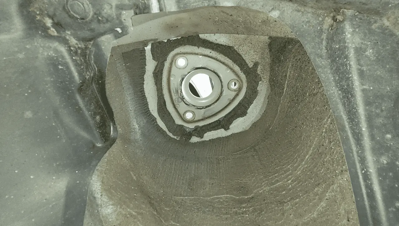

  • When installing the struts, install the (x2) 21 mm bolts into the steering knuckle first with the nuts hand tightened. Afterwards feed the (x3) studs through the top of the mounting area and have a few nuts ready to hand tighten so the strut assembly does not drop down. The steering knuckle is much heavier than the strut assembly so it is very difficult to go from bottom to top with the installation.
  • The strut bolt that is underneath the windshield wiper plastic assembly is a very tight fit; you may need to push up against the plastic cowl in order to get more room to tighten it but I would definitely recommend using a (3/8) 14 mm flare nut wrench to torque the nuts.
  • Removing the (x2) 23 mm nuts on the strut assembly is easier than the (x2) 21 mm bolts because you do not have to hold onto the bolt side with a breaker bar/ratchet and worry about it spinning, especially if you are using a torque wrench.
  • When torqueing down the (x2) 23 mm nuts, there is a good possibility you may need to dual-wield another breaker bar with a 21 mm socket on the opposite end to hold down the (x2) 21 mm bolts so they don't spin when they are being torqued down.

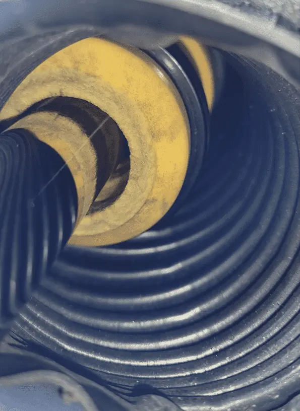

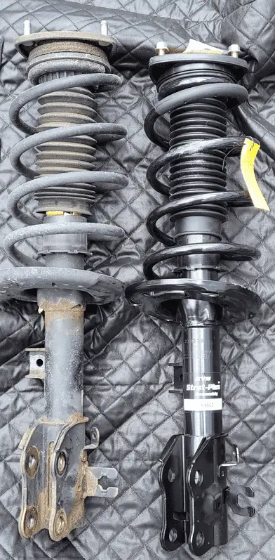

  • The yellow foam inside of the OEM Mazda strut assembly appeared to be broken and that may be the reason why the car feels like it bottoms out each time I go over certain bumps/imperfections on the road.
  • The KYB struts seem a bit noisier than the OEM Mazda struts but for the price I paid for it, I don't think I can complain as I would probably need to spend $500-700 to purchase all of the individual components that make up the strut, not including the strut compressor which is an extra $50 - 800 depending on which model I wanted to get.
