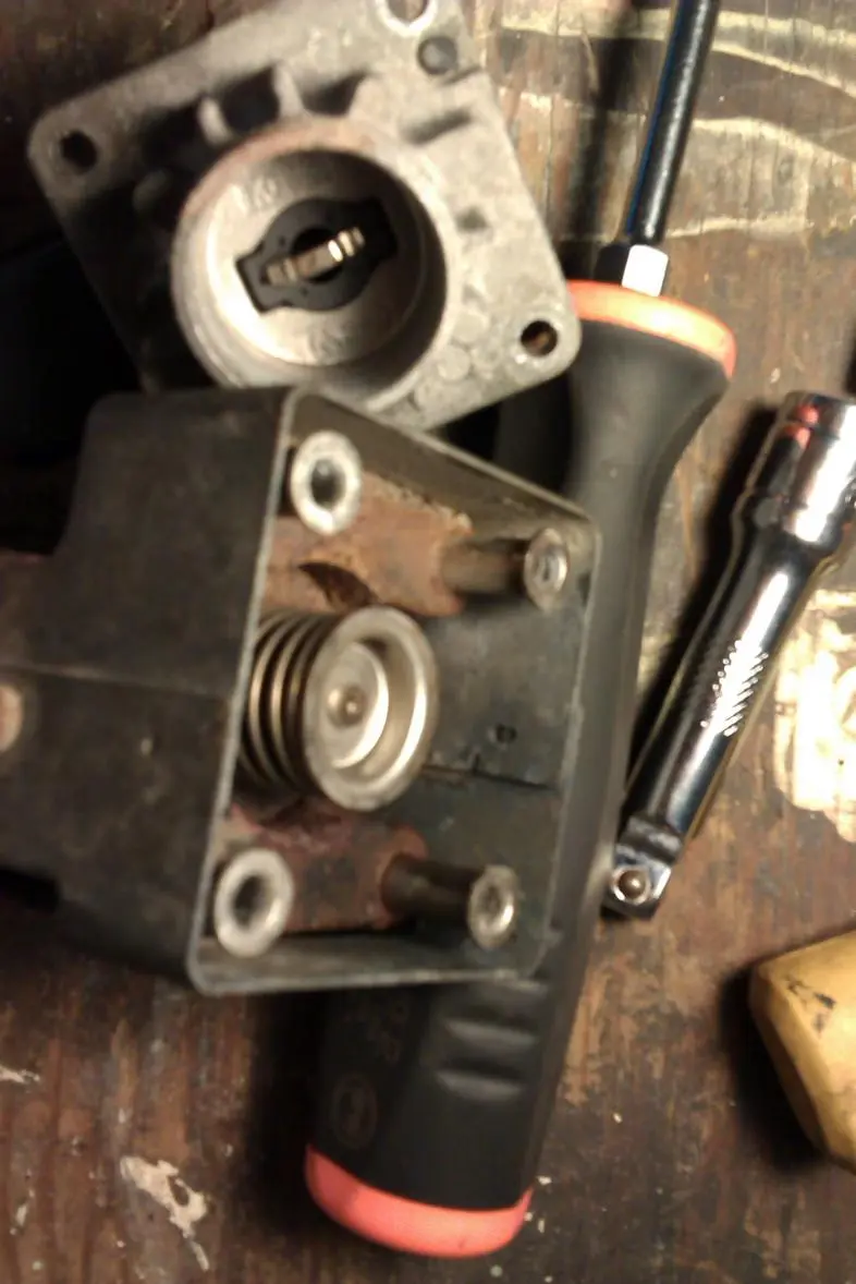

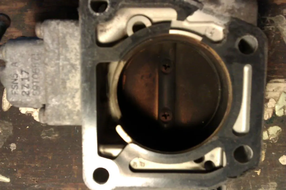

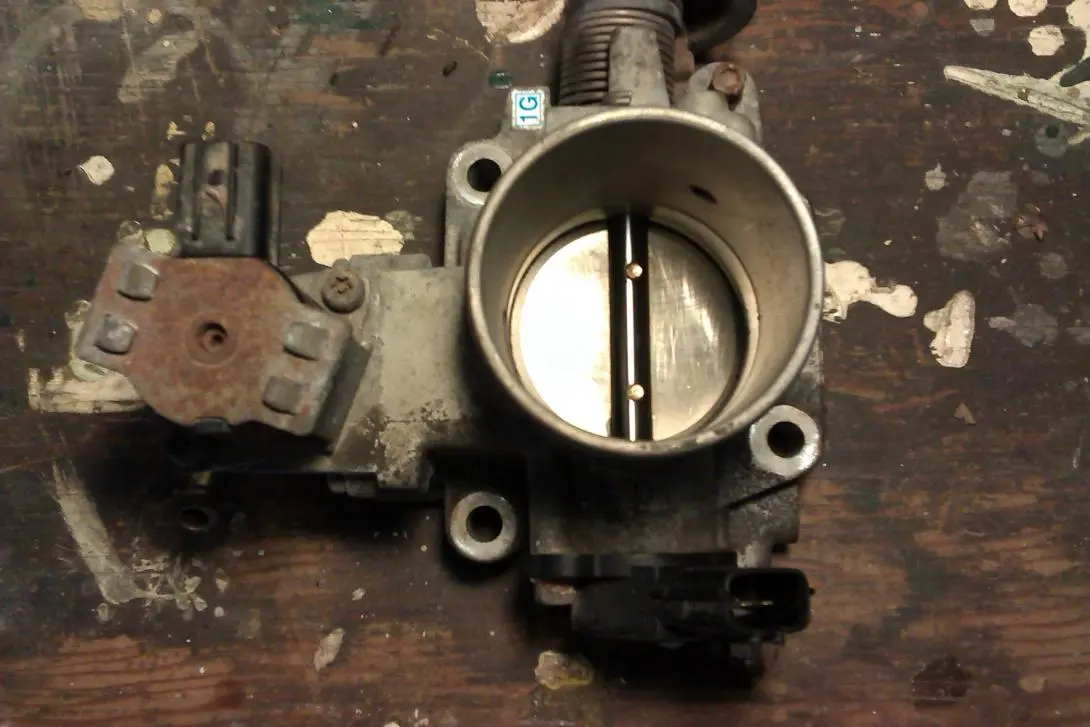

I just finished taking out the the throttle body and the ERG valve. Pics are attached. They both look a little carbon-y but I wouldn't think they are blocked.
One thing I am concerned about is the normal operation of the ERG valve. I've never looked at one of these things before but it seems to be that it could be stuck. If I push it down, the spring does not pop back up. It sticks and needs to be pulled up. Here's a video that shows what I mean: http://www.youtube.com/watch?v=00cE1gU4d38

If the egr is stuck, give it a good cleaning.........also change your coil packs and plugs. Problem should go away with those three. What you have is a common problem.
Hi, appreciate the response. I was on hold for a while waiting for a gasket to come in. The old throttle body gasket was toast and just installed the new one. Replaced both coil packs and all plugs. I had also taken the EGR valve off and given it a cleaning. It was sticking when I first took it off but after the cleaning + a little oil it was moving freely and the spring was working fine.

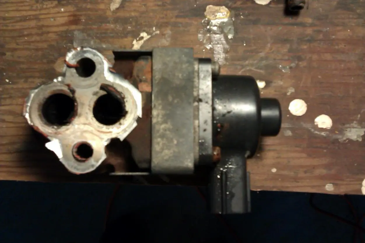

I'd been thinking that it was the IAC valve, because that's what controls the idle. And because it's one of the first steps in the service manual for this rough idle/stall problem. I took it out, cleaned it again, and put it back in. At this time I also noticed that I had mistakenly put in the old PCV valve instead of the new one. So I swapped that immediately. When I fired it up, it started and idled like a charm. Took a test drive around the block, waited for the temperature to warm up and then took a full throttle + lots of stops cruise down the country road. No problems, everything's great.

- cleaned EGR valve with brake clean and old toothbrush (the spring was stuck and the valve was constantly in the open position).
- oiled EGR spring with penetrating rust inhibiting lubricant so valve springs back to closed position.
- cleaned throttle body with brake clean and old toothbrush
- replaced throttle body gasket
- tested resistance at IAC valve (should be between 7.7 and 9.3 ohms)

- tested voltage at throttle body sensor (should be between 4.5 and 5.5 volts when ignition in "on" position)
- cleaned IAC valve with brake clean and old toothbrush
