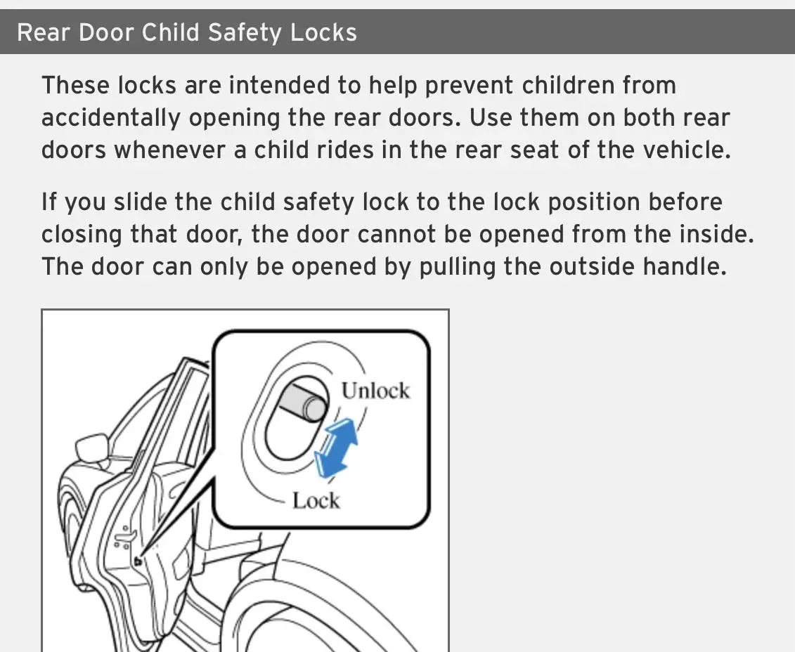

Are the child door safety locks off? If on they might interfere with the windows.
