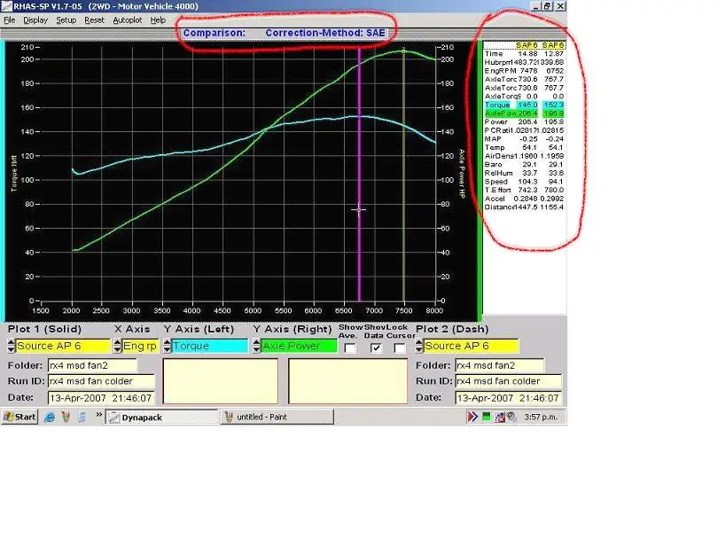

I think they call that type of dyno "Dynapack." To interpret the data you need to see the full chart, which has a sidebar on the right side. The sidebar tells the story. And it needs to be SAE corrected for whp and not flywheel hp and torque. Otherwise the operator can make changes to the graph. And yes, the operator can make an estimate for driveline loss, enter that in the database (it would be shown in the sidebar) and you end up with an inflated number for flywheel power rather than whp.
Could you get and post the full chart with the sidebar? That would help us understand what kind of power you are putting down and whether the Protune really helped you.
Here's a representative example of the full chart from a run on that type of dyno. The circled area at the top shows the SAE correction mode. Note how that is different from yours which shows flywheel power. The circled area to the right is the side bar I was talking about. This chart is not on an MS3. I just post it to show you what a full chart should look like. You can get hoodwinked by the dyno operator on a Dynapack machine if you are not careful.
If you look at the dyno graphs again you'll see the "comparison" mode graph shows SAE correction at the very top of the graph (I never touch the correction factor) and the "split" screen mode shows the TCF at 1.00. The TCF is where you can correct for drivetrain loss, etc and can be the "fudge" factor that some operators can change to add a % correction factor to the power/torque. 1.00 is no correction, 0.90 would be -10% lower, 1.1 would be 10% higher, etc. The dyno displays "flywheel torque" as "torque" its just a labeling thing with the dyno, keeping in mind the dyno is manufactured in New Zealand. We have 2 in house dynapack dynos both 2wd and 4wd, our newer 4wd PC shows "torque/power" and our older 2wd version displays "flywheel torque/power". Both read the same, again its just a software labeling thing that was done on the older models.

Thanks for the clarification. Could you post up the whole chart with the sidebar please? Other Dynapack dyno chart's I've seen do not say "Flywheel Torque" or "Flywheel Power" unless a correction factor was added. I'd just like to see the run data, if that's o.k..
