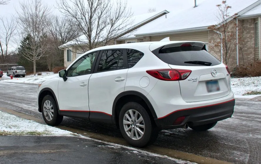

At first I chickened out and intended to add a red line around the black bottom trim only, like this:

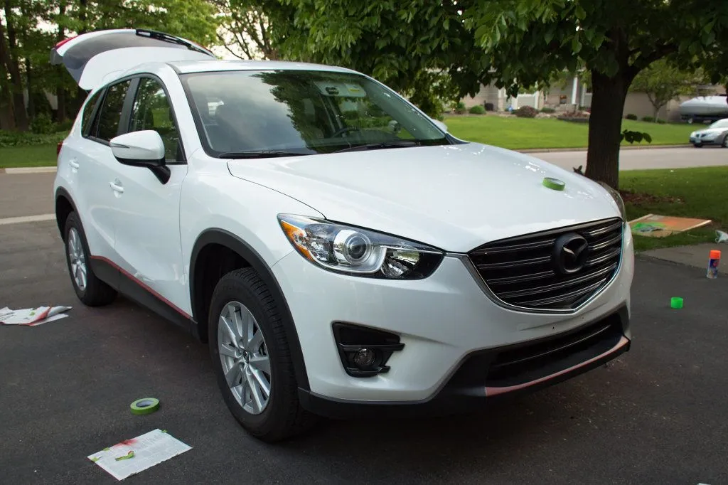

For the kind of thing you're planning, the most important thing is to peel your tape immediately after laying down your last coat of dip, while it's still good and wet. Otherwise you'll pull the dip up with the paint.
Also, as mentioned before: many coats so it's easier to peel. Rubbing it off tiny bit by tiny bit isn't much fun.

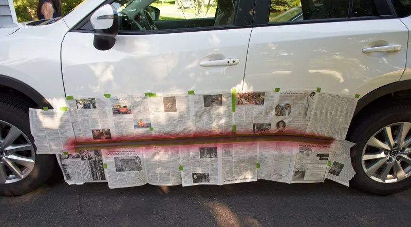

But wouldn't the previous layers already on top of the tape? Peeling the tape off will also pull those previous layers together. I'm planning on trying to run a small rounded-tip plastic toothpick lightly against the edge of the tape immediately after applying every layers, the paint will still be wet so no pressure needed to damage the paint. It takes a little more work, but at least will disconnect the paint from the tape completely from early on.

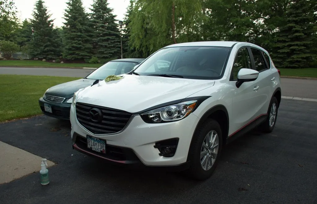

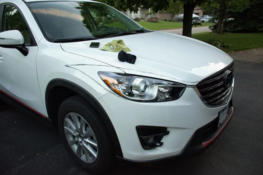

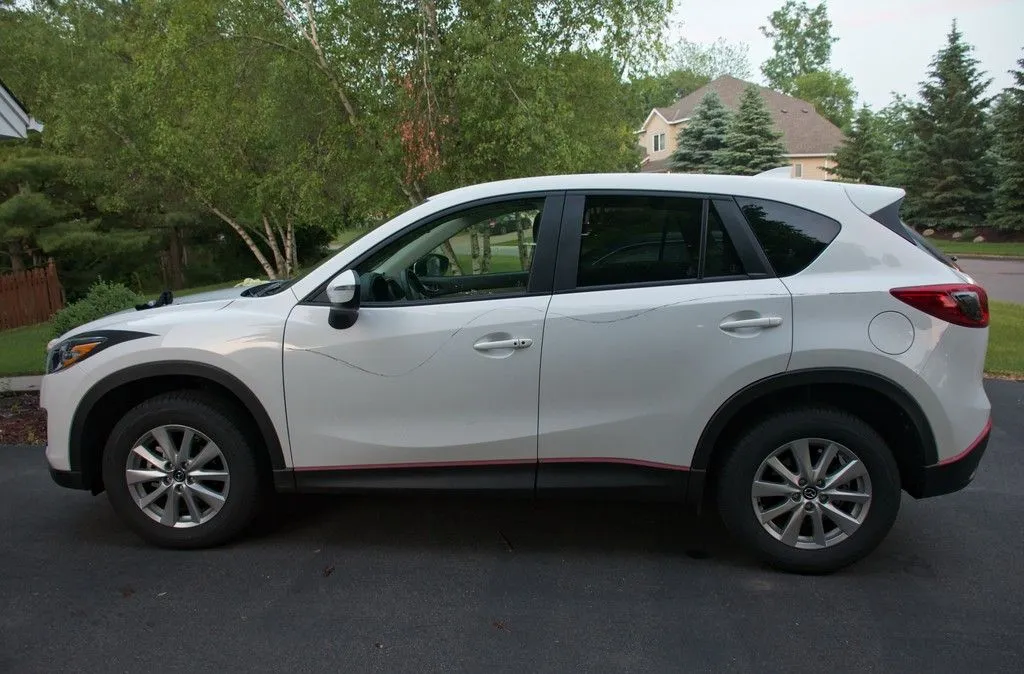

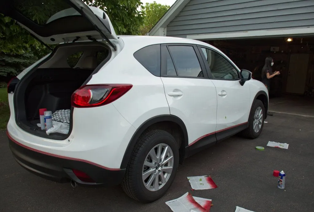

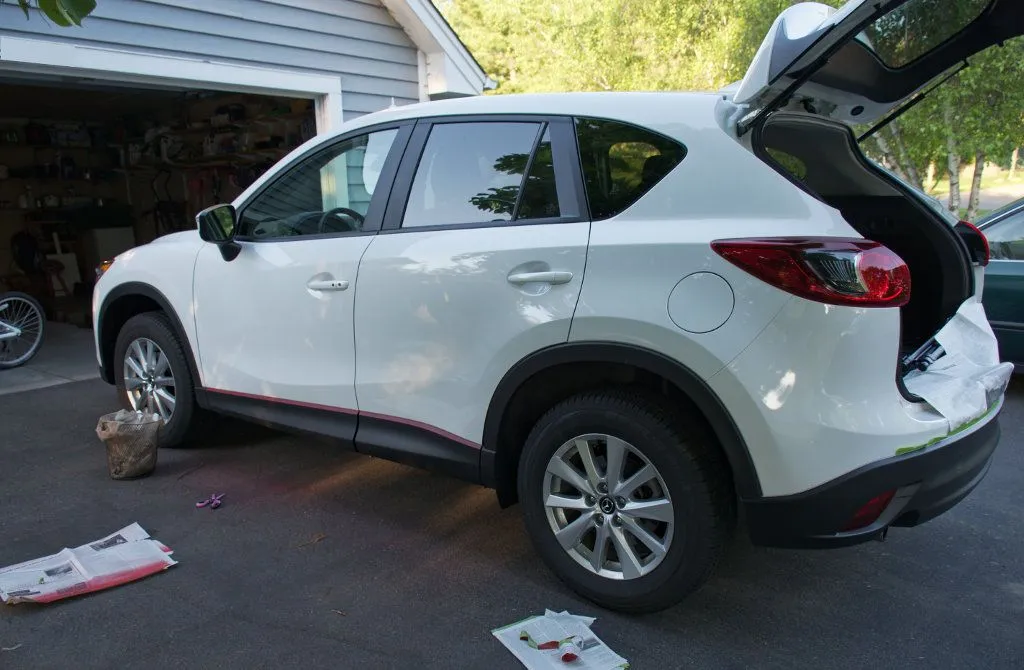

Got to play around with dipping last weekend (with some saving on the cans at Menards). The instruction on the can says to wait 20-30 minutes between coats, but I've only waited about 4-5 minutes when doing the driver side. When I peeled it off, had to use a piece of thin plastic to cut/saw vertically along with the tape, not too bad. However, the rear side is not that easy, especially the upper edge was on paint so I couldn't score it off.

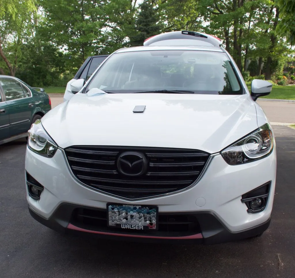

Thinking about what Foolish mentioned, I thought your assumption was that the paint would still be wet when applying the last coat, so I tried the front lip with 7 coats, but with only 30-40 seconds in between, paying attention to not overspray it to drip. Peeling was much easier, no sticking to the tape at all as the PD was still wet. Same for passenger side. I might do the back again if it won't hold up due to some lifting along the upper edge.
In the photos below, the red stripes are not that red due to the sunset lighting, but they look red-er. I could have gone with white for the first 3 layers, then red on the last 4 layers, that would make the red more vivid. However, I think the bright red might be too aggressive, I like it subtle like this.
While blackening the emblem, I accidentally sprayed it on the hood, didn't take much to rub them off, so it's quite safe. I'll probably do the eyebrows today.

You can probably see the passenger side is still wet after pulling the tape off. Ignore the young lady in the background, she's just dipping her bike.

Looking good, I always wants to do the same thing but I just can't make the line straight. I think a red sticker line will be better solution for me, your car looks really good.

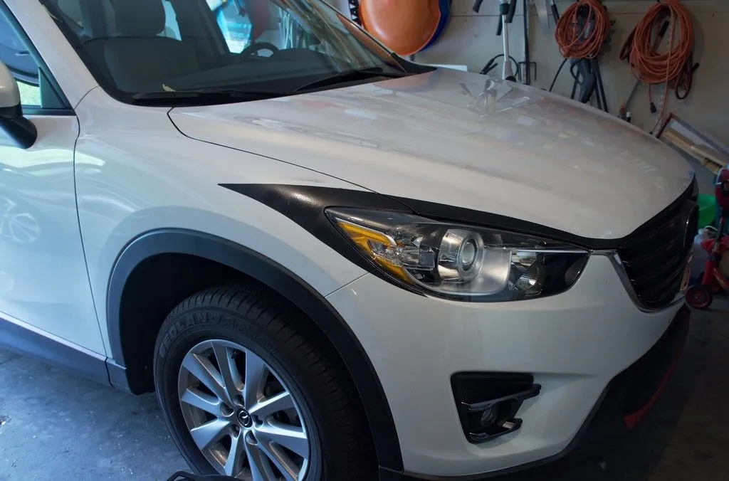

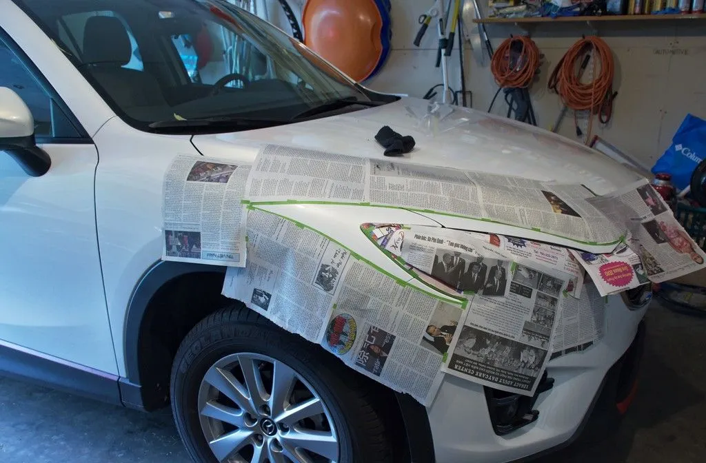

Did the driver-side eyebrow first, looked at it for a few days then made some minor improvement for the passenger-side. I might redo the driver-side, but too lazy, maybe after it starts peeling off. Same technique as last time: 30-40 seconds in between coats (4 total), peeled the tapes off while it's still wet. For taping, cut the tape along its length into half, easier to curve.

Also, while I was playing around with the eyebrow, I noticed that the straight line right below the window is a little "too straight", so I drew a curvy line simulating a string flying in the wind. Not sure where I'm going with it at this moment, but I think it softened the side and added a sense of "motion" to the car. Just throwing it out here hoping to steal your ideas :-)
I can't keep it straight in one go neither, the longest piece of tape I use was about a foot, most were just 2-4 inches, some are less than an inch for the curves. They just need to overlap a bit, and when peeling off, just peel from the side where you started so that the earlier segments (which is under) will also pull the later segments.

Washed the car today in order to see where to rub off accidental PD, found a few tiny chippings on the front bumper and hood, probably will apply a few coat of glossifier to see if it can act as a protection layer.
