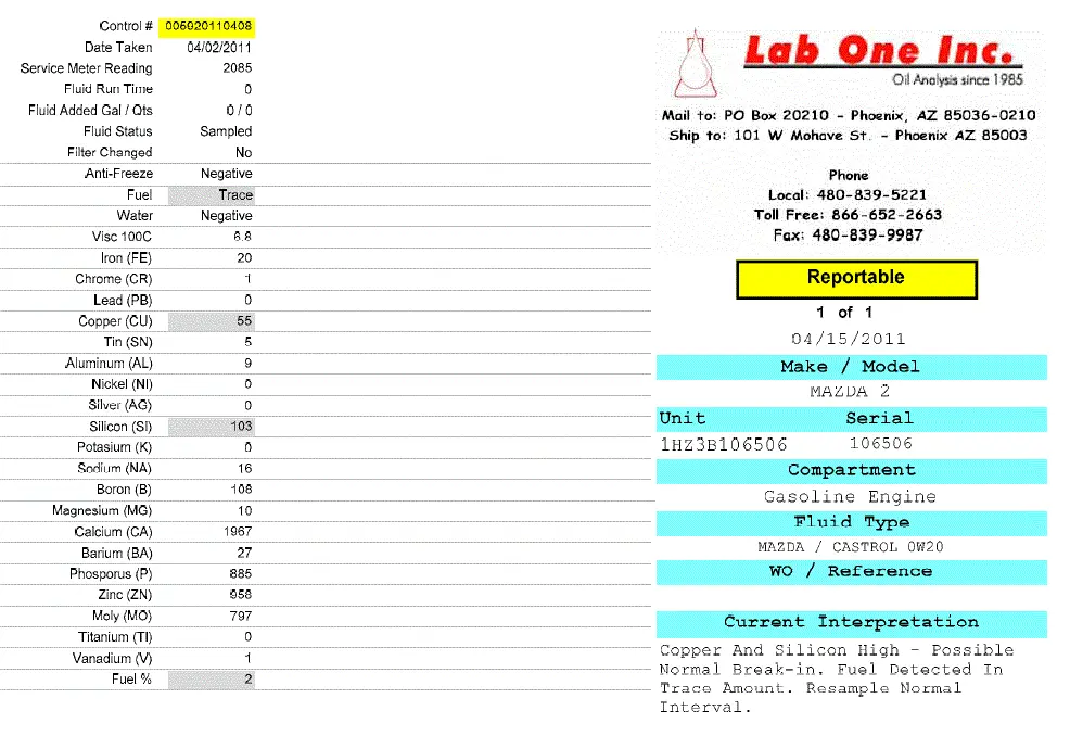

Oil Analysis Results at 2100 miles!

I guess I will replace oil at 2500 (currently at 2300) to get rid of those little buggers and then resample 2,000 miles later.
The Silicone is probably from casting sand, Copper from Cam bearings and Fuel from blow-by.
What do you think?

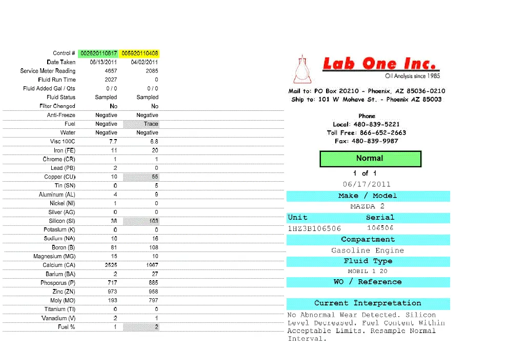

Changed oil after last sample and here is how we are looking:
This is just around 2,000 miles after oil change just like the first sample. About 4700 miles life to date on engine. I sample this way to have some machining time on the engine.

Yes ddawson, first sample analyzed was on OEM oil. I changed that oil out at ~2600 miles. Replaced it with Mobil 1 0W-20 as that is what my Mazda parts supplier had. I thought that Castrol may have supplied that oil, however my understanding is that ENEOS can also supply Mazda Japan with "brake-in" oil. The additive package in the break-in oil looked just fine, I was concerned with the larger wear metal suspended in the oil. Those particles are gone and my engine is free to make some more, however at a much reduced rate. I will resample in another 2K and if it looks fine, then at 6K on oil and change-out at 7,500 per schedule A or B, whichever is the milder duty cycle.

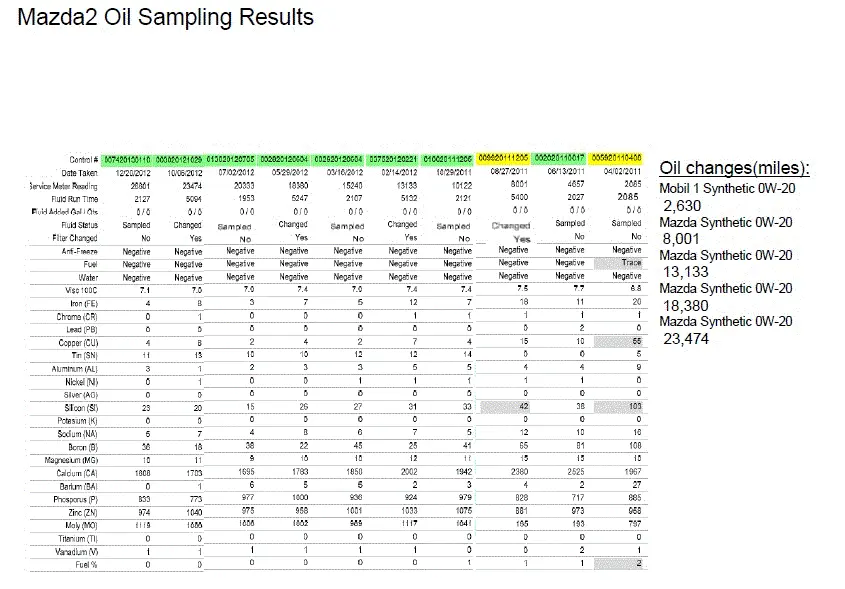

OIL Sample UPDATE !!! @ 26,000 miles
Not too shabby!

Let's see how the next 5 oil samples look like as the oil is changing to SN.
