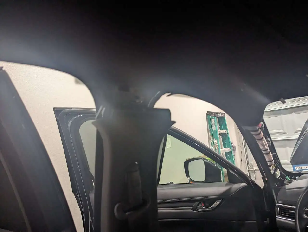

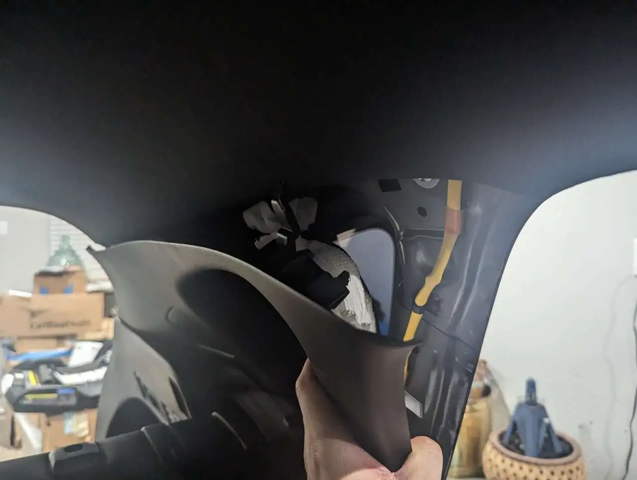

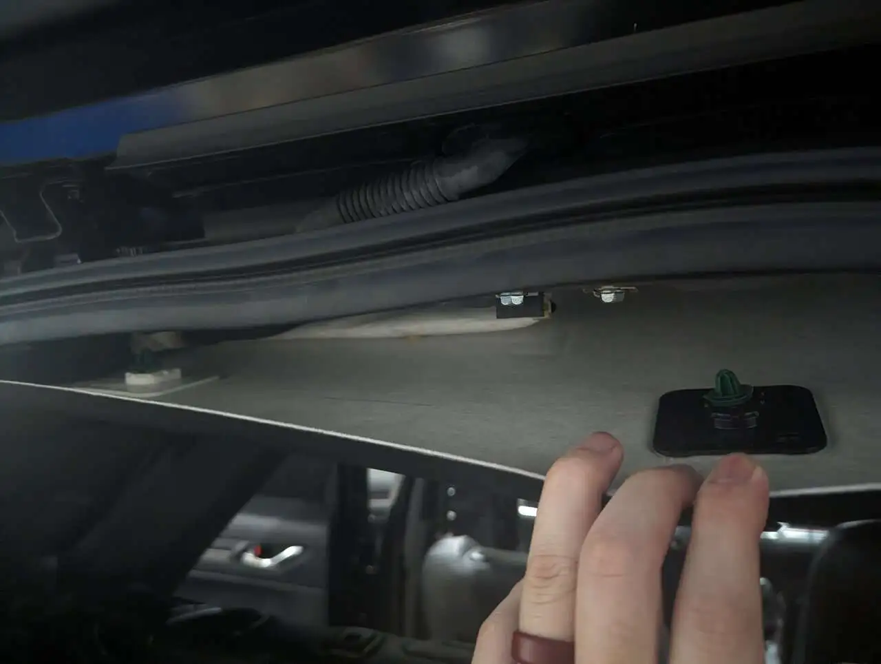

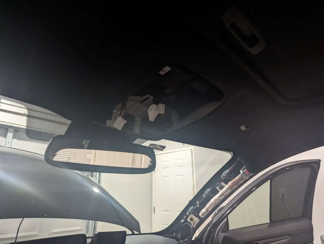

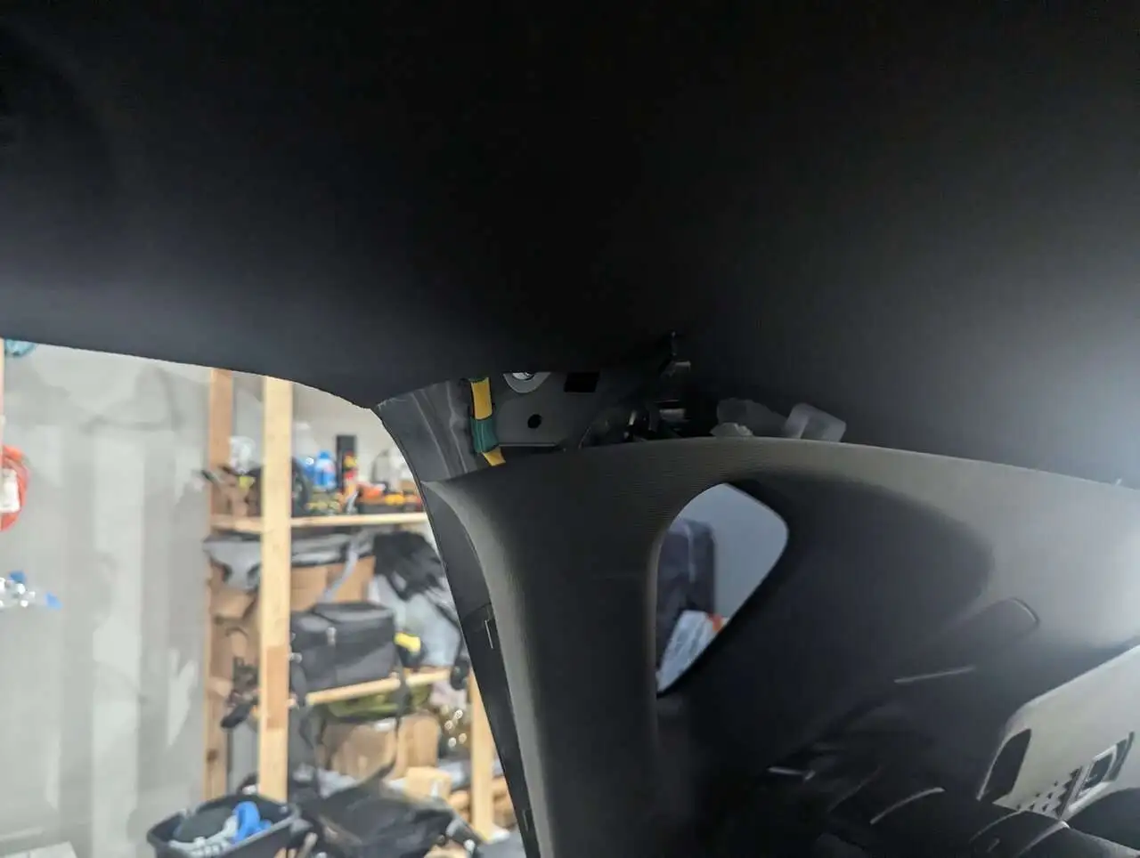

Currently trying to remove the headliner but I'm stuck. I've removed the A pillars, the front map light, both sun visors/ clips, loosened the B pillar, C pillar/cargo area, all the oh-s***-bars, and undid the three push clips in the very back.

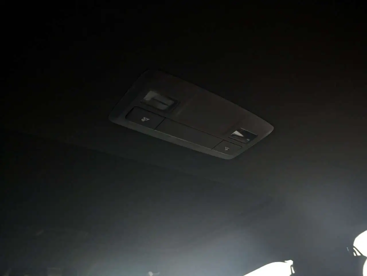

I know the dome light for the rear passengers is still there, but I'm at a loss as how to remove it. can't find even a picture of the style that have on google; it's the led style (2022 Turbo trim).
Does anyone know if have to pop one of the buttons out to reveal a screw or do just really need to pull harder on it to separate it from the headliner?
Also is this the last thing holding the headliner in?

Online I read the headliner has to come down, THEN the rear dome light assembly can be removed. Is this true? If you need the link I can get it. I assume by now you got this figured out?

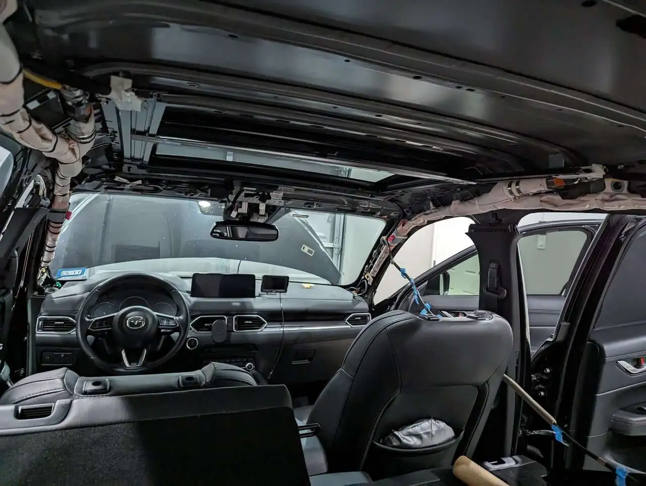

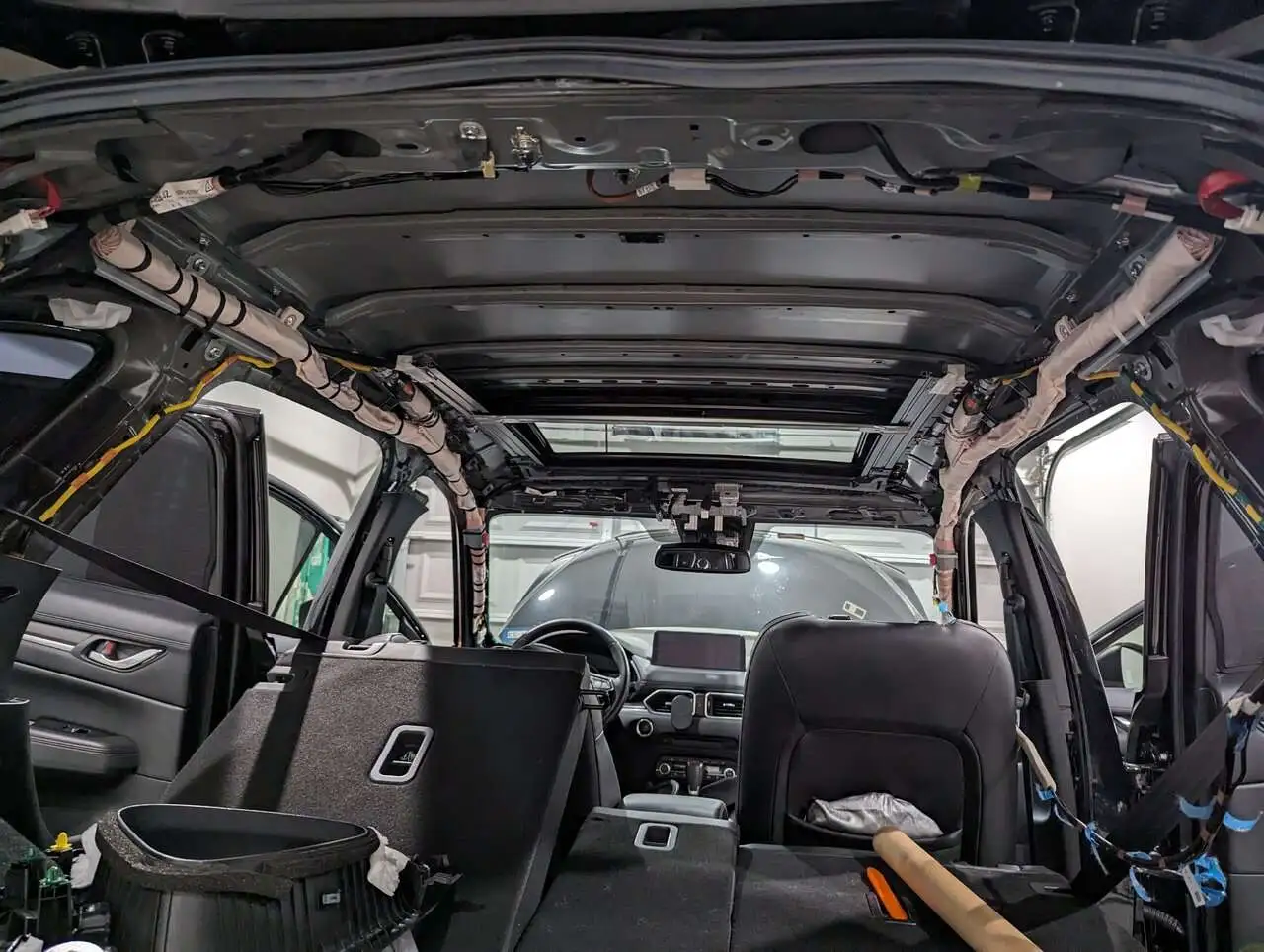

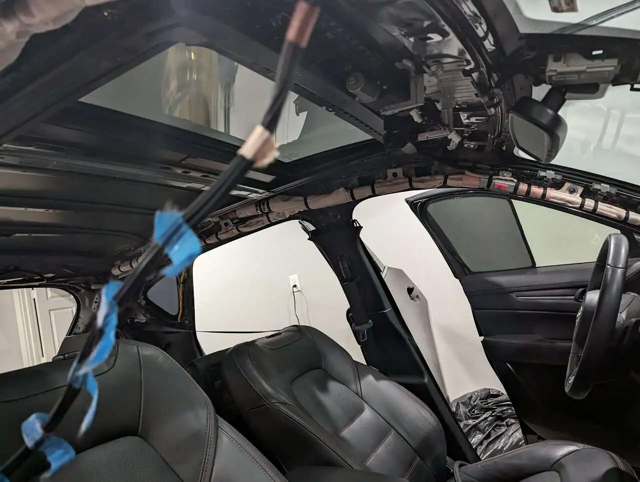

And if you did get it removed, do you have any pictures of the roof from the inside with no headliner?
I want to add a ham radio antenna mount on the roof and would like to see what I'm working with.

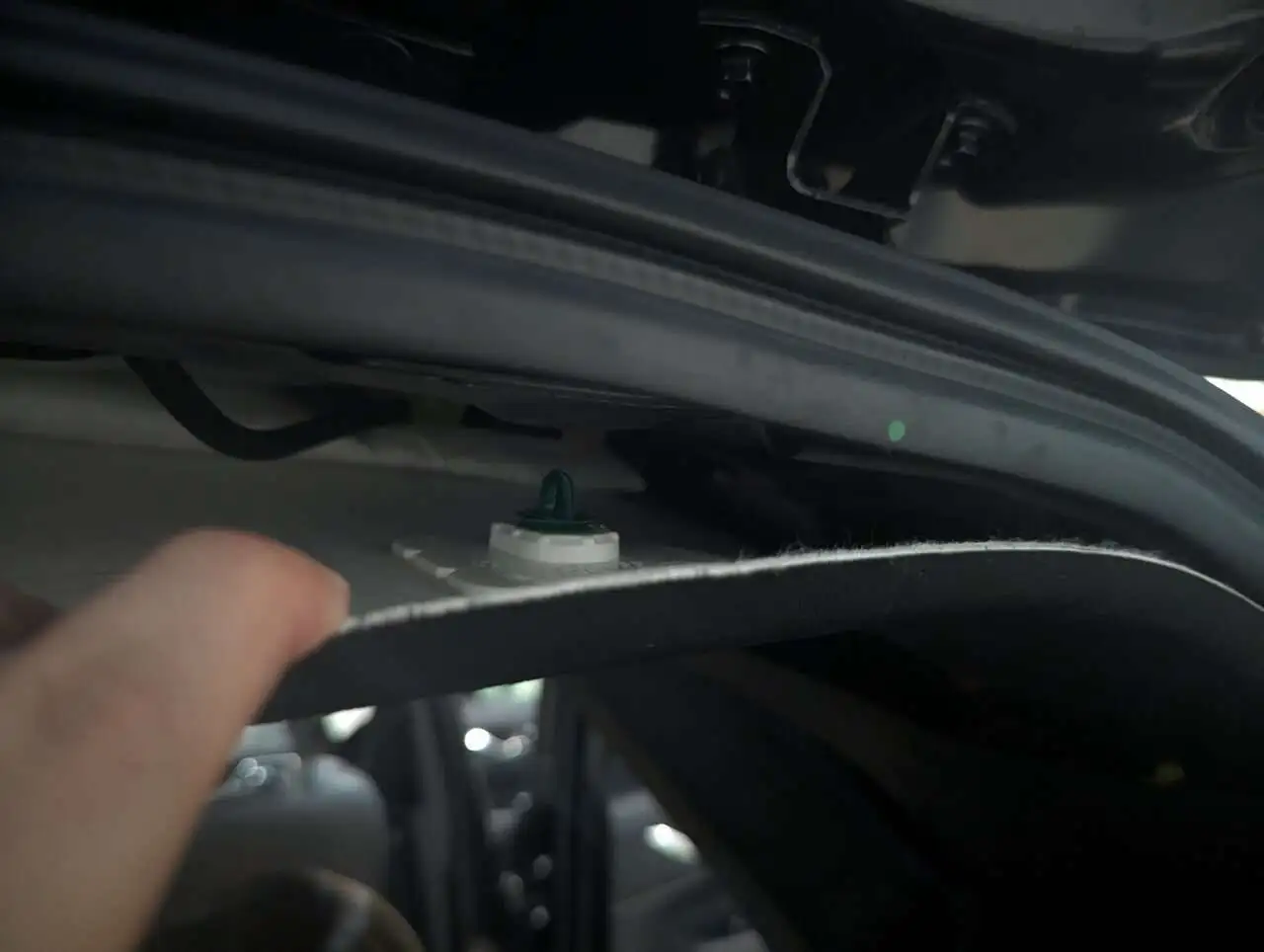

I did figure it out actually; the gasket around the sunroof needed to be pulled away and the headliner was finally able to drop out.
I took the headliner out to do a starlight headliner install. Came out really well but a little disappointed in the way the headliner looks during the day. Still need to clean it up a bit.
I have photos of the bare roof but funny enough, none of the starlight headliner.

Thank you so much for the pics. That helps but still a little hard to tell exactly where cross members are and aren't etc.
There is a type of antenna mount I can do all from the outside but it needs to be a single ply place. I can't hit a crossmember or anything, so just trying to figure out what's under there so I drill the right place.
Any other pics?
It's not 2 ply or anything is it? It's only 1 piece of metal thick as long as I avoid the cross members? Or does the sunroof go into a "pocket" with a roof above and below it?
I'm drilling right above the rear dome light from the outside, just want to be sure, other than a cross member, it's not 2 pieces thick or a false roof below where the sunroof goes or anything
