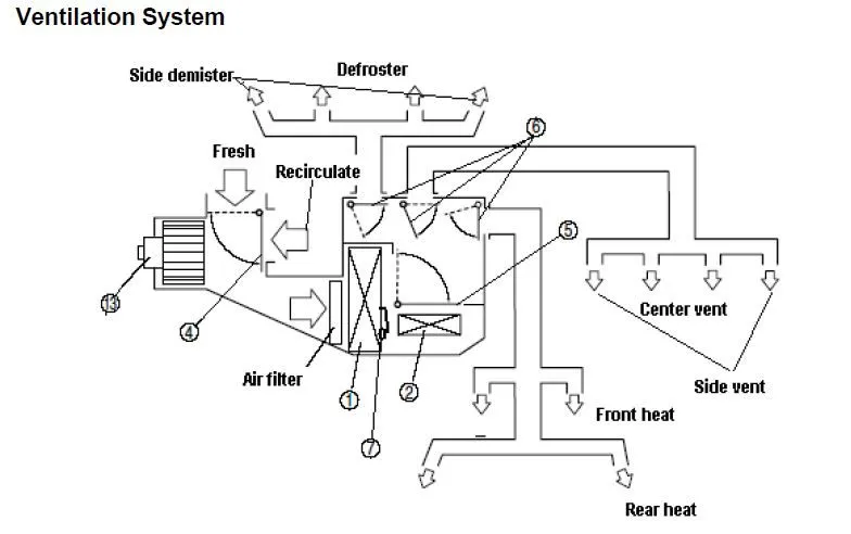

So here's a question. I have the full auto climate control with the rear vents. If I think I'm getting the weird dusty smell from the front vents on the dash, will spraying it on the evaporator help since the evaporator is down below and the air that passes over the cabin air filter and then the evaporator seems to only push out through the rear AC?
And after some Googling I found this: http://www.mazdabg.com/ftp-uploads/MAZDA material for technician/TC070-15-01H.pdf
Specifically this (from 2005)
