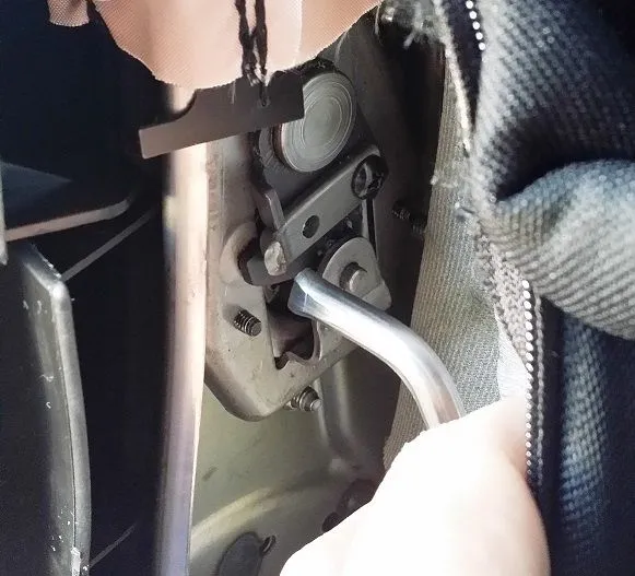

I have herniated disk, at my lower back and I'm fine with the factory one. The problem is, that it is broken and it won't extend at all. It is all the way in.

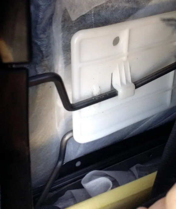

After opening the back of the seat, this is what I have found:
Our lumbar support:
attachment.php
Broken off shaft, from that lever.
attachment.php
