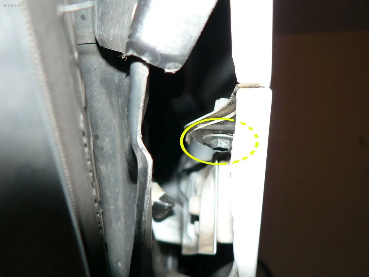

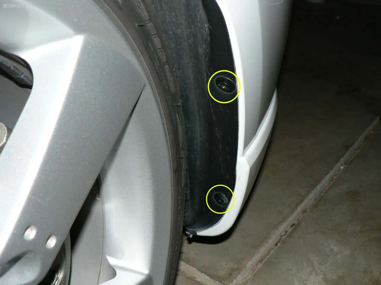

Alright, finally some pics. After seeing the damage, any more suggestions how to get the middle clip to fasten to the bumper? I got replacements from a body guy I treated. The guy has been doing body work over 20 years and has bins of parts for cars. So I have the clips to fill the holes, bottom one is good to go, but I don't think the middle will hold. The top one is cracked (with the 10 mm screw, but holds).

The middle one is the second picture?
What I would do is lace a couple of strands of safety wire past that gap and tighen it down with safety wire pliers. But, since you probably don't have that stuff lying around, what about using glue to hold the base of the clip in? Or, you could use a nut and bolt with a big washer.
