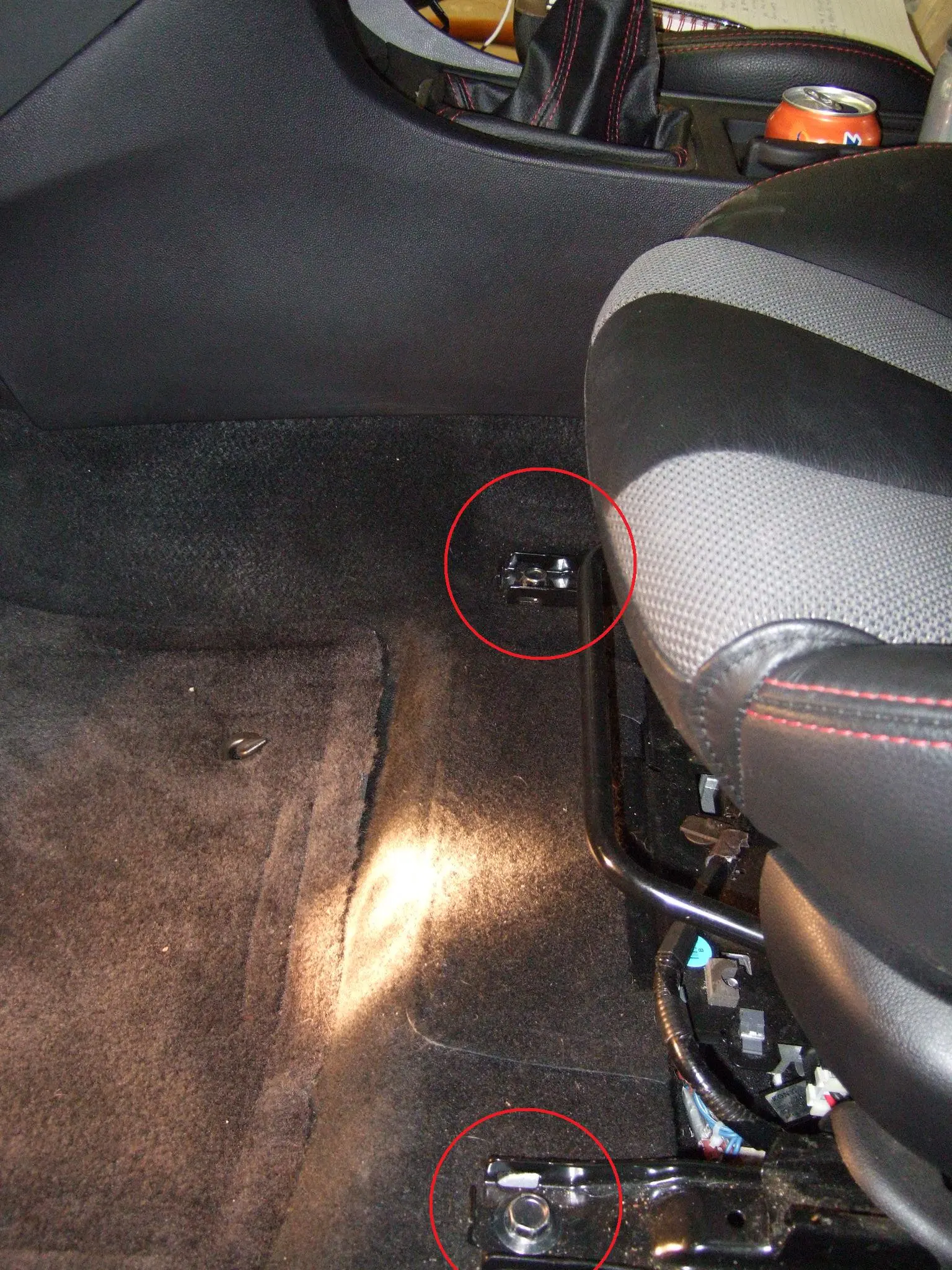

(1) Locate the 4 trim pieces over the bolts connected to the seat rails. Remove those trim pieces.
  • Be careful taking the trim pieces off as they are delicate and will easily break. I ended up not putting them back on and just put them in a safe place until I need/want to put them on.

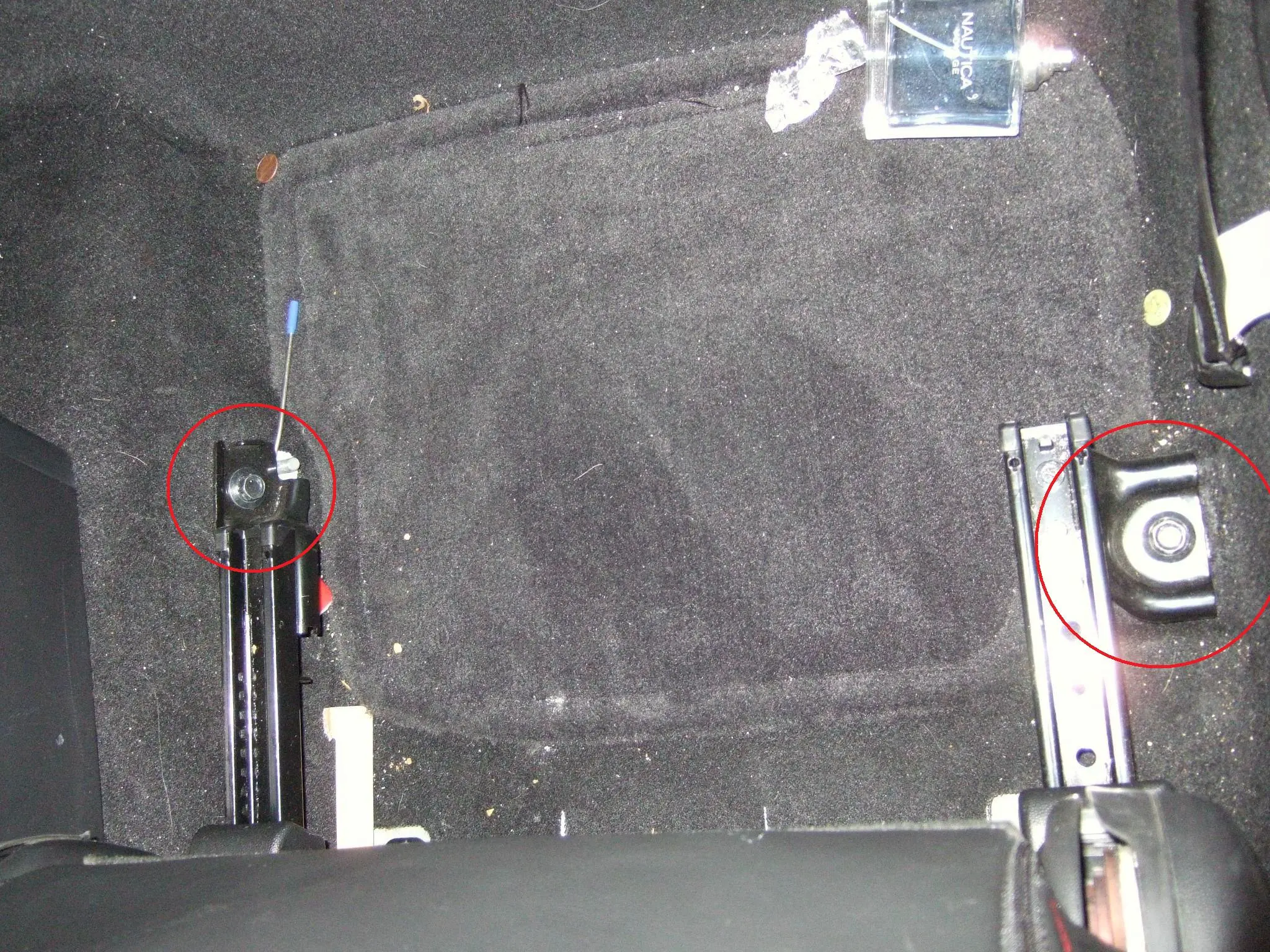

(2) Slide the seat all the way back & use the 14 mm socket to remove the bolts. Slide the seat all the way forward and repeat the process for the 2 rear bolts.
  • TIP: use the socket wrench to torque loose the bolts and then use a power drill with a 3/8 socket drill bit to remove the bolts quickly

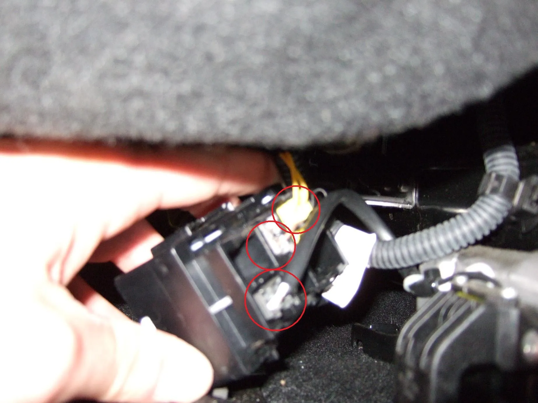

(3) Use the precision screwdriver to disengage the delicate locking tabs on the 3 sets of wires going into the wire harness underneath the driver side seat
  • You will need to use extreme care and be relatively agile to easily remove these clips without snapping the locking tabs or getting very frustrated...I did both (chair)
  • TIP: mark the 3 sets of wires to easily identify where they go when putting everything back together

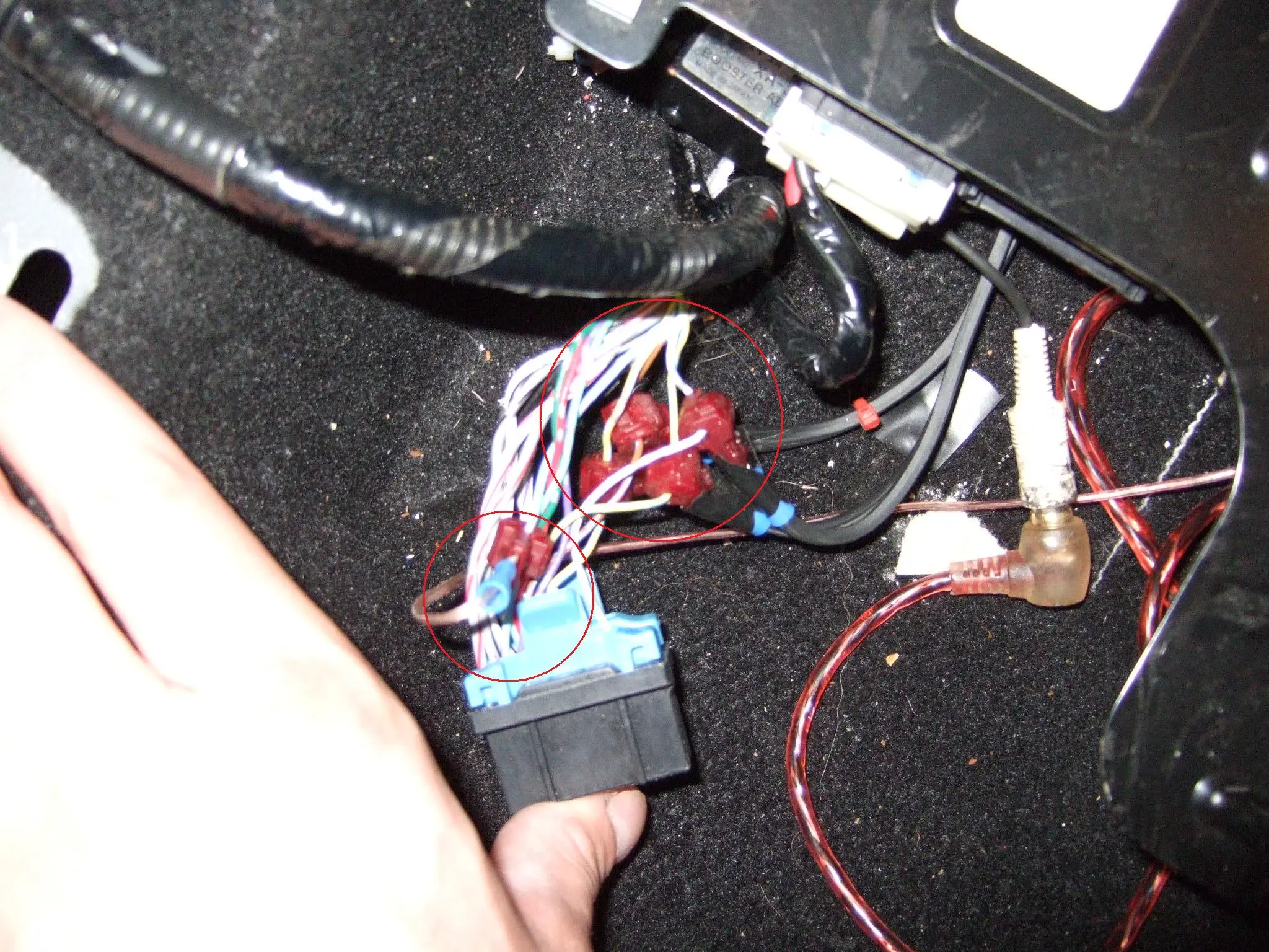

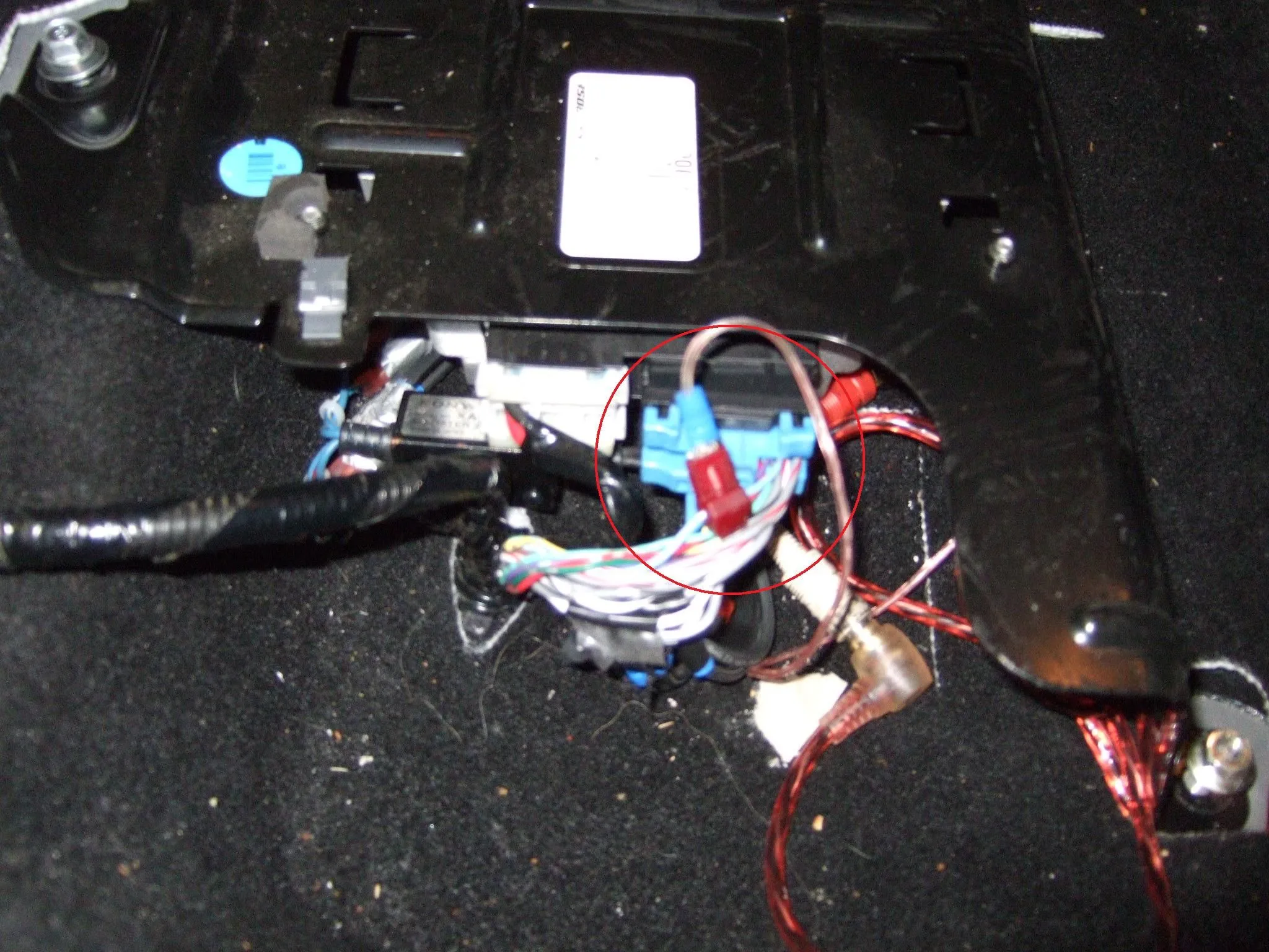

(5) On the BOSE amp there are two wire harnesses connected...the one we are working with is on the right. Remove the harness by pressing the tabs on the upper and lower part of the harness and wiggle it out. There should be electrical tape wrapped around the wires we need to work with so very carefully unwrap the tape about 2"-3" to expose the wires. Do this very carefully
(6) For this next step you will need 5 quick splice female quick connect doohickes (yes, that is a technical term...jk). This is the best way to not completely cut the factory wires and still get the job done while looking professional. You will need to splice the following wires in order to connect the RCA adapter...
L-: yellow/lt blue stripe R-: white/light blue stripe
L+: brown/light blue stripe R+: yellow/green stripe
remote: practically solid light blue

the wires I splice are before the factory bose amp...my reasoning (although it's not confirmed, just my assumption) the frequencies are "more pure" coming straight from the headunit before getting cut/slashed/messed up by the factory Bose amp...just gives more bass control & better frequency to the aftermarket amp/sub while still preserving the factory Bose speakers quality.
