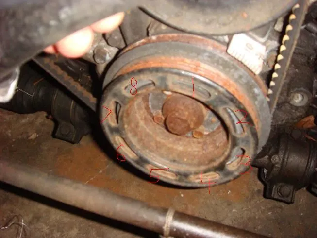

if the engine was replaced, you need to double check what they replaced it with. Look at the crank pully. If it has 8 slots in it, like below, then you have a long crank nose engine from a 91.5-93. if it has 4 slots in it, then you have the short nose crank from a 90-91.5. It's important to know which when you order your timing belt/front seal/etc.
Thank you for that info! I will definitely check for that. It's going to get a timing belt change (& everything that goes with it), oil change, & tranny fluid change right off the bat.
