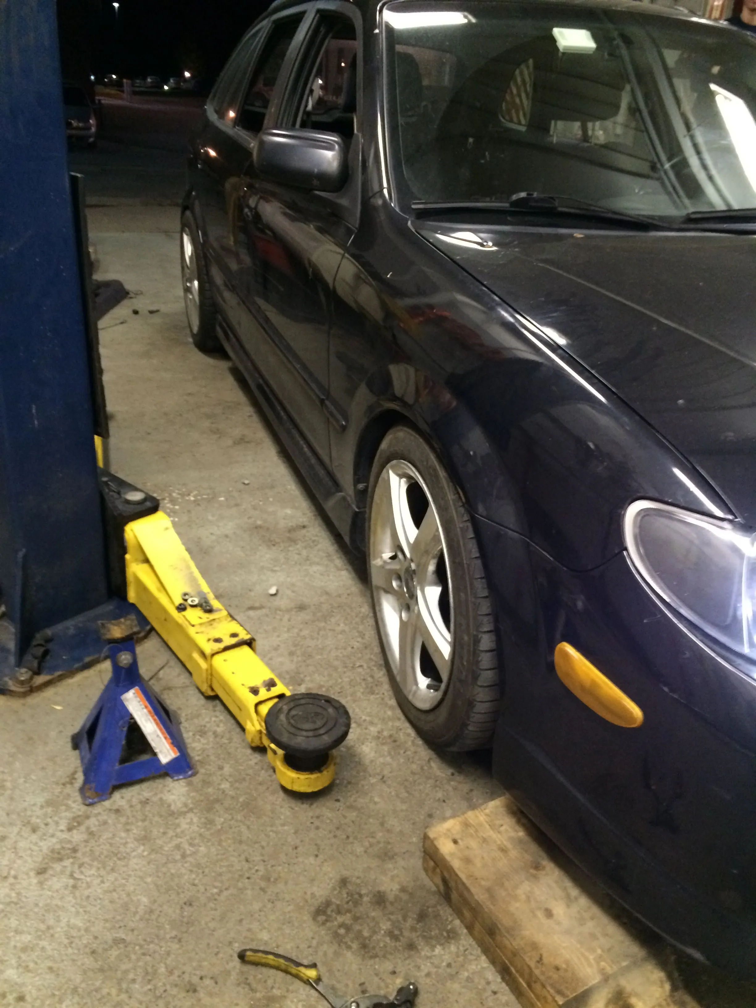

I finally did it and got coilovers. Lowered my car by about 1" all around and added a progress rear sway bar to boot! I have energy suspension adjustable endlinks in the rear, but I don't have a solution for my front endlinks. What have other lowered people used for endlinks? I found these energy suspension adjustables on amazon.
https://www.amazon.com (commissions earned)
Here's a photo of my car with the coilovers super low. I brought them up 1" from this.
