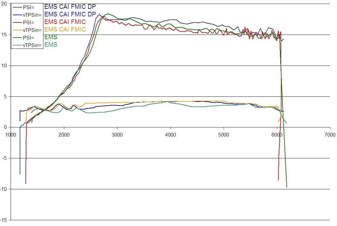

I mentioned that I thought the boost was spooling faster with the DP to Jordan and he suggested that I overlay the boost/rpm curves to see. Voila! THere is definitely an increase in the rate of the spool up. I'm comparing EMS only, EMS+CAI+FMIC and EMS+CAI+FMIC+DP.
After looking at this it seems you get full boost 2-300 rpms earlier but it also holds a higher pressure at the later rpms. I love data...
