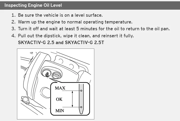

Halfway between Min and Max is the correct level. More than max is overfull. Less than min is underfilled. Anywhere in between is acceptable operating range.
If you expect to consume oil, it makes sense to put it above the mid mark, but Max is the limit, not the target.
Gotta love contradictory statements.
"The level is normal if it is between the MIN and MAX marks."
"If it is near or below MIN, add enough oil to bring the level to MAX."

The same on engine oil. Every vehicle when it specifies oil capacity, it always means to the Full mark of the dipstick. But Mazda’s 4.8 quarts on 2.5L NA、and 5.1 quarts on 2.5T, can only reach a half way in between Full and Add marks of the dipstick. Unconventional ⋯ :unsure:
Those are not necessarily contradictory.
If you fill it to max and it gradually is consumed, and you top it off when it gets near min, its condition most of the time will be between the Min and the Max and its average level will be near that midpoint.
If it were filled to the midpoint, and worked its way down near the min, it is losing or consuming oil. It makes sense to buy some buffer by filling as much as is safe.
If it isn't using or losing oil, there is little benefit to having more than the midpoint.
Overfull can be harmful. Anywhere in that range is fine and surely there is some margin on both ends for instantaneous condition.

I think they are. Take the logic of both statements into account. By telling the customer to fill to the MAX, they are saying "the level is not normal" if it is below MAX. Which contradicts the previous statement which says "normal" = "between the MIN and MAX marks".

The manual says "If it is near or below MIN, add enough oil to bring the level to MAX.", but it also says "The level is normal if it is between the MIN and MAX marks.“ So when oil level dropped near the MIN, it’s still within the NORMAL range, why would you want to add oil? And add enough oil to the MAX, not to any level in between?
It’s all about better safety margin. Keep the oil level at the MAX level protects the engine better when any accident of oil leak happens. I myself had an incident that the free Toyota new car maintenance oil change done on my 2018 Toyota Yaris iA and overfilled at least 0.5 quart as usual. I then drove 400 miles from San Jose to LA, only found the oil level didn’t register any on the dipstick the next morning. Turned out the Toyota tech “damaged” the drain plug gasket during the oil change and the oil was leaking out. If the tech didn’t overfill the oil with much bigger safety margin, my Yaris could have a damaged engine and got stranded somewhere on the I-5.
