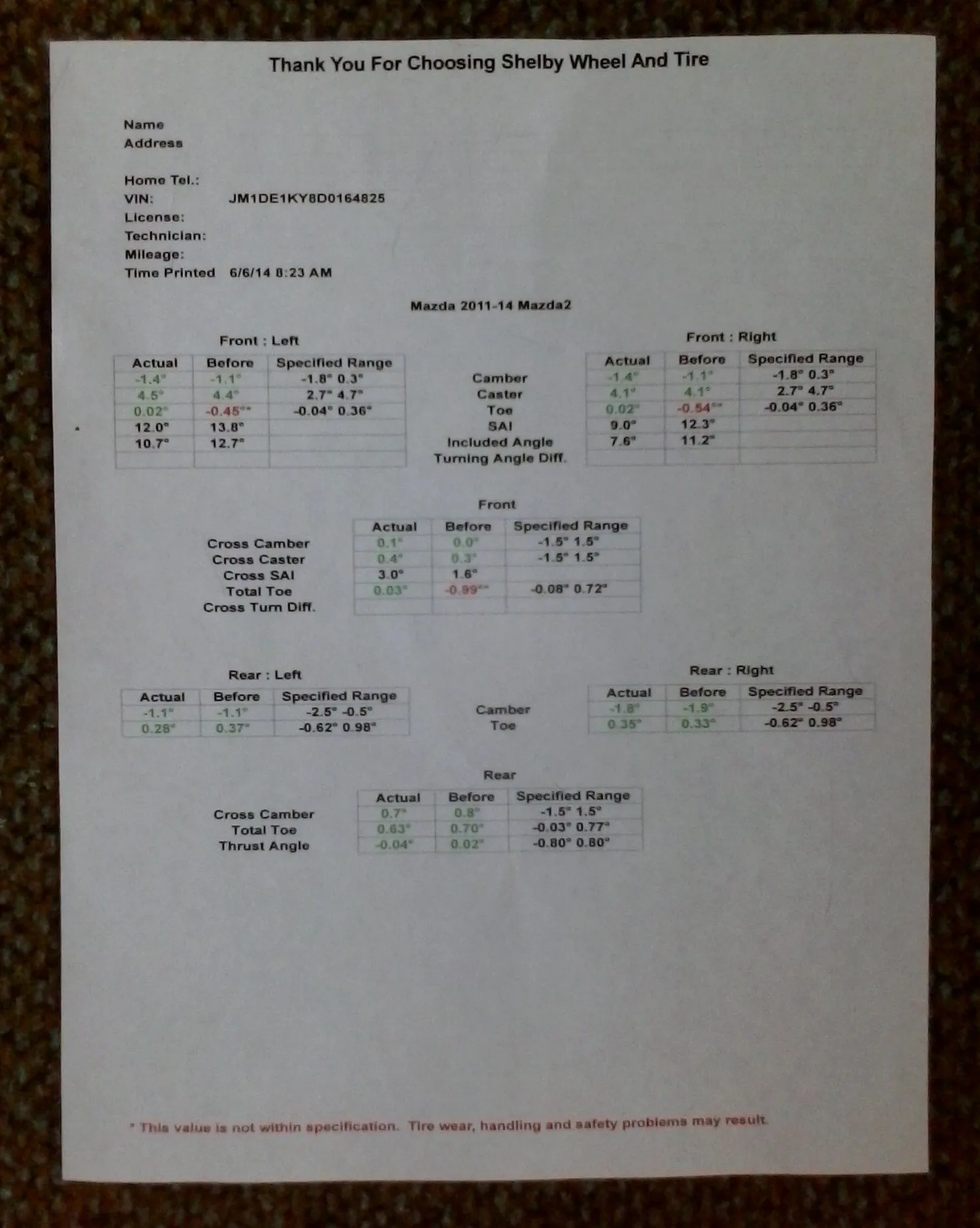

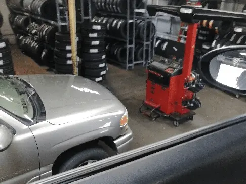

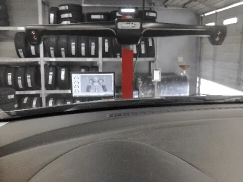

1. Riding high on the Hunter alignment rack.
2. Looking down on an SUV.
3. I ended up with an even -1.4 degree front camber and .02 degree of toe on H&R springs and CorkSport adjustable struts without resorting to camber bolts. This is with me sitting in the driver's seat and 1/4 tank of fuel in the tank.

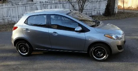

Nice man! Glad to see they look good with bare steelies (at least to me).
Yes, I do.
I modified some Mr. Gasket #2486 dust caps with a dremel and a hammer, then I pounded them into the hubs with a rubber mallet. I haven't reinstalled the center caps after upgrading the suspension because I'm planning on pulling the wheels off again soon to spray them body color...at least, that's my hope.

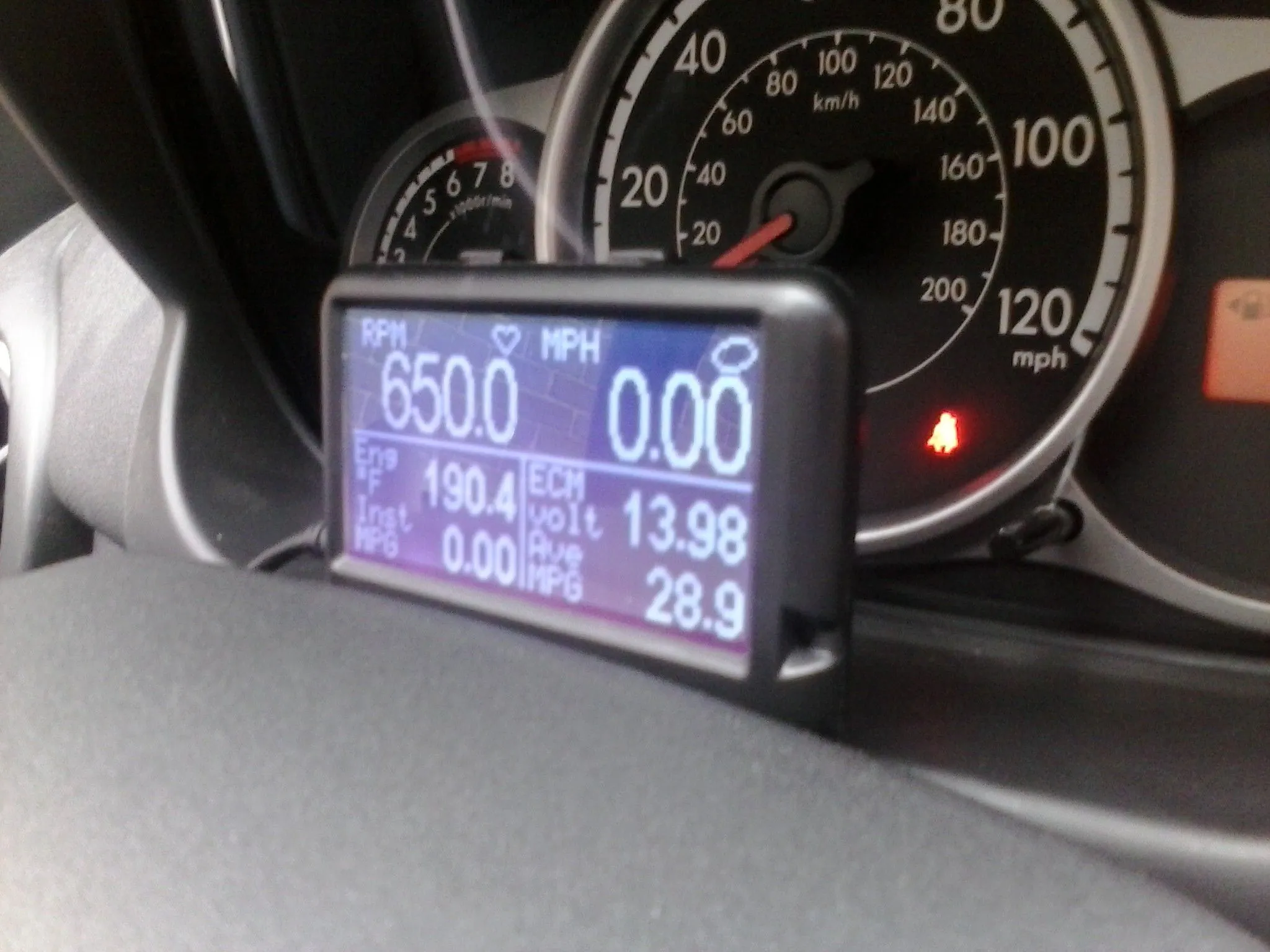

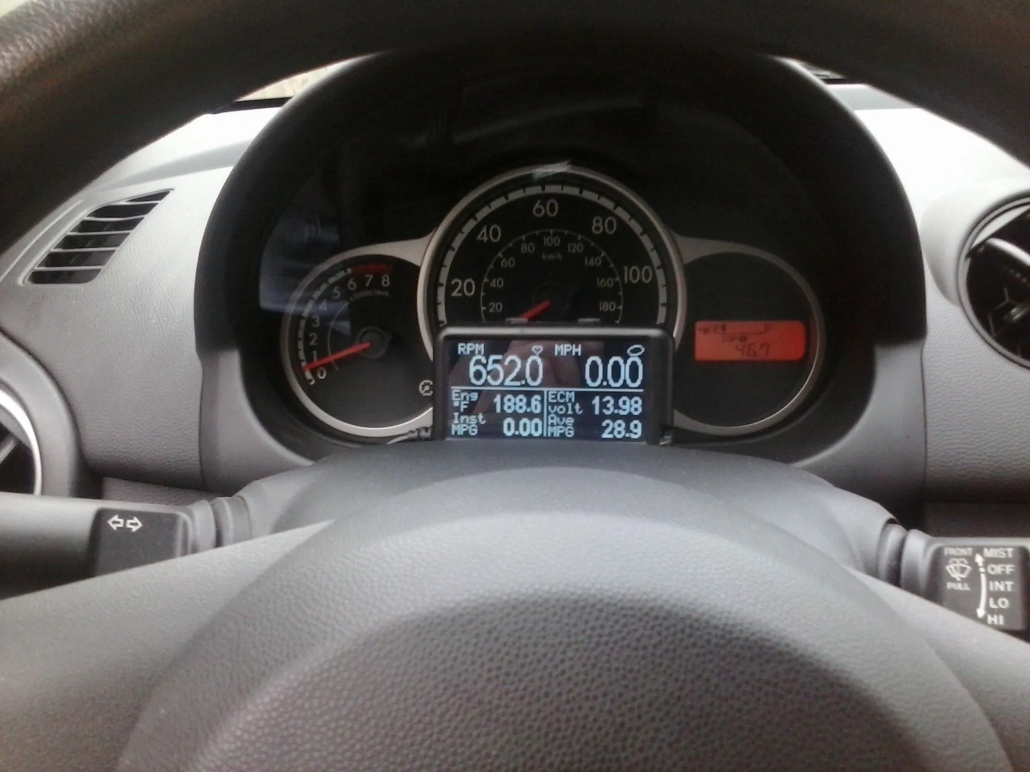

Which ultragauge do you have, and what do you think about it? I just discovered them and I am very interested in getting one now.
I have the Ultragauge EM Plus: http://ultra-gauge.com/ZC/index.php?main_page=product_info&cPath=1&products_id=56

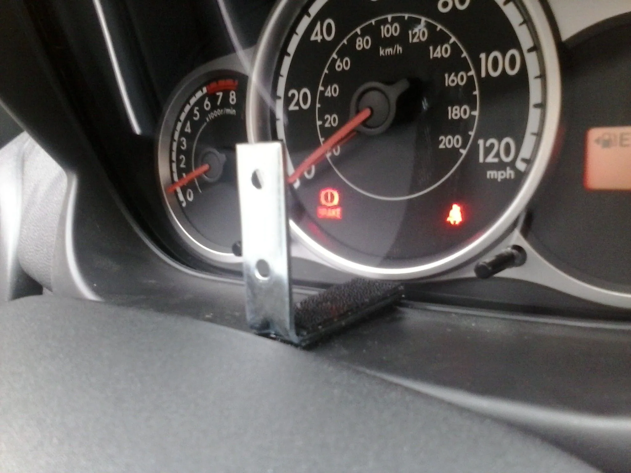

I am satisfied with it given the price. I have it mounted on top of my steering column between the tach and speedo. It obscures the warning lights, but I am pretty diligent about checking those every time I start the car. Also, the Ultragauge has customizable audible alarms for most readouts, anyway. I'll take some photos of how it looks in my car soon. Eventually, I expect I'll change the readout to "red" so that it matches the rest of the car. For the time being, it does what I want it to do.
Here's how I've chosen to mount the Ultragauge. It's just a bracket and some Velcro, so it's easily removable. The wire tucks away, so nothing is hanging out under the steering column or in the floorboard. As I mentioned, eventually I hope to change the display to red. I've already tried photographic gel sheets, but the color doesn't stay consistent in different lighting and it really dims the display more than I'd like. I expect I'll have to change the LEDs at some point if I am motivated to change the display to red properly.
