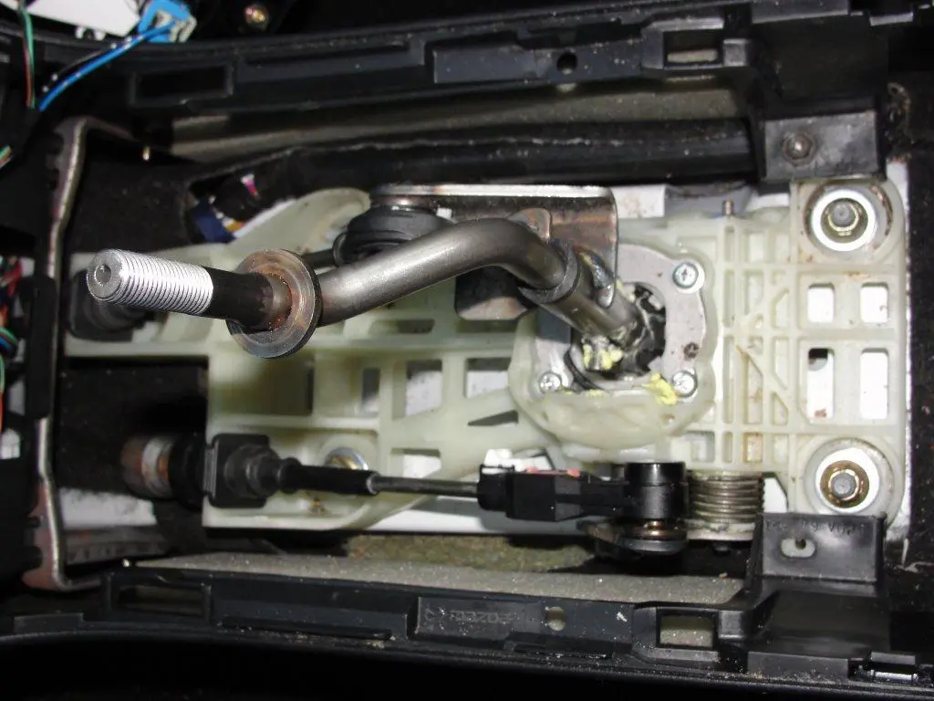

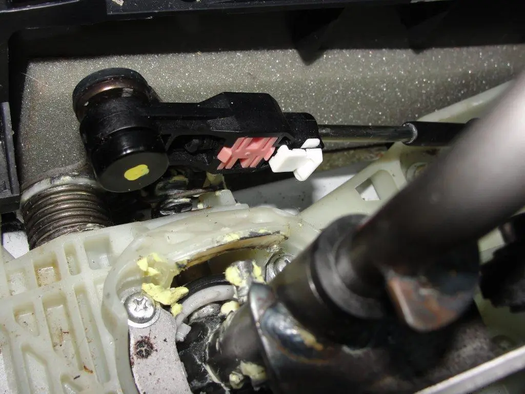

There is a video on youtube on how to adjust your shifter for a speed3, but the speed6 looks different. After installing jbarone ssp I have a really difficult time shifting hard into 2nd gear (racing) casual driving doesnt have a problem but 50% of the time it just doesnt feel right.
I didnt want to break anything so ive been cautious not to get to creative with it. Here is what im looking at.
I have moved the white clip, but i really cant see how it does anything at all. The pinkish clip I would think is what if anything would make a difference. Underneath the pink clip is a spring...
If anyone has adjusted this piece let me know what you did. Its quite simple to get at.

email Jamie, he'll answer and set you straight real quick. I think you just pull/push the pink clip also, but he'll tell you for sure.
After you pull that white clip to the side, the pink plastic clip needs to push outword out of the black housing towards the shifter.
this will allow the linkage to slide foward and back.
**WARNING: before making that step, take a sharpy and mark on the metal linkage rod where the stock positioning is.**
This way if you over adjust, you can always go back to where you started.
Make very VERY minor adjustments, this will help line up with shift gates depending on what kind of bias your shifter currently has.
a weighted shift knob will also help your aggressive shifts.
i will be doing that soon. as far as gate alignment, mine are pretty damn good now.
Thanks a bunch for the post! Jamie did get back with me very quickly but he couldnt remember on the speed 6. he thought if i took the white clip off it would do it, but i was pretty sure the pink one had more to do with it.
im going to go adjust it now.
Yay! no more grinding, thanks a ton batou79! I didnt use a sharpie, i just did some trial and error until it felt right. I took it for a drive all my gears work good and did some flat foot shifts into 2nd and 3rd and no more grinding!
