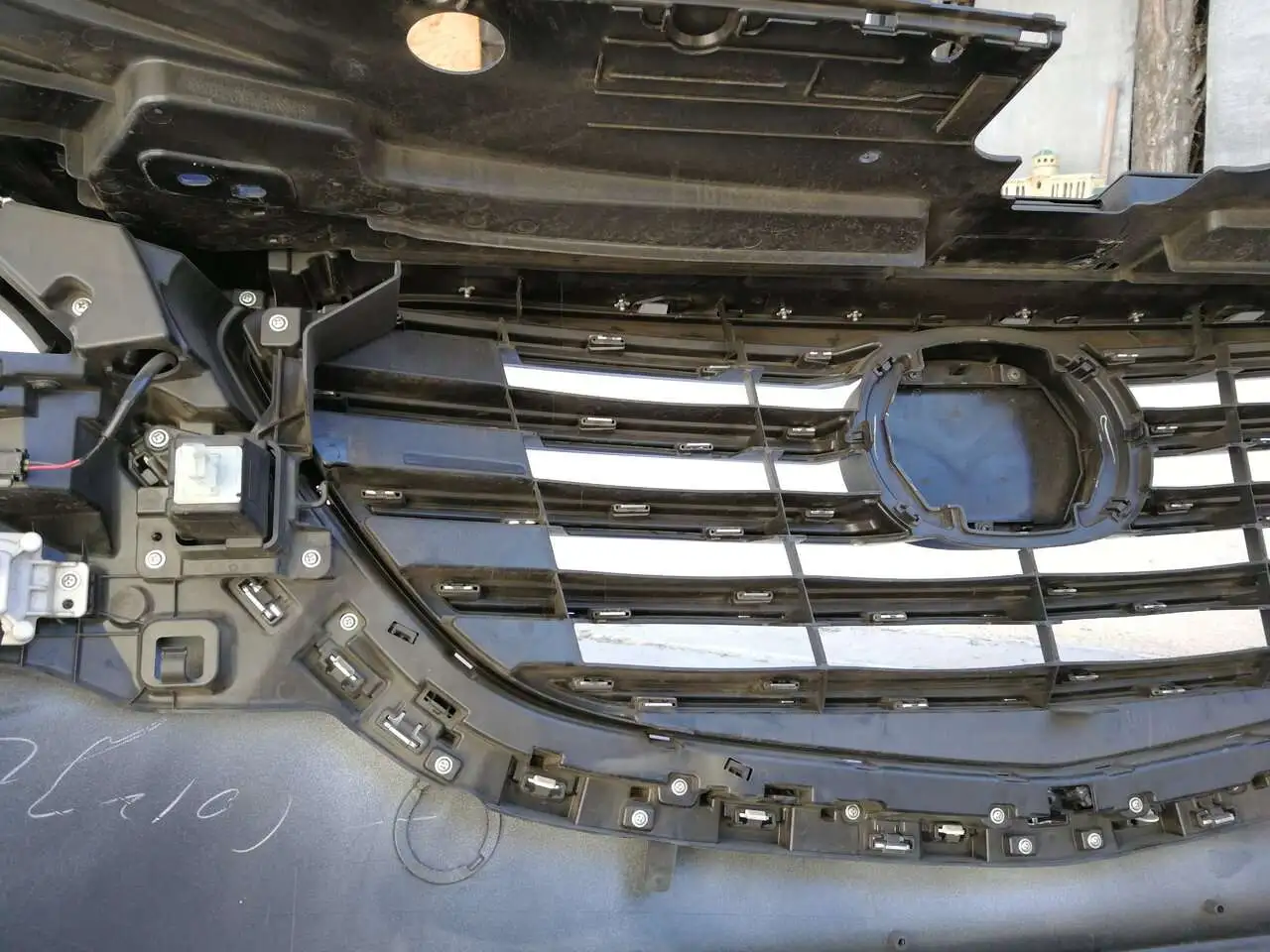

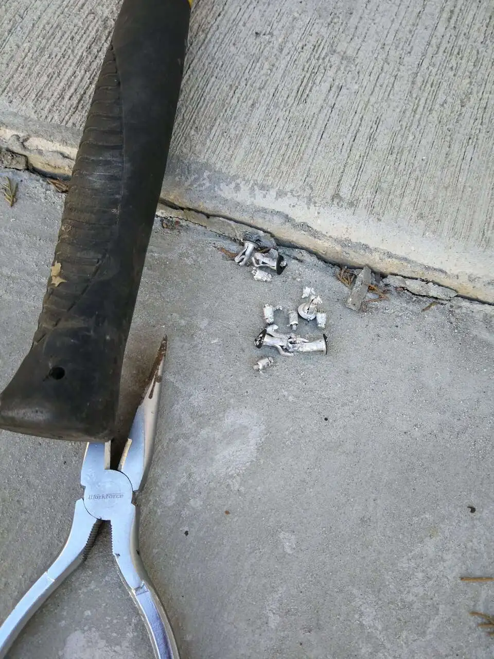

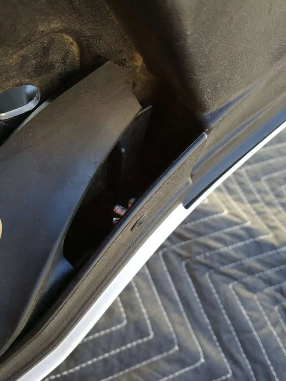

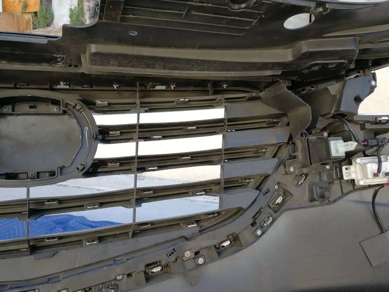

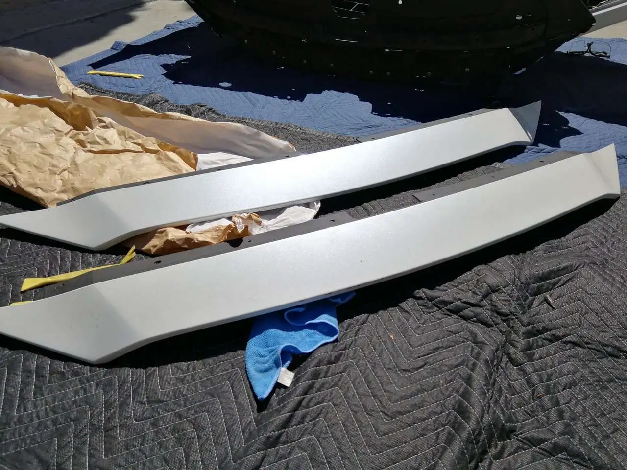

Hardest part was removing the rivets. I used pliers to wiggle and break them off. You don't need to remove the bumper. I removed it to locate the rivets but you can find them in my pictures

Thanks for the pictures. Was the whole upper grille part riveted? I am thinking maybe I can drill them out and then just replace with new rivets. Anything I should watch out for if I do drill them out?
Chiming in with a necro bump. Those rivets are part number BN8F-50-355 I believe. I am going to remove my grille to paint it and don't see a reason to remove the whole bumper. Saw this thread which helped me confirm there's a way! Just waiting on the rivets to arrive and some good weather.
