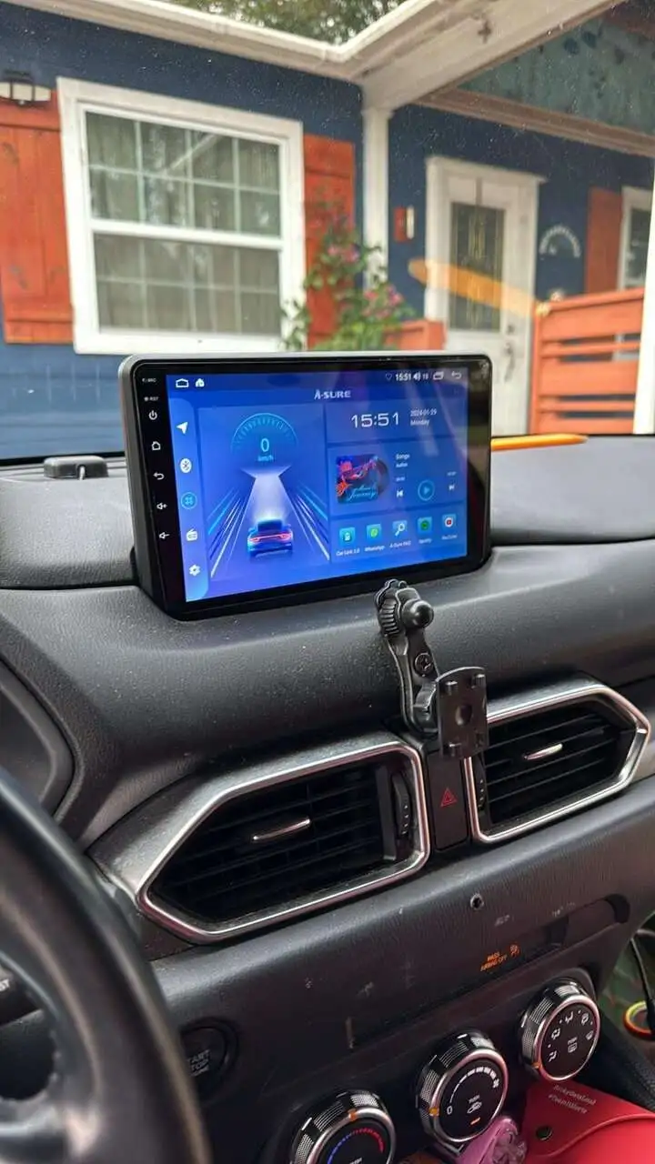

2018 CX-5 Android head unit installed
Finally found one cheap enough to see how it worked (about $200 USD).

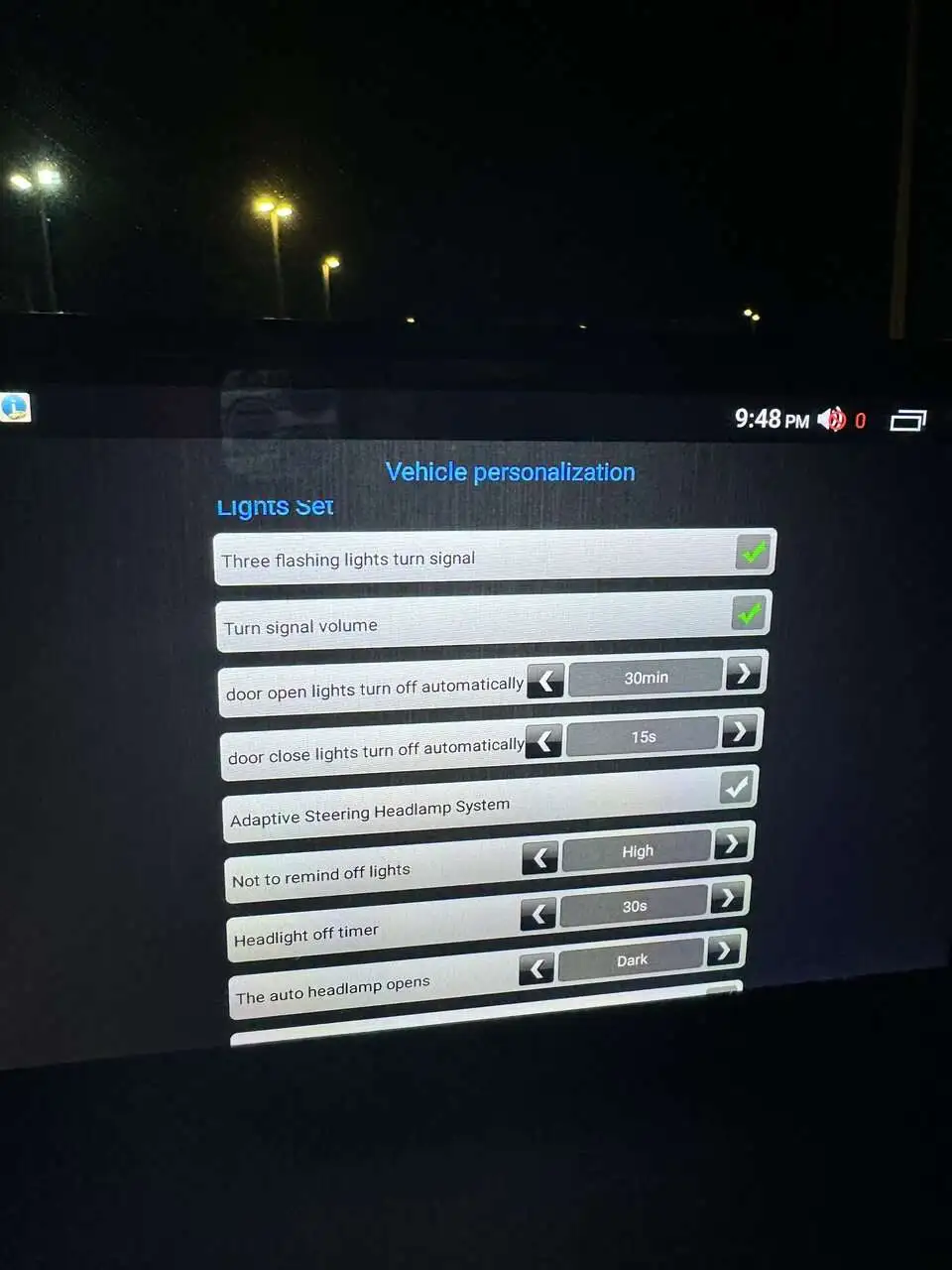

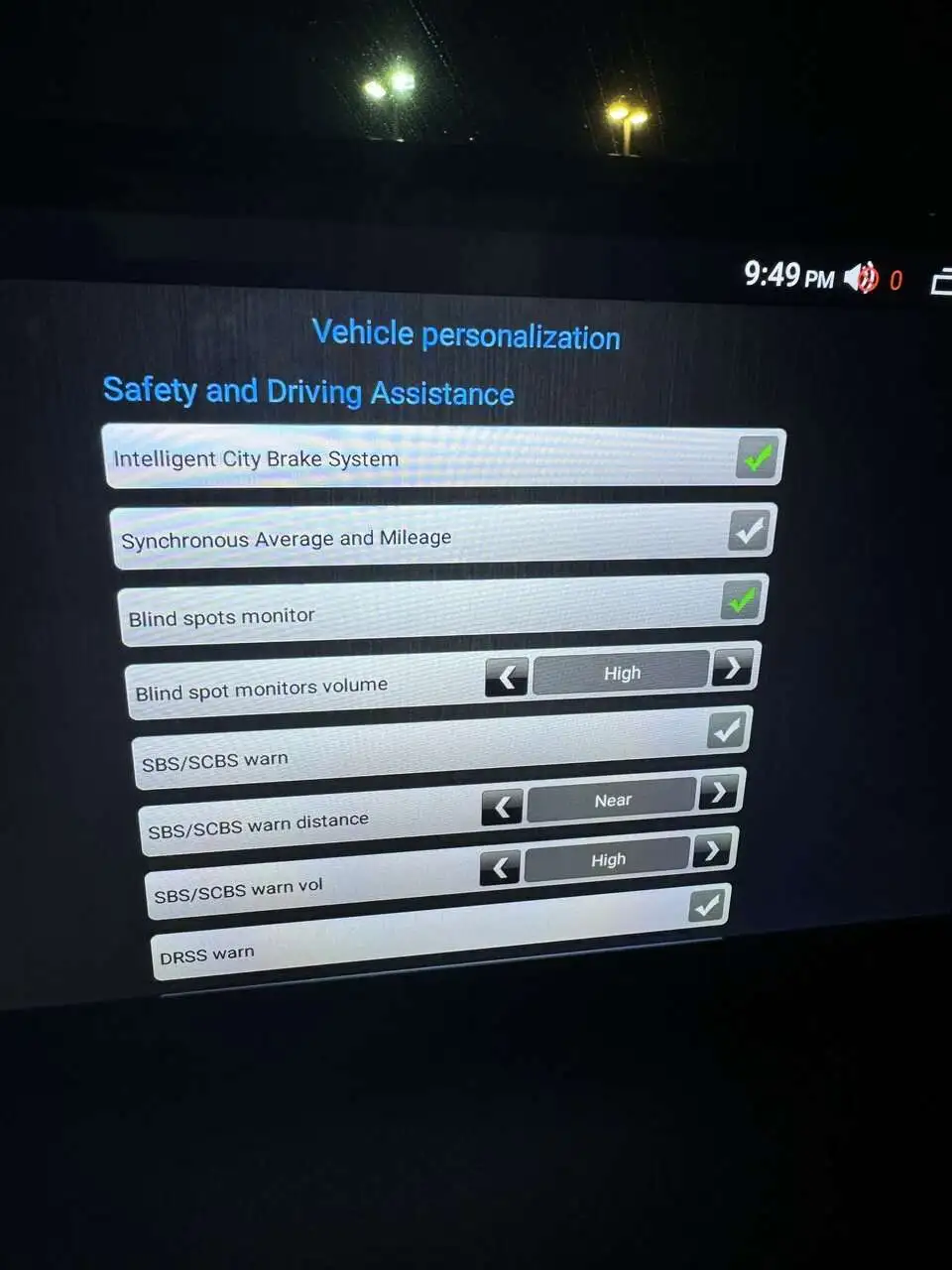

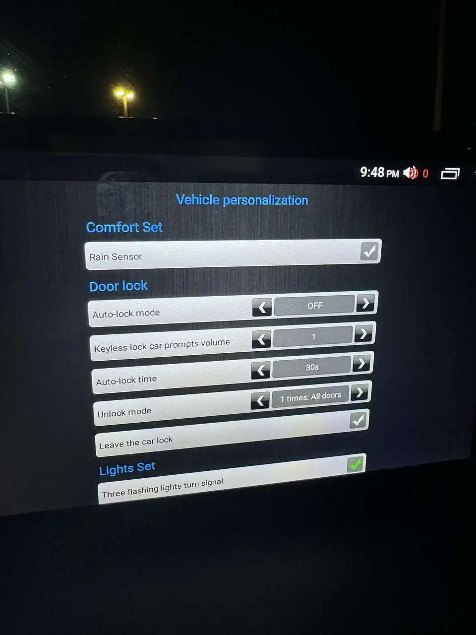

UPDATE! I have gotten everything working. All steering wheel controls work, center knob area works, I found how to access all the stock settings for lights/smart braking/etc. the only thing rendered unusable was the USBs/SD in the center console area (but the head unit has two usb of its own).
Some things to note:
1. Aftermarket backup cam is required. I got one of the ones that mount to your license plate frame and it isn’t perfect but does the job.
2. Instructions are almost <none>. There is a crude wiring diagram, which I was able to get figured out. Someone less tech savvy might not have had such luck. There is no cutting of stock harness required.
3. The two USB and SD card reader in the center console no longer will work. There may be a way to get these working, but I haven’t torn down the console yet to find out (I will).

So update. Canbus is finally programmed correctly. All steering wheel and console buttons work. I can also go to “OBD Settings” and change all the original stock items like door locks and lane assist, though they won’t work for me anyways as I removed all of the stuff that was mounted to the window such as forward facing camera). The only things I am missing from stock are the USB/SD Card Reader is now powerless, but new head unit has two USBs. Better in my opinion, is that now it displays codes instead of just a generic “charging system malfunction” for instance (I have a few codes due to removing all the SCBS stuff from the windshield as well as my higher charging voltage and PCM bypass on my high output alternator)

So I figured everything out yesterday. You can change the car settings still and all buttons and knobs from steering wheel plus center knob area all work!

Install was relatively simple, tear down the same way you would (minus the console part) for the CarPlay upgrade. Once you have the stock head unit/screen removed; there is a plastic bracket attached to the front by two screws that you remove and put on the new head unit. The “Power Plug” has if I remember right 13 plugs on it and a ton of wire. The only ones that are used are the 4 closest to the main power plug. Two are used to clip into each side of the can bus adapter, and two clip onto the stock plugs in the dash. The two small plugs from stock unit that go to the center console usbs get left unhooked (one plug if you didn’t have CarPlay). The antenna from the new unit didn’t fit the stock plug, but can be cut and spliced on to the adapter if needed (I didn’t, and radio still gets perfectly fine reception). There are three plugs for USB ports and a GPS on the rear of the new unit too (all included). I ran the gps sensor through the grate on top of dash and just clipped it down over it, with the sensor stuck to the top of the dash near the windshield (blends in well there in my opinion).

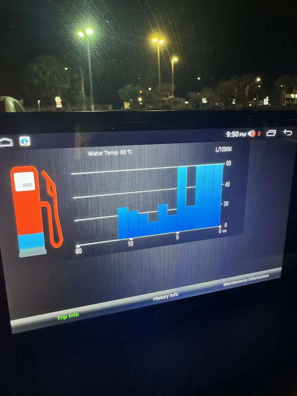

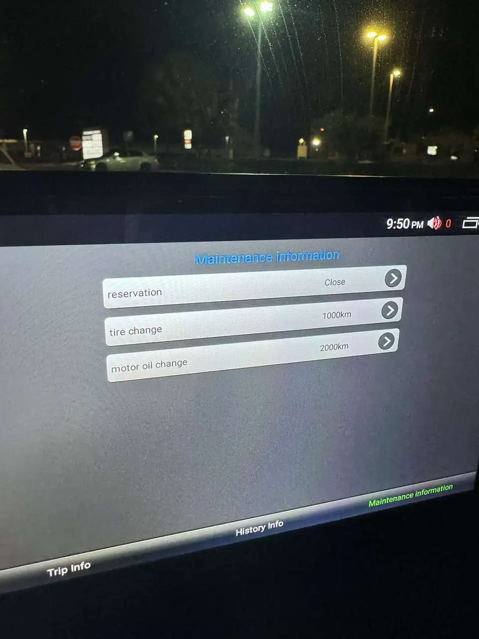

I used the ASURE Android head unit from Amazon. The exact one I purchased isnt on there anymore, but there's similar options. It doesn't have stock software, but it has an app that allows you all the car functions from the stock radio (though a bit different, it's just a list of all the settings plus a few other things that you can check on or off or set to different options from a drop down. The only thing that didn't come over is the ability to reset the maintenance light, so make sure to disable all maintenance settings on the stock head unit before removing it, and then set them up in the new head unit. I still get pop ups on screen for oil change etc, but no longer get the wrench light on the dash. I actually had to swap the stock unit back in to disable everything and get the light to go off because I didn't realize it the first time.
