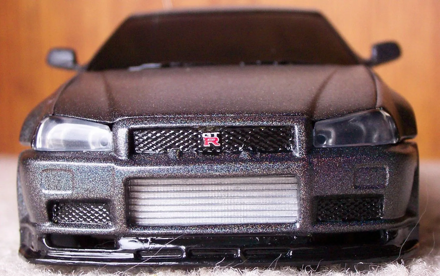

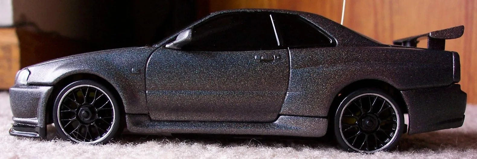

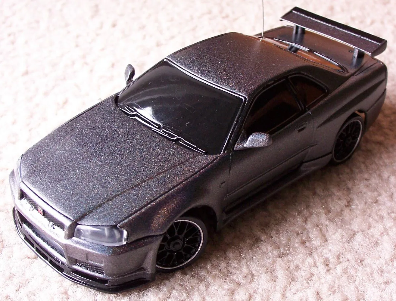

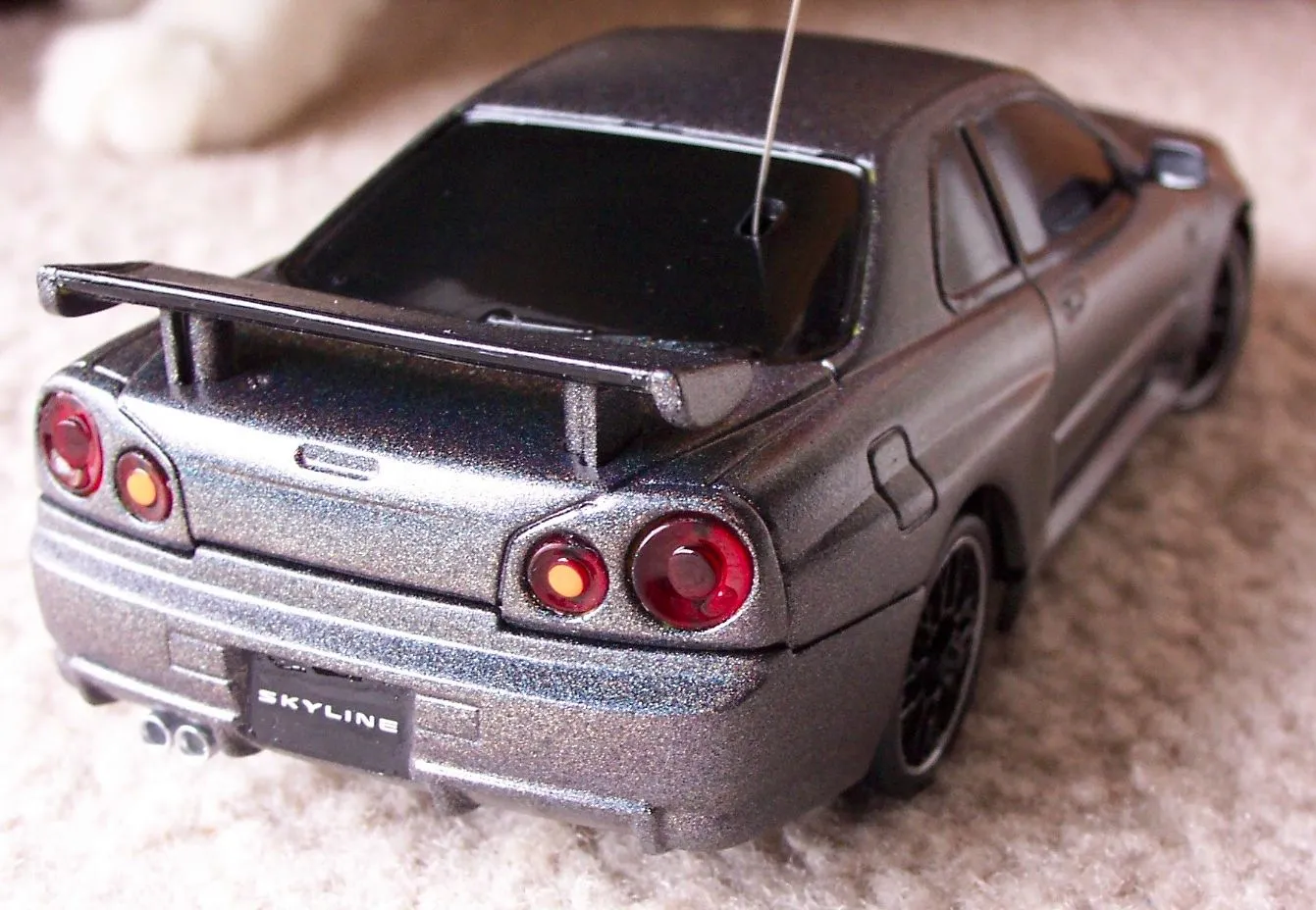

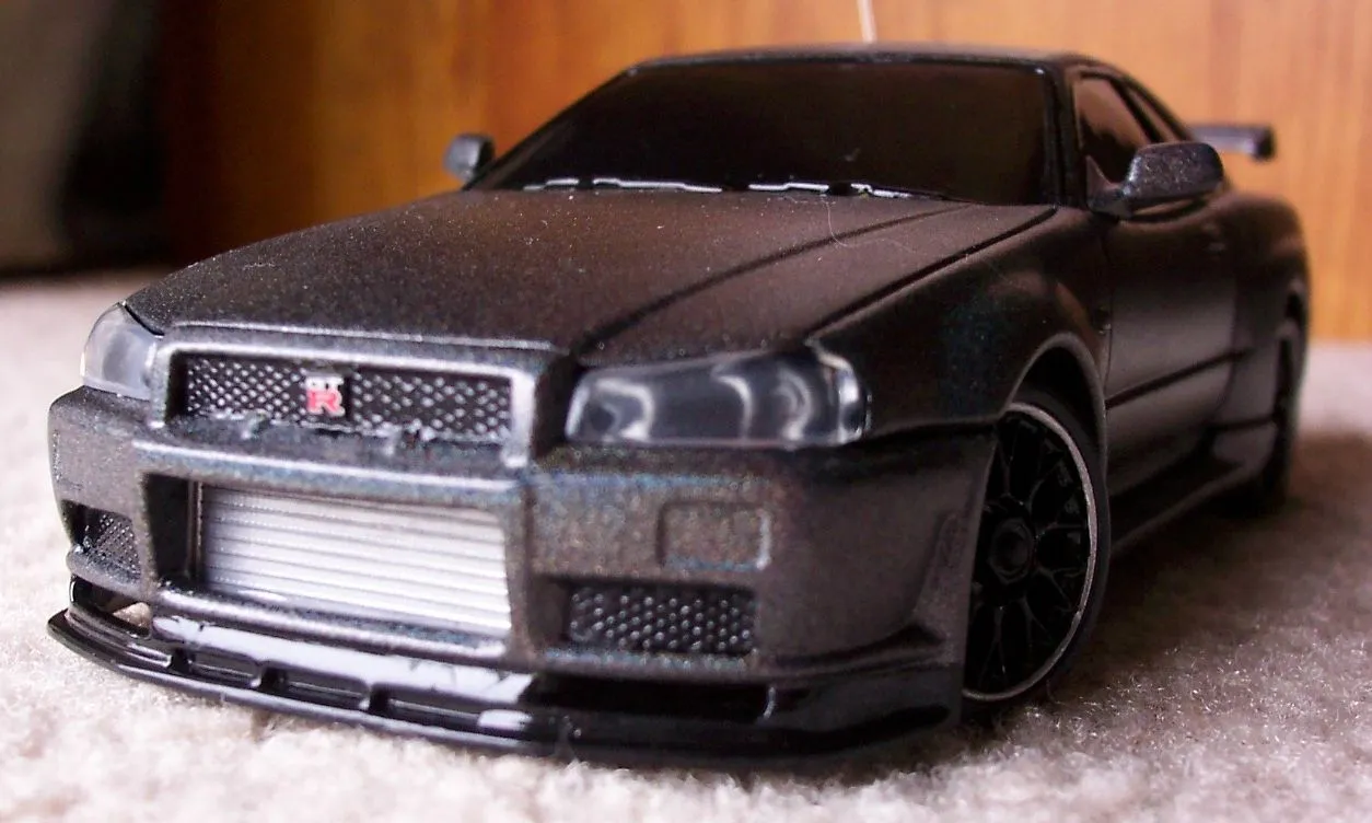

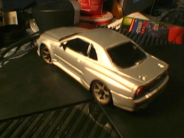

i know im not the only who has one, so lets see what everyone has done to their xmod.
i got the skyline last week and i hated the color, so i changed it. i got the idea for the paint from ken, whom used the same paint on his amp. it looks dark metallic grey, but it changes when the light hits it.
i also cut out the lower front grill and added an intercooler from a skyline model that i had laying around. i painted the rims gloss black and went back over the lip with silver paint. i decided to paint those rims because i didnt like them and i wouldnt use them otherwise.
i also have the lighting, suspension, wheel, and tire packages, as well as the stage 2 motors (which i have yet to put in). i cant find the body kits for the skyline anywhere.

i have a question
how did u paint it?
i tried mine and i failed miserably
tried to paint it metallic silver w/ spray can
any tips/suggestions
thanks

i took apart the entire body and sanded each peice with 400 grit sand paper. do not sand all the way through the paint, especially around the edges where 2 body pieces meet. this will cause it to not fit properly when you get it back together. just sand it enough to where the gloss coating is removed.
then i covered all of the windows, grills, and anything else i didnt want painted with tape. i used an exacto knife to trim the tape to fit the places i wanted covered.
then i wiped all of the pieces with a damp cloth to remove all of the excess sanding powder.
then i layed all of the pieces on a newspaper and sprayed them. spray from about 8 inches away. if you get too close, the paint will run. then i flipped all of the pieces over and sprayed them.
if you want to paint smaller areas, such as the rims, you could use model car enamel paint. it works very good and you can get it in practically any color for about .90 - $1 per bottle
thats pretty much it. it is tedious work if you want it to look good, but it was worth it imo.

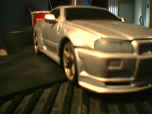

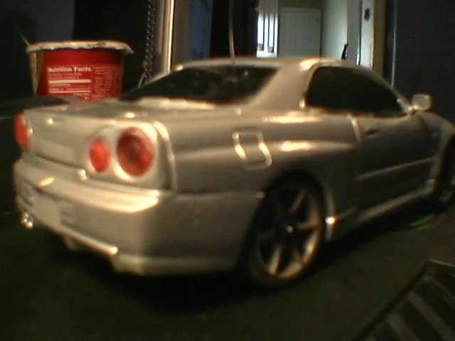

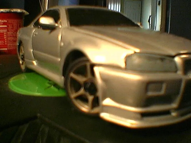

Heres my Skyline
My only Xmod, so its had its share of wrecks... Only mod is the stage 2 motor set, running the drag motor (or whatever one has the most tq) spins the rear tires on demand, Ive never had so much fun on a hardwood floor. Im going to order another body because this one is messed up. I was drifting in the kitchen and my poor car just drifted out the open door and rolled alway down to the basement (poke). Planned mods include, a spinbrush hybrid motor, metal bearings, new body, rims, and a 5th cell (burnout)

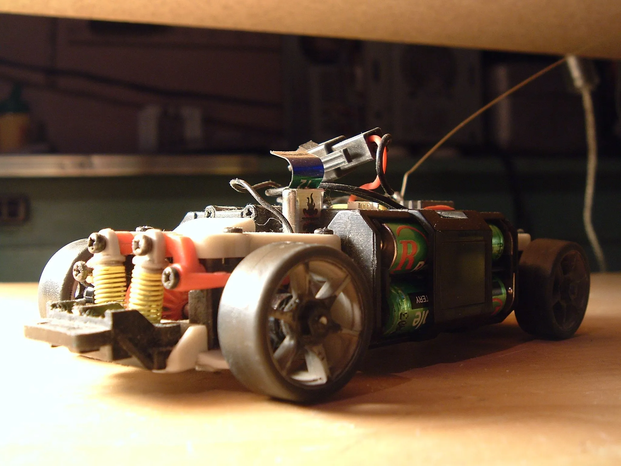

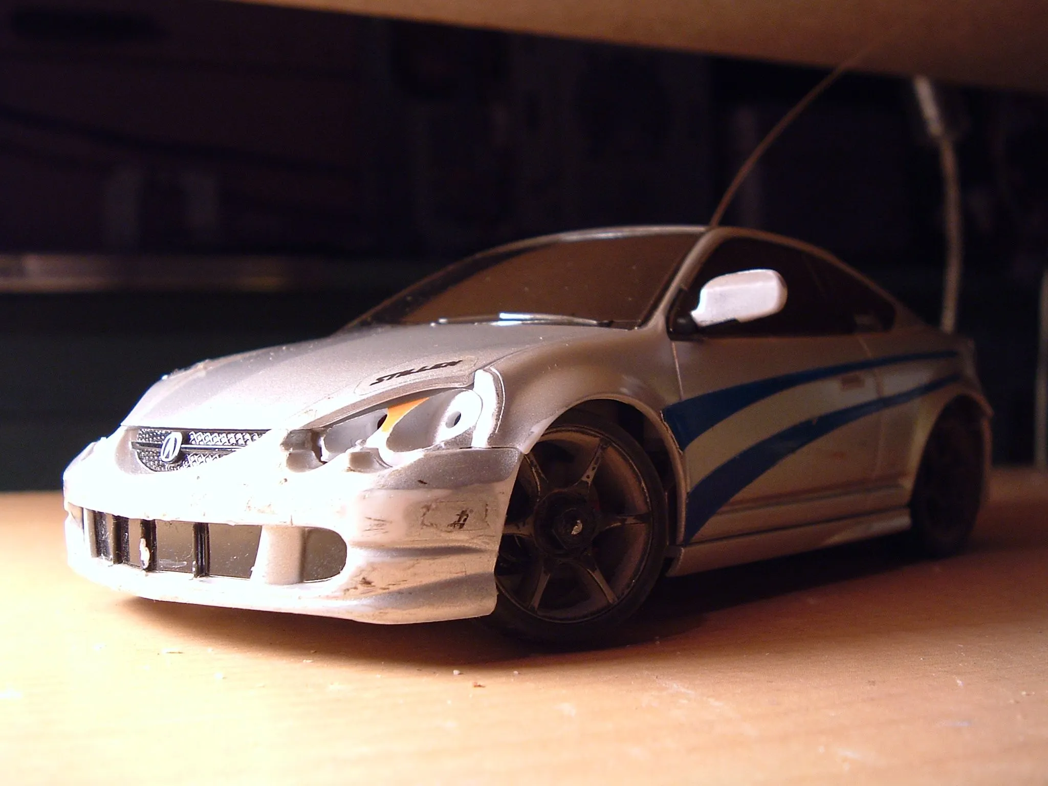

here's my list of xmods
RSX
AWD
light set
stage 2 drift motor
suspension upgrade
bearing set
Skyline
Lights
stage 2 whatever motor is next up from the drift
suspension
bearings
body kit
Supra
stage 2 drag
suspension
bearings
body kit
I also have rims....and tires for them oh and also the crystal set
i probably forgot something but i dunno
i spent way to much money on these (yes)
pics to follow the last one without the body is the RSX.......I love macro mode! sorry about the size of the pics
yes my xmods are beat to hell....I have a track in my basement so all my friends come over with theirs and we race.....its gets violent sometimes
