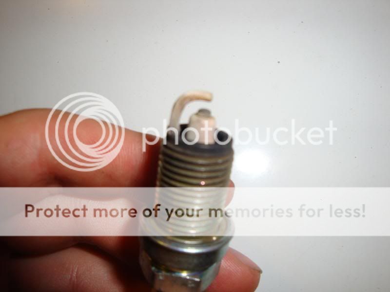

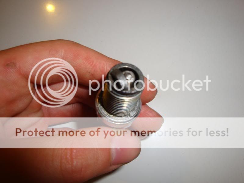

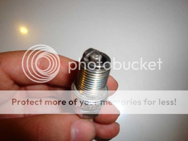

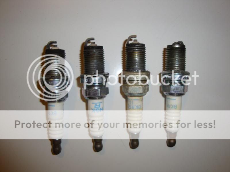

Pulled the Plugs...
ok.....ok.....ok.....wait a second....
Can't remember if the numbers go from left to right, but cylinder 4 was blown. The same one that blew last time too.
The last one that blew, it was fused together but we gaped it so I could get to a parts store.
I just replaced cylinder 4 with one of the old ones for now.
Fixed my problem, temporarily. I guess I need to get new wires and coils. Anyone wanna show/tell me how to do the 1.8 conversion, might as well do it if I'm going to replace the stuff.
