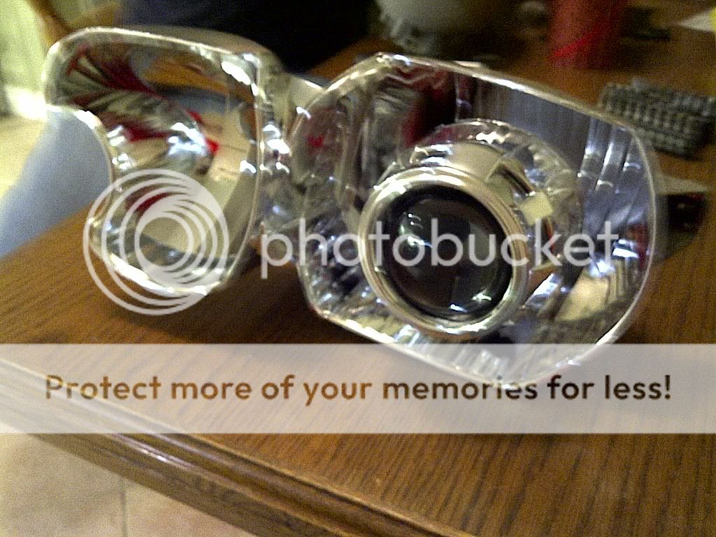

thats pretty much exactly what you need to do, no cutting at all. this is a sedan light but same projectors your looking at,
back of the projector threaded to the reflector bowl
projector mounted in the reflector bowl
finished light
chrome projector, protege5
blacked out protege5 projector
damn wish i woulda saw those before i did mine 3yrs back....i ended up cutting my original housing all up and what not they work great just i guess i did a lot of unnecessary work
