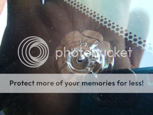

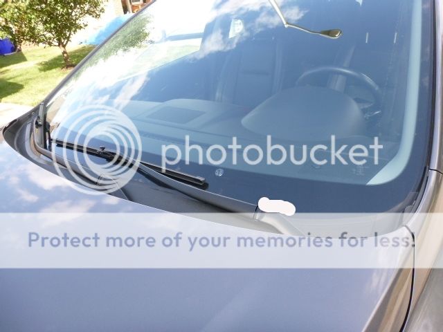

So something got my windshield. I think it was a piece of a firework still hot and melted into the glass and caused it to flower, but I could be wrong. Maybe its just a small black rock that was stuck in there.
In any event, thankfully in Kentucky glass has no deductible (as long as you carry comp coverage on your vehicle). After researching good glass companies, it looks like Carlite, PGW or Pilkington are three good glass manufacturers who also manufacture glass for new vehicles (oem providers).
I used Glass America since they are on board with CASPA, AGRSS, NGA, SIKA and NGA and keep up with their certifications. i.e. they use gloves, proper primers and adhesives, and utilize only windshield glass that is oem equivalent. (unlike Safelite).

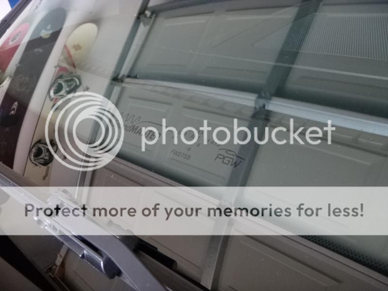

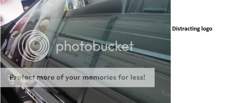

So far, looks good, I can't tell any differences from a visual standpoint other than the brand stamping, which has nothing to do with the manufacturing of the glass itself. Yes its looks better to have "oem" brand stamping, but such is life.

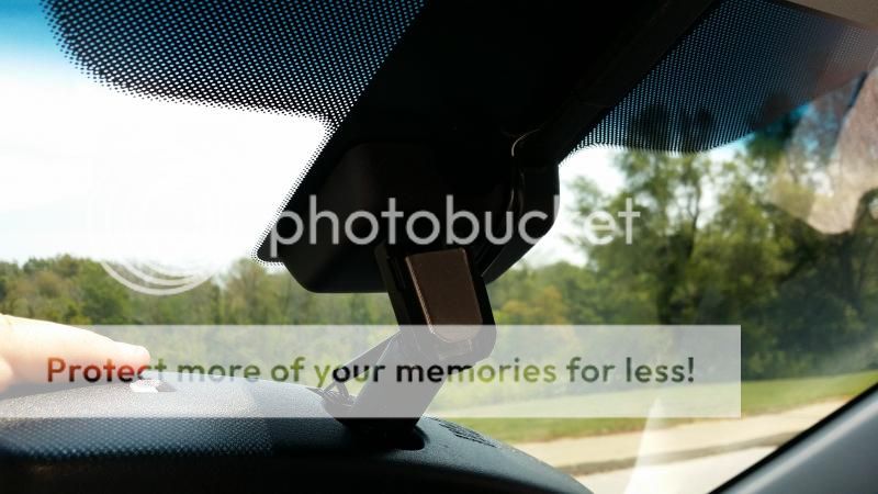

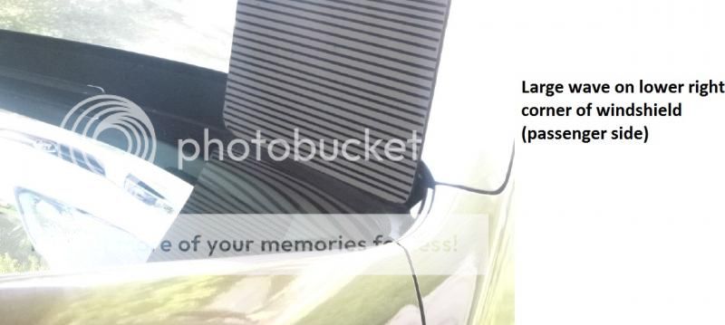

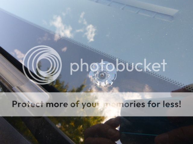

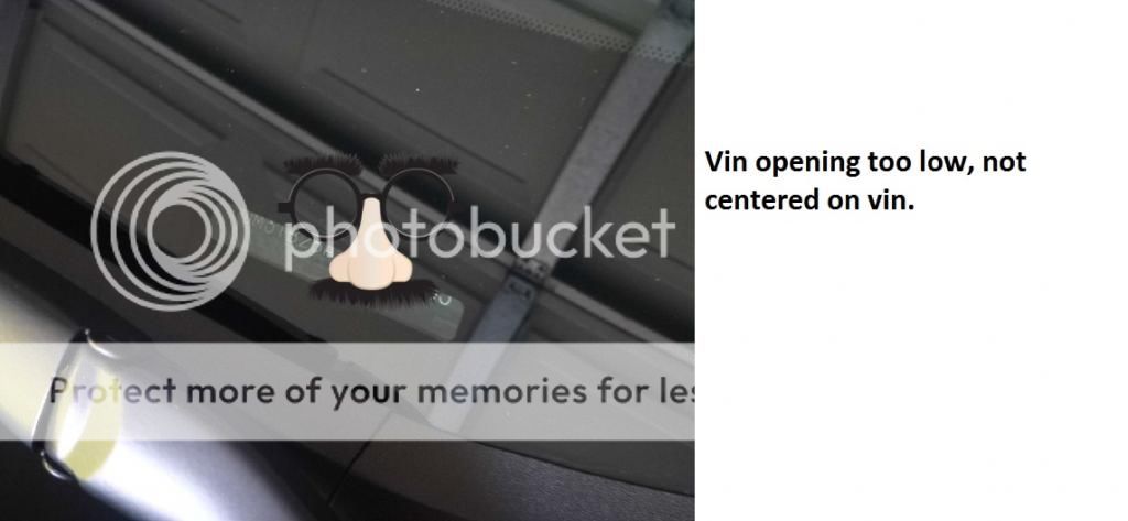

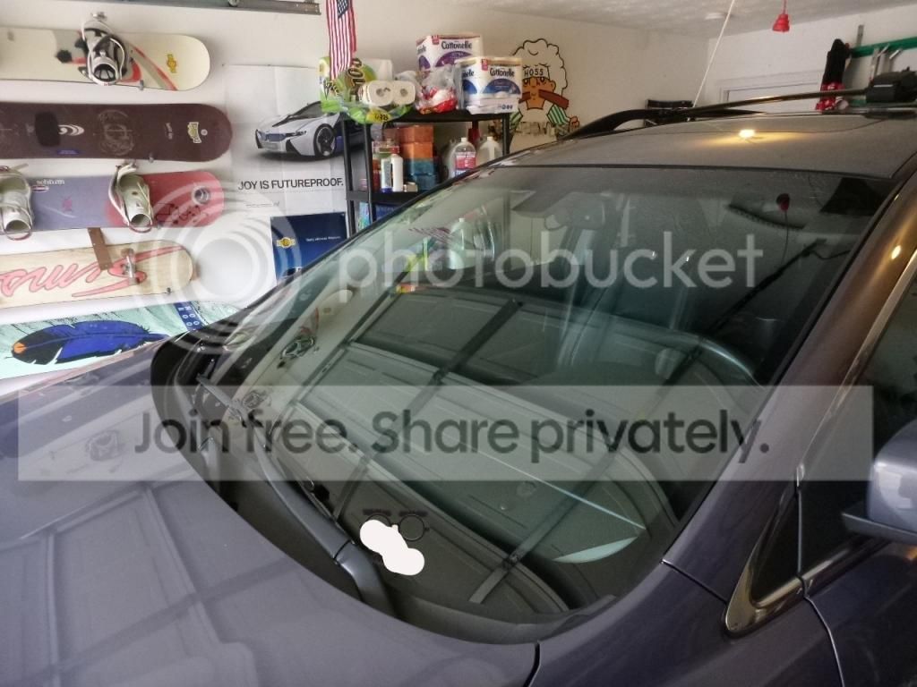

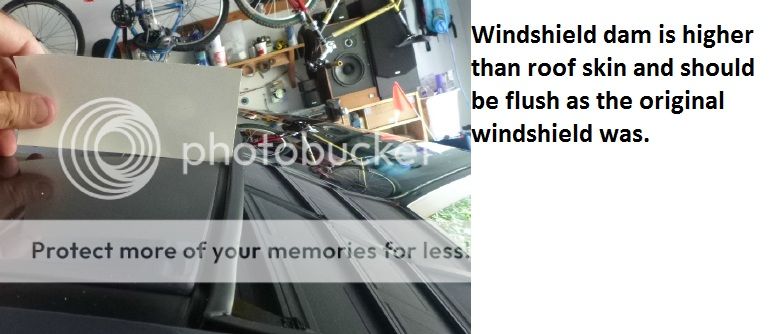

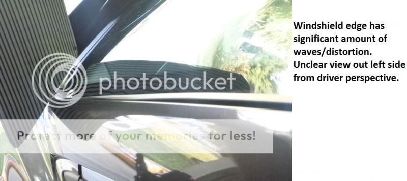

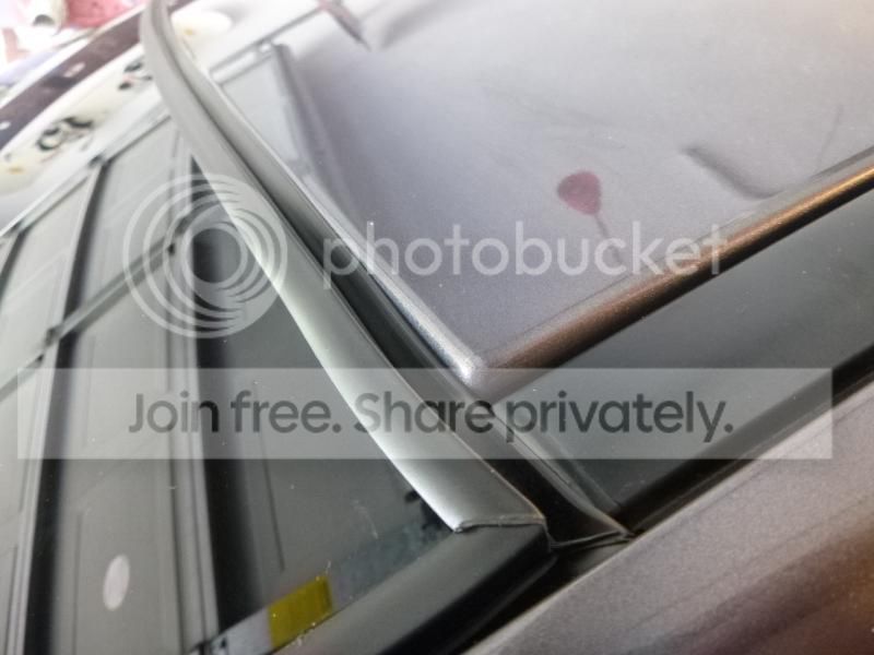

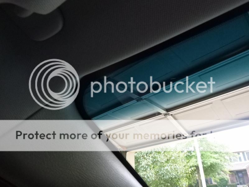

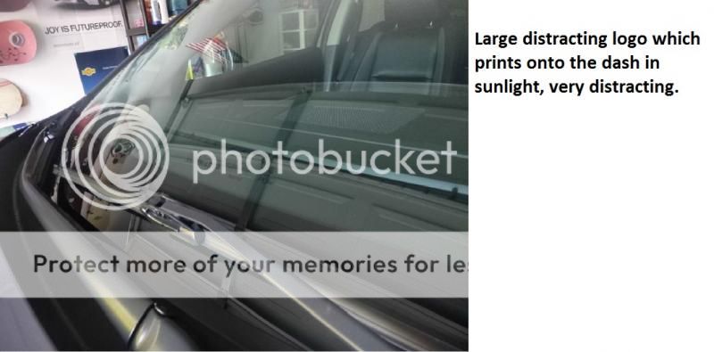

So after a close inspection of this glass, it looks like it's a no go. Although supposedly PGW is a "OEM" supplier, this glass is deffinately not "OEM" quality and is certainly not an equivelant piece of glass. Sitting in the driver seat, it looks like i'm wearing prescription glasses with varying levels of blurriness depending on where I look. Glass has all sorts of issues. At this point, I will put my foot down on a piece of factory glass from Mazda, since their attempt at using alternative glass was unsuccessful in putting the vehicle back to pre-loss condition. I don't mind playing that game, not at all. Just have to to the leg work to keep the gameboard moving.
UPDATE: I pointed out the waves in the glass to my wife this morning in the garage, and told her how distorted it appeared. She told me I was nuts.
So I got a phone call from the wife this afternoon telling me that she is getting motion sickness, dizzy and having naseau from trying to drive and focus looking out of the windshield; it was messing up her vision due to blurry spots, clear spots, distorted spots, etc. She apologized for calling me nuts (about this specific item only)

Update: Still waiting on the Mazda windshield, however, while at the wildlife center today, the crappy PGW windshield decided it doesn't like to sit in the sun. Thankfully it was very near falling off but hadn't fallen off yet when I got in the car, and I was able to disconnect the mirror before it fell. What junk!!!
