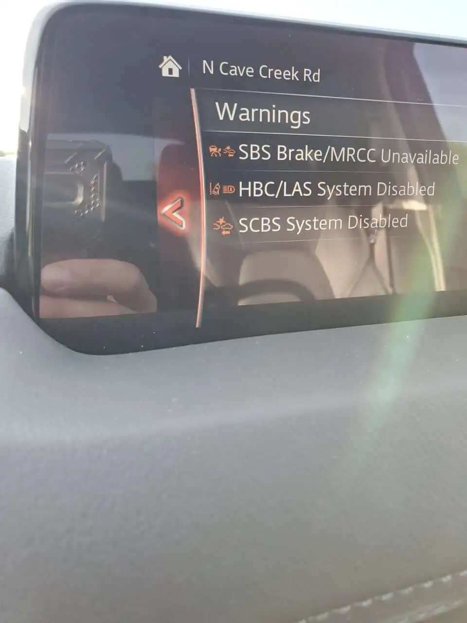

this is what stops to function normally when the Front camera is not operating as expected.
And it is not always mandatory to calibrate it after windshield change. But it is recommended.
I wont go into too much details just say that there are scenarios when calibration is not needed.
