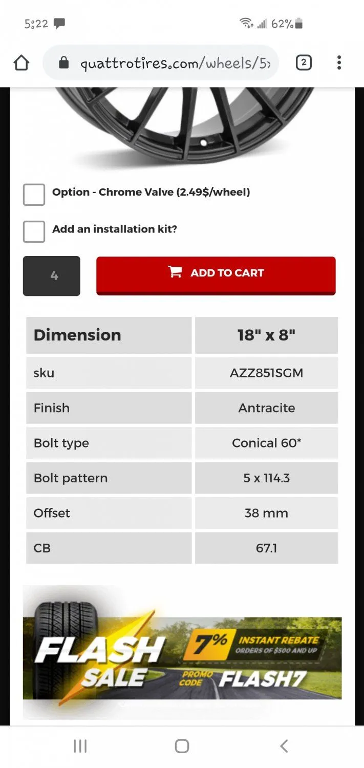

Hi everyone. I have a 2017 Mazda cx9 signature series. I want to buy these 18" rims for winter tires.
Will it work?
Thx in advance :)
The only spec that looks different from OEM is the offset. (30mm vs 45mm). According to the wheel size calculator this would result in a wheel that sticks out more than stock.
"Tire will stick out 15 mm farther. Rim will stick out 9 mm farther. Acceptable for most cars" A lot of people run narrower tires in winter so how much they stick out could be reduced slightly depending on the tire size you choose.
Also, you should confirm the wheel load rating, to make sure it can handle the wheight of the CX-9.
