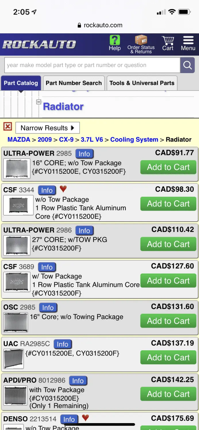

Is there a difference in the radiators with and without the tow package.
Yes, they are different.
Is there a difference in the radiators with and without the tow package. I have a touring without the tow package and what is the name of the shop in jersey. Thanks again.
I have 2011 and there is no tow hitch on back. I called dealer and gave vin #, they said tow pack. I bought tow pack radiator. If i do not remember wrong there is only size different.

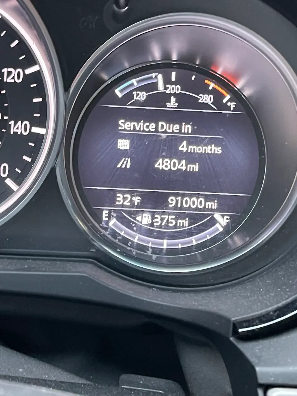

Just hit 91,000 miles on my 2016 CX-9 Grand Touring. Bought it at just under 25,000 in 2019. Wouldn’t have gotten this high if I hadn’t driven it to university everyday for the past four years.
