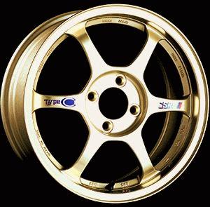

Hey fellow Speed3ers whats up. Surfing the web I came across this Wheel weight chart. Not sure of accuracy, but it has to be close. Also not sure if every rim model is covered or every size is covered. Might come in handy for people who r going to be buying some rims for their ride in the near future.

SSR Type-C Competitions 18x7.5" 15.5lbs

yeah but your oem rims are heavier... the mazdaspeed replacement rims are probably in that range but your oem ones are not... iirc they are around 22lbs
and for the record i have the kosei wheels and they rock deffinatly improved my steering feel and so far have taken a beating from maine roads (its contruction season big time now) and have had no issues... good cheap/stylish/light wheel imo
