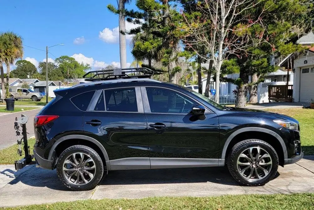

This is my first post here. I have a 2016 CX-5, GT with the 19" inch wheels. Just put a 40mm lift on it, 235/55/19 A/T tires, roof rack with utility box and love how it looks and drives. I was thinking of adding 3/4 spacers to the wheels to make it look a bit more rugged. Has anyone used wheel spacers; if so, were they hub centric or not and was there any issues with sensors at all?

I originally wa going to go with 1/2 inch but the back wheel wells are wider than the front. The 1/2 inch would make the front flush or a little post flush because the new tires are about a 1/2 wider.

But what if one wants to keep the OEM rims? I do like the look of tires and rim set a bit back into the wheel well on this CX-5 KF, so I am going with only 10 in the rear probably.
