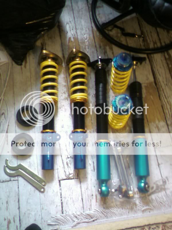

I'm running std standard r5 coilover pillow ball and camber plate spring raet are 6kg front and rear its better than stock and still confortable
