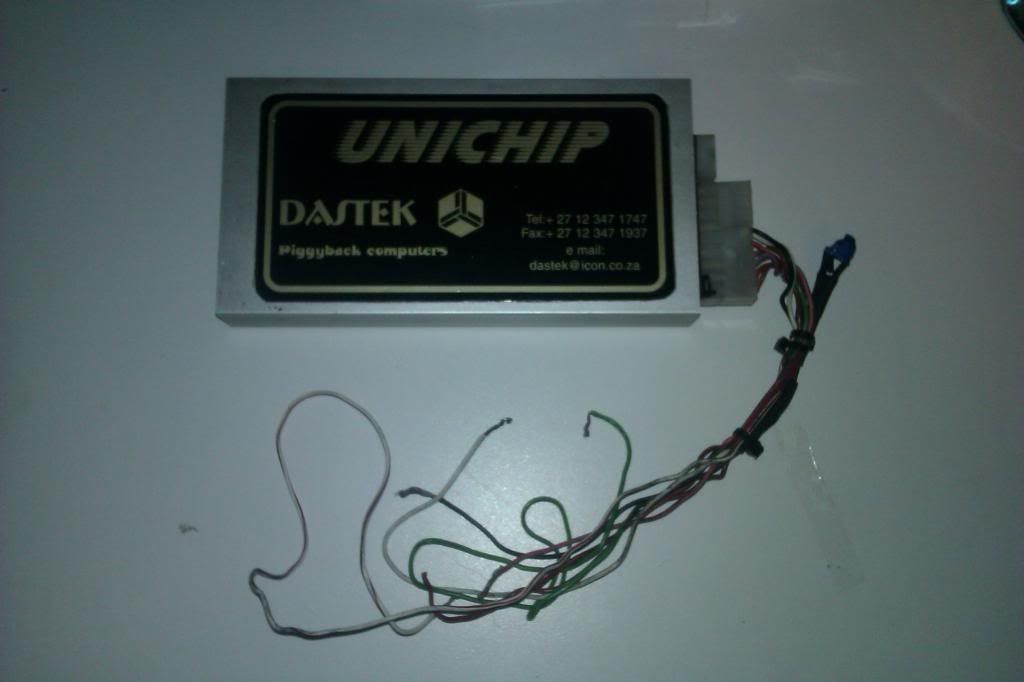

Hello there! I just wanted to know if anyone out there have had used a Dastek Unichip Piggyback to tune a protege before?
looks like this! I have one but idk what i need to make this work...
On the other hand what are other options for me if i cant get this Piggyback to work? thanks guys.
From a quick google search looks like an old cheap unit. To get it tuned you will need to find an authorized dealer and pay them. I would suggest the ssafc if you have a laptop you can tune it but only fuel tables, if you want to play with timing you will need to go with a stand alone

Dam i doubt that theres a dealer here to make this work. hmmm Reason why i ask is becuase im gonna turbo my car and i need something to tune it with. my friend recommended me split second. and I live in the NoVA area.

Don't you mean mp3 ecu? There was a guy on here, spicedmsp IIRC, who flashed them. I think its you pay, he ships, you ship yours to him, he refunds you part of your payment. Don't quite me but thats my understanding. The mp3 ecu would smooth out the powerband and alter ignition timing. You'd probably (or would) Ned to run premium. But gas is so cheap in VA. its 3.7# here last I checked...that's for regular.
If you are putting in a turbo you will need an msp ecu. Your stock protege or mp3 ecu will cause huge problems. As far as tuning, ssafc is tried and true. You can also look into megasquirt.
