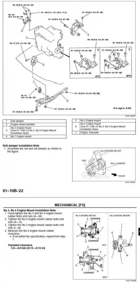

This morning I wrote “engine mounts” on my to-do list after feeling movement through the stick during acceleration.

I recently replaced the passenger and front motor mounts (both were completely torn) but the transmission and rear mounts looked intact.
I used the AWR poly mount for the front and I'm really happy with the performance and low vibrations. NOTE: when you purchase the passenger mount or the mount kit (with all 4), just make sure you get the one that has the stabilizer arm pressed in already. It's the part that attaches to the passenger frame rail (p/n A6481). Also, the bolts for the passenger mount cost me about $350 because the first bolt broke my 3/8" deep socket so I had to buy a DeWalt impact + impact deep socket kit.

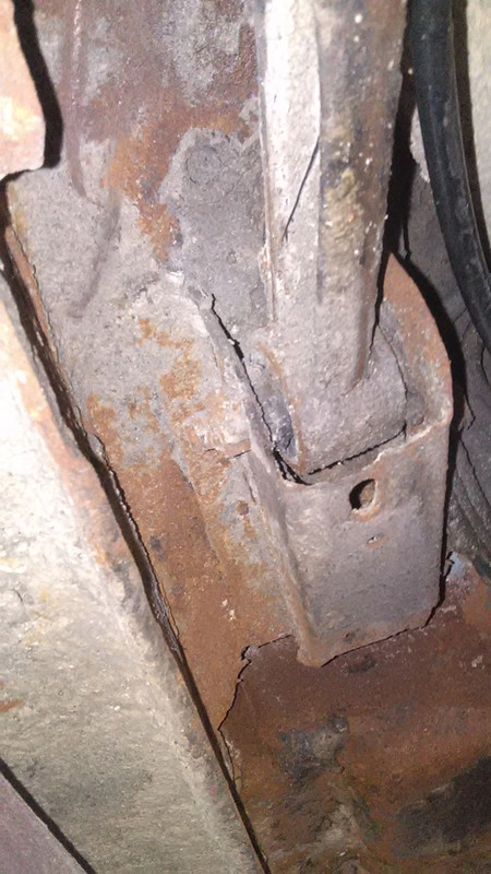

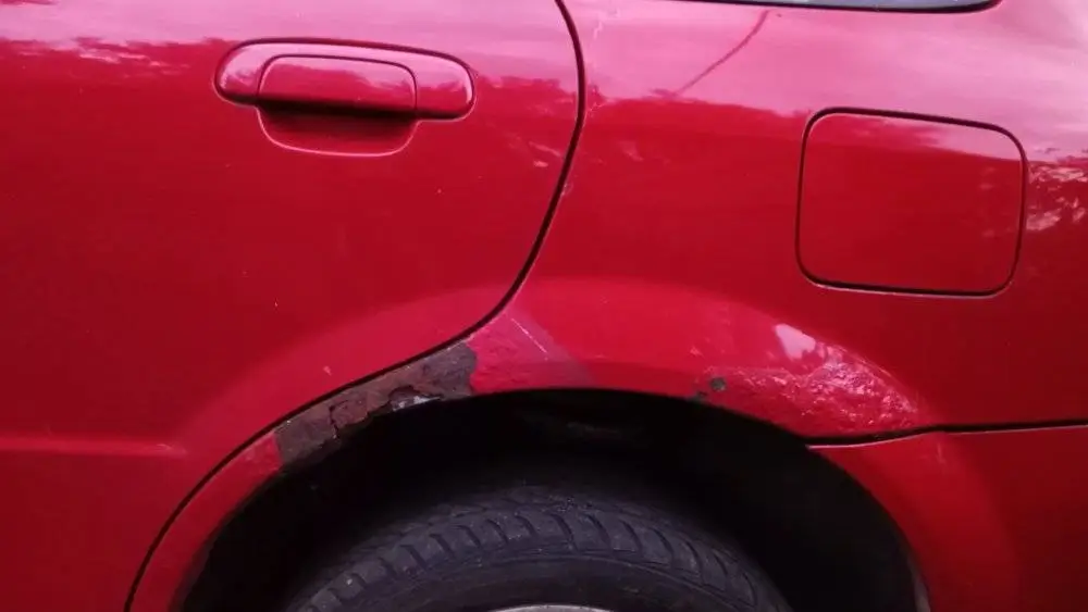

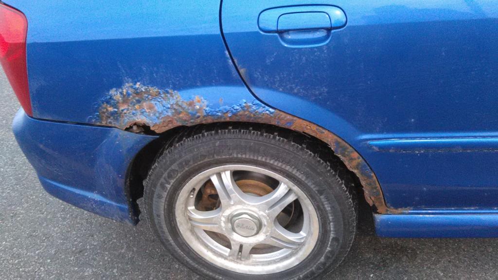

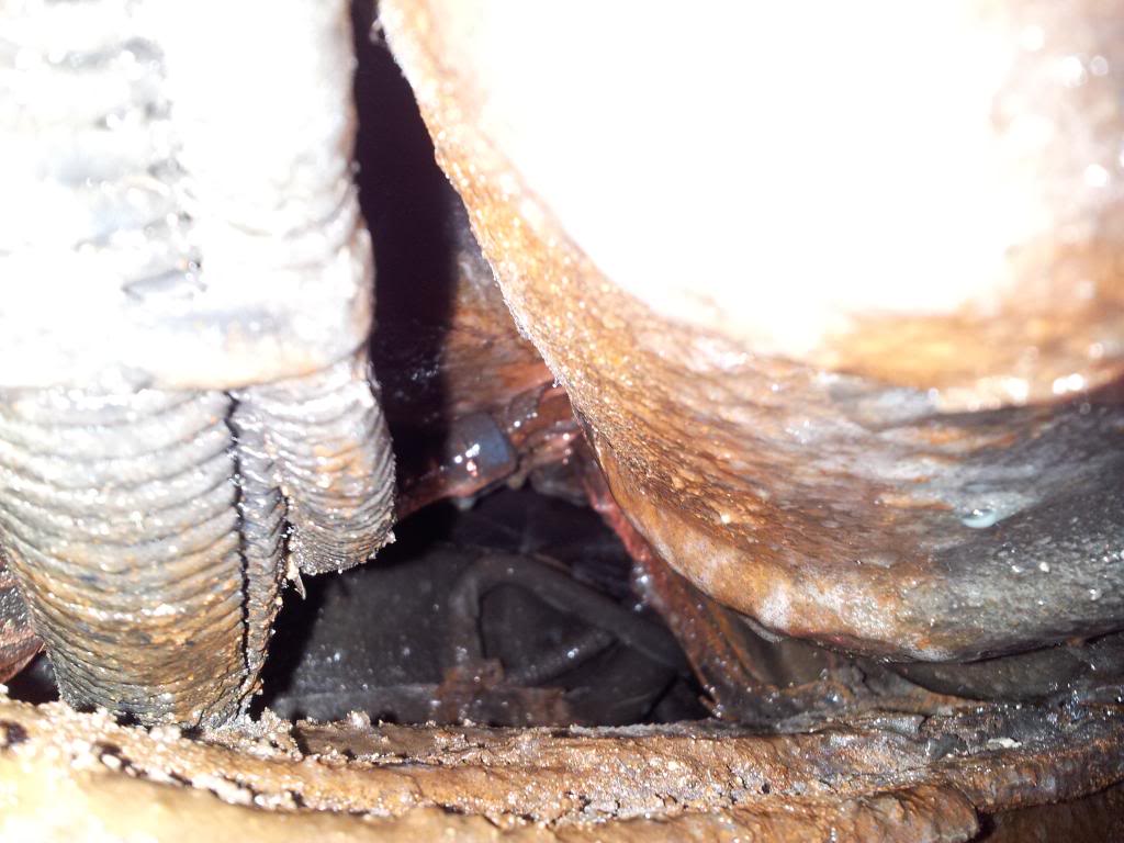

You should hose the area down with something like this...
You can't stop the rust, but you can slow it down by 85%.
Consider taking it in for a proper undercoating, even if just once.
Keep your car going as long as possible.

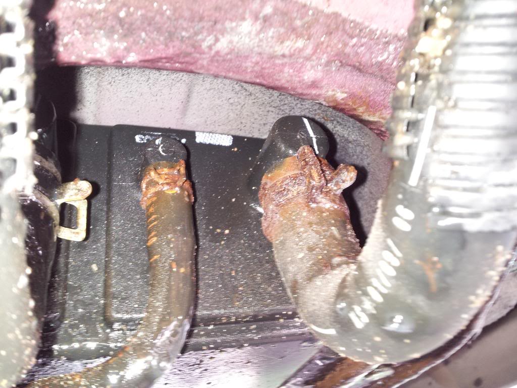

My gas tank rusted through, so I replaced it.
It was still worth the time, effort and money.
My frame is reasonably solid.
My other side rusted through in the same way as your car.
I stuffed an oil soaked rag into the area.
It sealed the hole, slowed the rust, and stopped any exhaust from getting in.

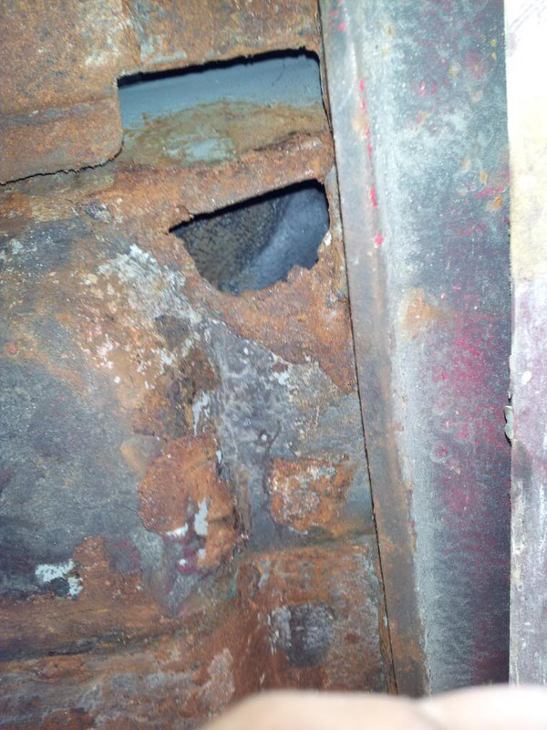

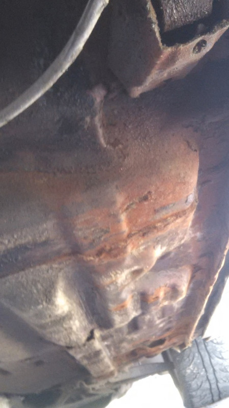

These are my floorboards...
And other parts.
And every other P5 around her that is still alive...
Cake that inner wheel well lip with grease.
It's messy, but it works.
