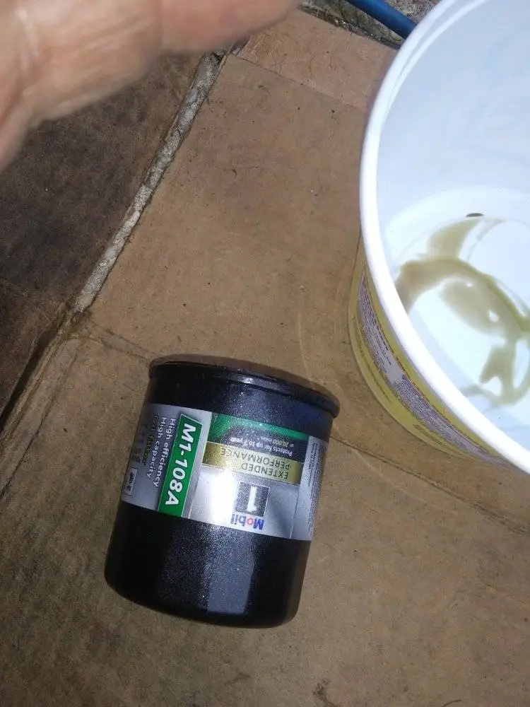

I have a "low profile" dipstick just like yours (and kinda like it that way).

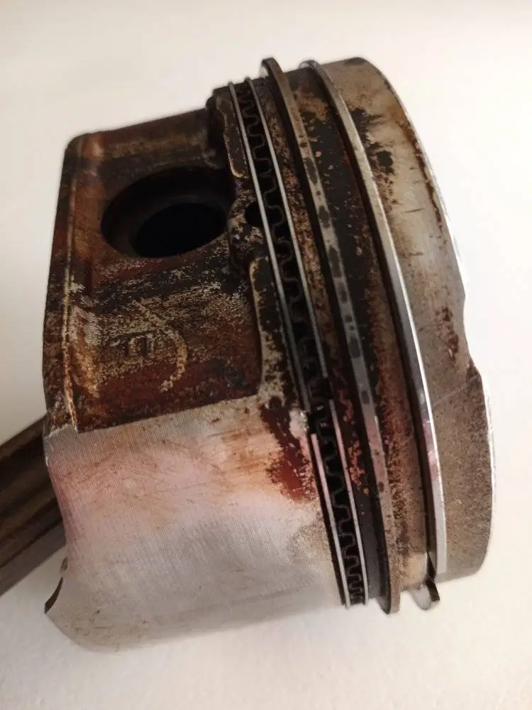

Years ago, and oil change place down the street from me broke off my dipstick handle. I found out when I went to check the oil and found that it had been taped back on; came off right in my hand with remnants of engine-baked cellophane tape on it. The shop had cracked my accordion air intake as well on the bottom and the engine was getting unmetered air. I took it back and the manager took responsibility.
Prior to that, an oil change/car wash place in an expensive neighborhood (with fancy cars) left my oil filler cap off. I found that a month later, and the filler cap had been left sitting next to the hood latch. Amazingly, the car had lost no oil, but there was an oil sheen *everywhere* under the hood. The shop detailed my engine and paid to replace the under-hood insulation.
Last year, yet another oil change place didn't install my drain plug properly and I toasted my engine on the highway after the plug flew out. Took three months, but the shop paid for a JDM replacement for it. My buddy walked by the shop the other day and saw a P5 in their bay and he almost ran over to warn the owner. :D I got a coupon from them just a few days ago that said "Under new ownership" on it.
I don't change my own oil here at the apartment out of fear of a mess. I'll start doing it again when I buy a house. For now, I hunt for dealership coupons and don't drive either of my Mazdas all that much. Oh, and I did the free oil change for school/university employees just the other day at the Mazda dealership - no Mazda required. EDIT: That offer is good to the end of September, btw.

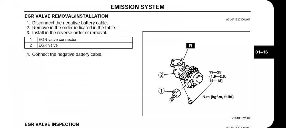

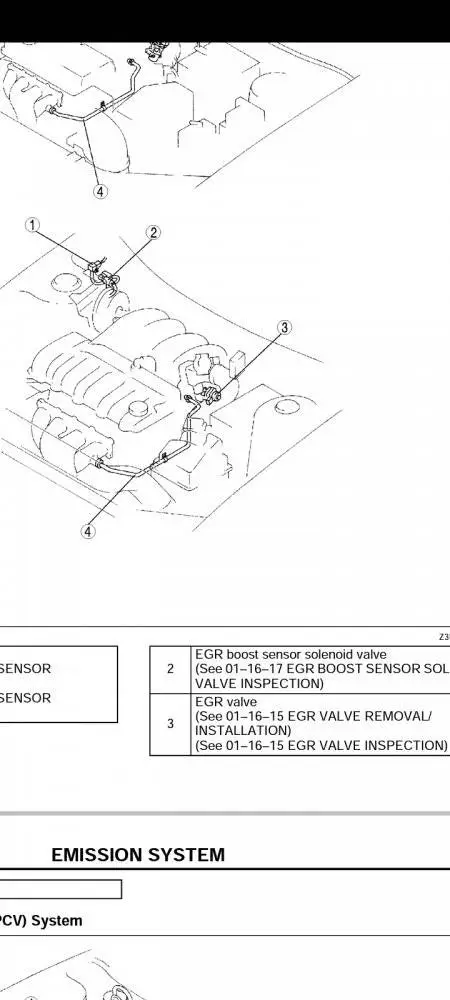

Here ya go...
It's real easy !!
4 simple steps.
Lol
(PS... it's a PITA.
If you've got short fat fingers, you may not be able to remove it.)
I think the bolts are hidden and you have to work on it blind ?

Here ya go...
It's real easy !!
4 simple steps.
Lol
(PS... it's a PITA.
Thanks!
To give myself some credit, I was actually looking in the shop manuals to find that page when you posted this. I am not used to finding things in the shop manuals though, and I was not having much luck.

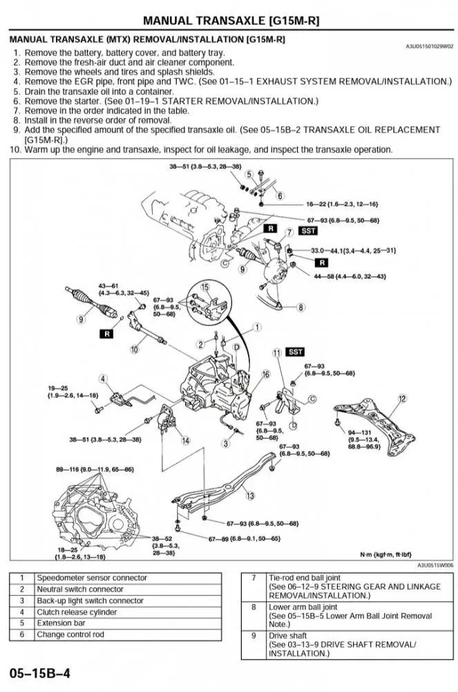

This is how you remove and reinstall our manual transmission...
It's in and out in 10 easy steps. Lol

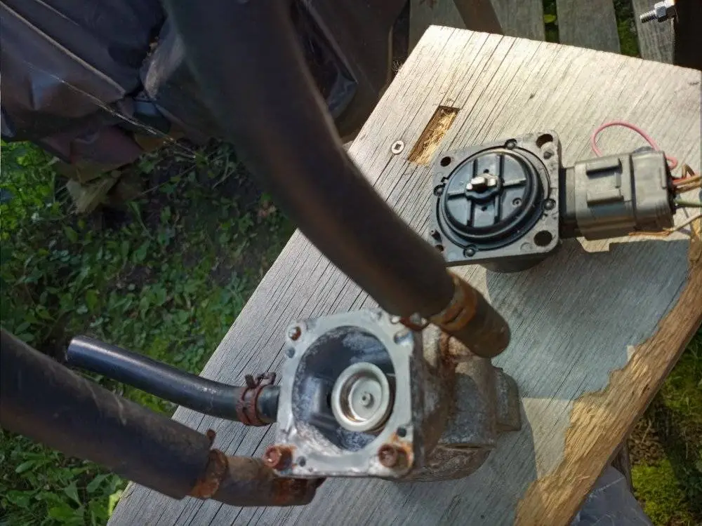

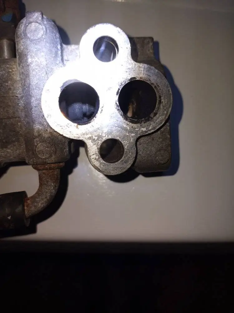

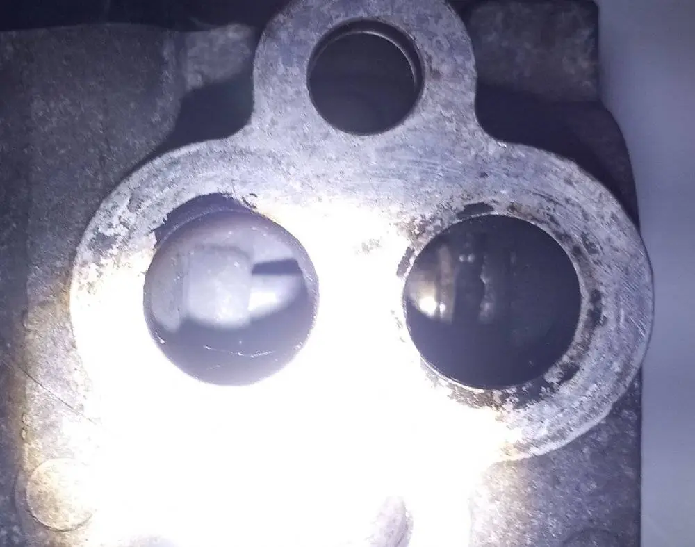

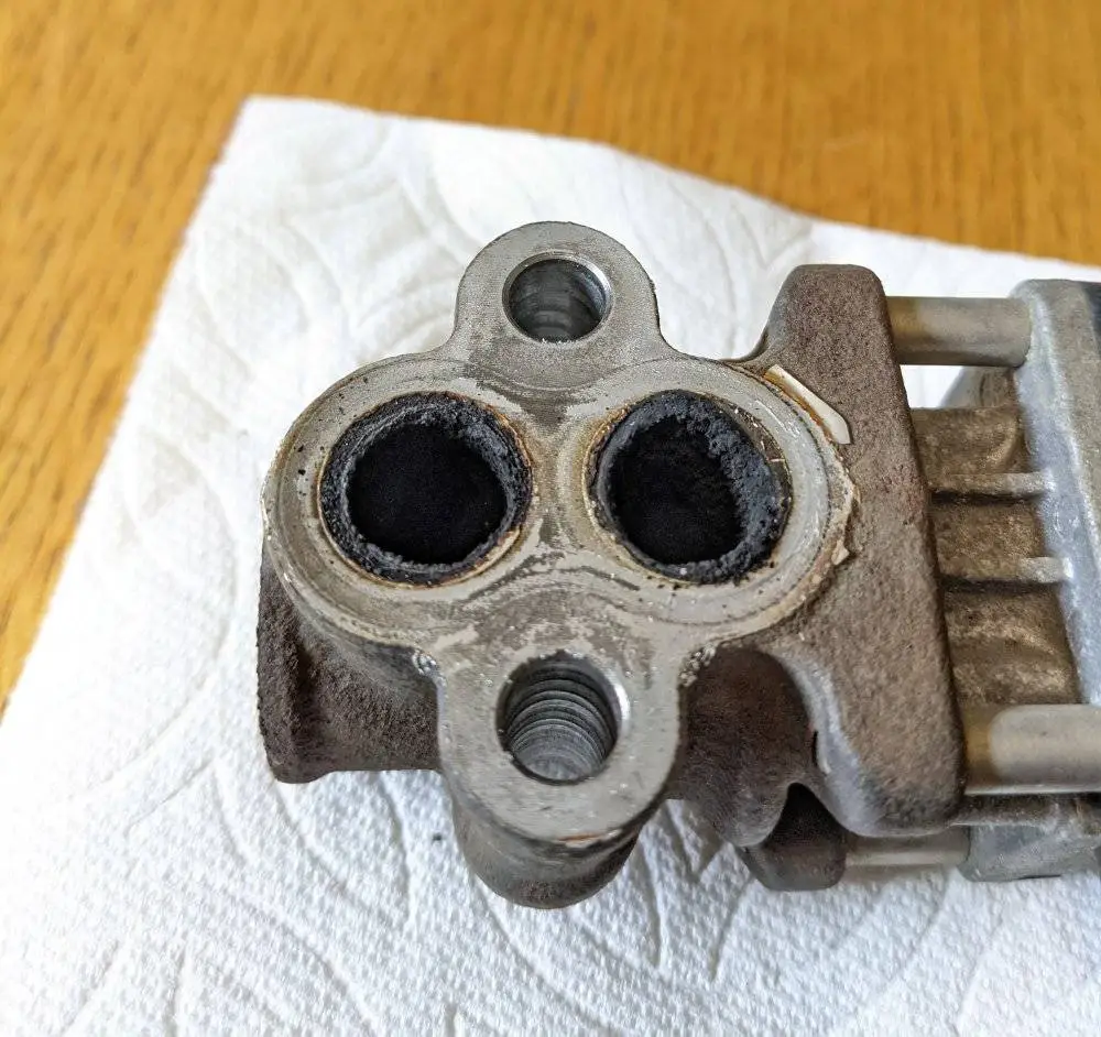

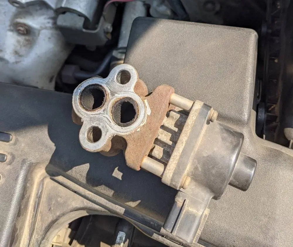

Got the EGR out. It was a bit of a puzzle, but not too bad once I figured it out. I think it took me a little over 30 minutes. The best thing about it is the fact that you don't have to do a bunch of other stuff to get to it. I removed my strut brace, the intake tube, and moved some vacuum lines and that was all the room I needed.
It definitely looks dirty inside. Now to try to figure out how to clean it properly, and then reinstall it.

Awesome !!
You may simply have enough built up crap to restrict the flow.

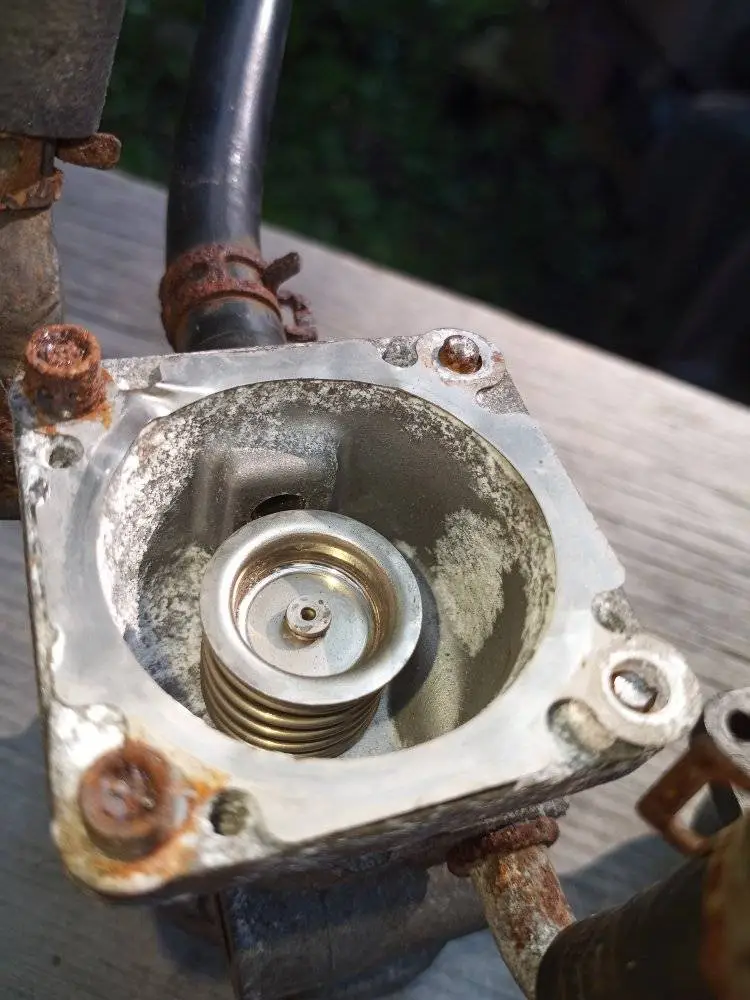

Here's some pictures of the EGR from my parts car.
I kinda forgot about it, and I completely forgot that it was a Canadian EGR. Lol

It's the plunger shaft that is of most concern.
As far as I understand it, the EGR valve is closed at idle with no exhaust getting into the intake air until you're basically cruising, that's when the step motor pushes the valve open to let exhaust into the intake.
If the plunger shaft is all sticky, the tension on the return spring isn't enough to retract the plunger after the step motor backs off and your EGR is stuck open when the car tries to goes to idle and that's when everything goes to s***.
