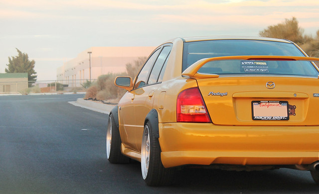

oh and I also went to mazfest last week...recived a free racing beat plate frame...and for some reason i'm pretty stoked about it lol(rolleyes)
im digging your flares. everytime i see a pic of your car on my phone (yes i saved the picture) makes me want to put flares on mine lol
I liek the black flares on yellow but man.. had anyone tried looking for larger fender flares? Those look to be to small and don't really fit the natural arch of the car. They would look 10 time better if they were teh right size.
