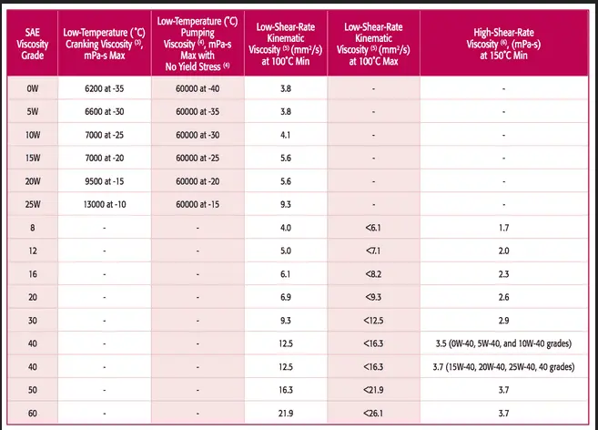

There is no industry standard for oil filters. Filter makers reverse engineer the stock filter and make one that matches or pick one out of their catalog that probably is close enough. Oil is different. The car's owner's manual gives us the industry standard spec for oil, and that's we we're to follow. As noted, 5W-30 is the viscosity spec. API Service Category SP is the current spec that supeceded the older spec of SN. ILSAC standard GF-6A is current and superceded GF-5.
So...pick any top brand oil. Synthetic isn't required, but may be helpful for our turbocharged engines especially if you drive where it is frigid cold, or very hot, or plan on owning your car for a few hundred thousand miles. If you're still in the car's engine warranty it's probably wise to stick with the Mazda oil filter. Otherwise use Mazda, WIX/NAPA, Baldwin, or a few other top brands...and probably not the cheapos.
