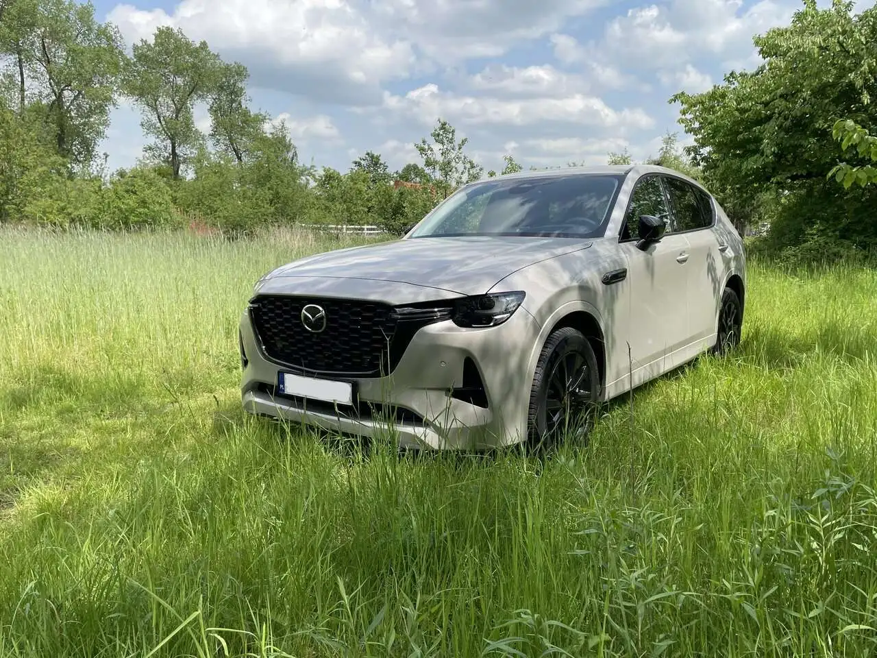

Little update - charged the battery from a wall socket for the first time and discovered that city driving in EV mode is actually fun. I used to avoid short distance driving in my Mazda 6, because gas engines don't like it. Now I don't hesitate to make a run to a store 1 km away over lunch break, because electric motors don't mind, of course. Same with slow moving traffic, super inefficient for gas engines, here - nothing of the sort. Plus the acceleration is perfectly adequate in the city, I never felt the need for the gas engine to be also running. Overall a great car. Here it is on the first really warm weekend of the year:
