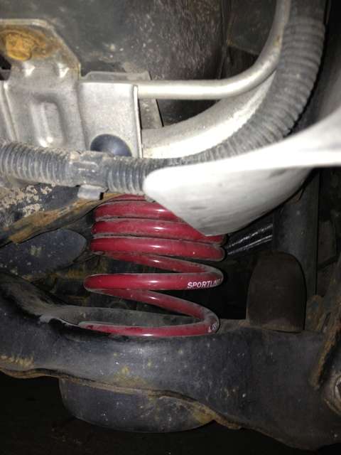

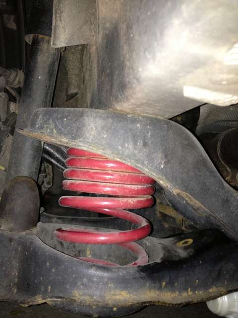

About 5000 miles ago I replaced my spring with Eibach sportline. At the same time I changed rear sway bar for ms3 one and camber arms for spc.. Since then I have that weird noise in rear. Every bump or pothole you can hear that noise like metal is hitting metal. I tought that is coming from rear endlinks since the bolt on sway bar is bigger in ms3.. Endlinks were changed today and the noise is still there. Any ideas what that could be? There was no noise prior to changing all the mentioned parts. My toughts are maybe thats coming from springs since shocks are oem and there is some difference in lenght/travel time. Attached are two pictures of rear spring as the car is sitting now. They look kind of squeezed like the coils are touching each other.. is that normal? Any other mz3 hb owers with those springs and same problems? Any help will be appriciated since I would like to avoid spending $800 on new shocks/struts jus to find out thats something different is making that noise. My car is '08 mz3 60000k miles ( 5k miles on lowered springs) Also last week during 60000 seervice at mazda dealer I've been told taht shocks/struts are ok
