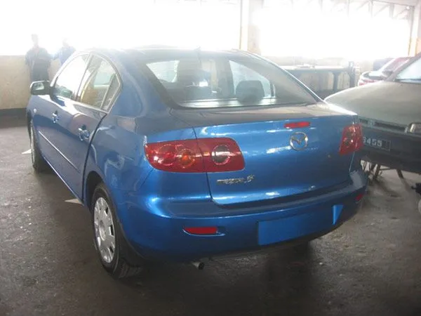

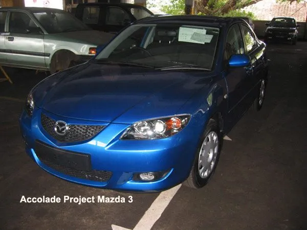

Hey we just purchased a mazda to make a full range of body kits for the car.
I do have some questions to ask from the mazda 3 owners.
1 ) Can you fit 18 inch wheels to this car, while it is lowered. Becuase our lancer scrapes a lot > If you can what type of tire size should we go for ?
2) What are best set of lowering springs for this car, I know that EIBACH has one. do you recomend it or do you have any other options. This should with a 18 inch wheel setup.
3 ) Also this will be featured on our web as our show car, What type of wheel design would you think would be the best, we thought of OZ Superleggra 18 "
Just let us know.
thank you very much

yea vivid's mazda is really low and he had tested 18" on his car, looks pretty nice , I think H&R also got some springs for mazda3 and autoexe got some 1200 bucks coil overs.
Thanks
Thanks for the info.
more info if you have. also any negative comments about springs or 18 inch wheels.
regards
Dimantha
haven't tried the springs yet, but i do have 18"s on with 215/45 tires, no problem at all so far. I would get the coil over myself instead the springs, cos spring drop is like 1.2" or so, not enough. (bike)
18's fit no problem with my drop. But if i hit even a rock goodbye fender. and that is just because I had a 35mm offset which is pretty large. with 225/40/18. with my drop and a 45mm offset it would be perfect, and turning with the combination we tried cleared perfectly. it just stuck out too far cuz the offset so i couldnt drive it or i would hit hard.
