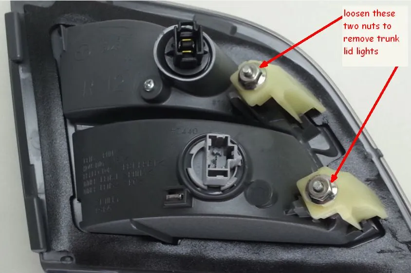

Removing the tail light is as simple as two screws. Remove them and pull straight back on the assembly. A trim removal tool may help you pop it out of the two clips that hold the light in other than the screws.

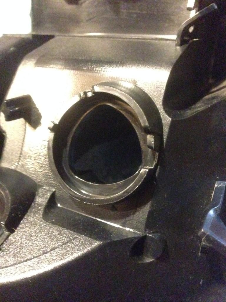

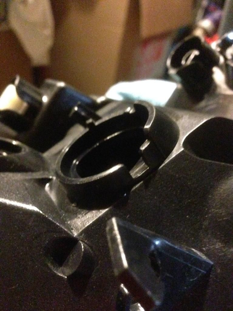

So, popping out the stock bulbs and unclipping the wires on the back the assembly comes free pretty easily. Now the Triton’s are designed to be able to go in practically any application and come with a myriad of screws, collars, and gaskets to be able to use. However, one issue arose right away. The plastic surrounding the hole is raised in order to stop the stock bulb holder from rotating freely. However, the heat sink of the Trition bulb is too close to the screws in this situation to fit.
This will need to be shaved down for the new bulbs to be able to engage with the hole.

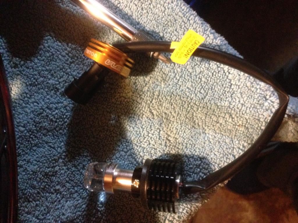

Here you can see the screw options of the bulb and the gasket installed.

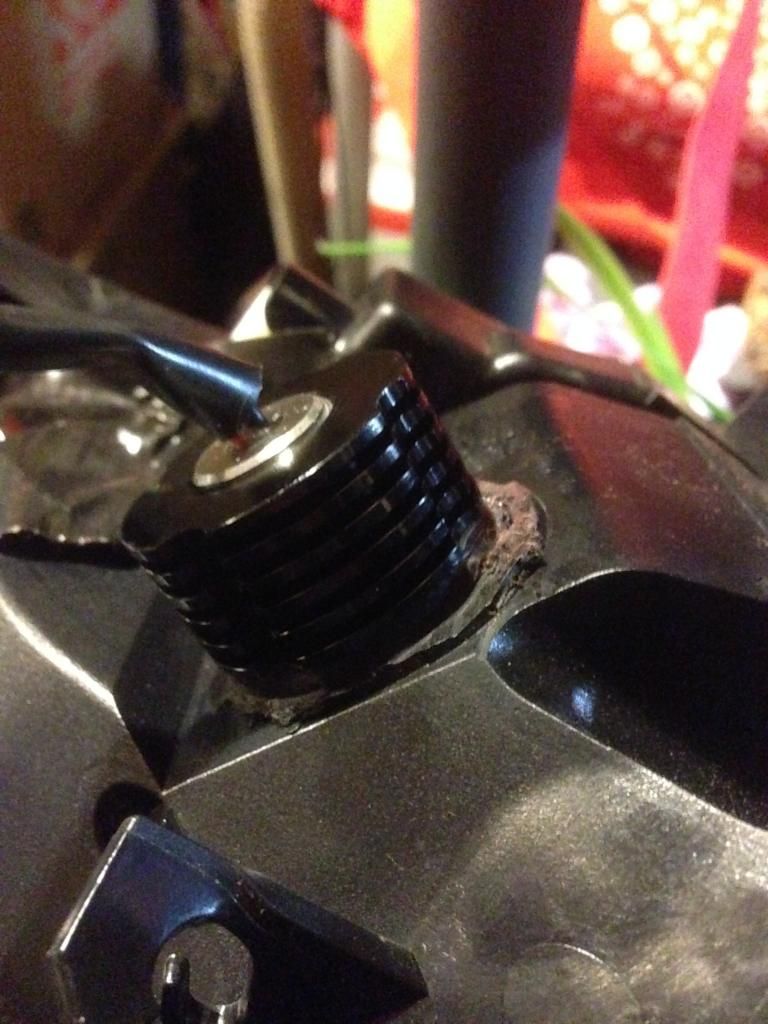

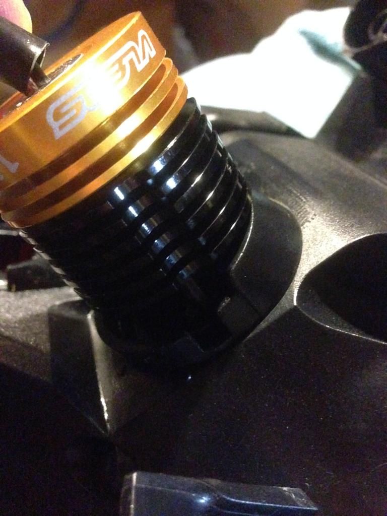

And we will run into more clearance issues. Explanation: The Tritions also have adjustablitly into how far they stick into the housing/focus on the reflectors. However, due to how tight it is behind the assembly, this adjustment has to be backed all the way in so that the bulb/heatsink don’t stick out. As the adjustment lock (the orange part in the photo below) is usually on the tail end of the bulb, it has to live down by the connector, where it can’t be slid off due to the size of the plastic. However, I had a solution to prevent this from knocking around too much:
After shaving, we have the bulb in!

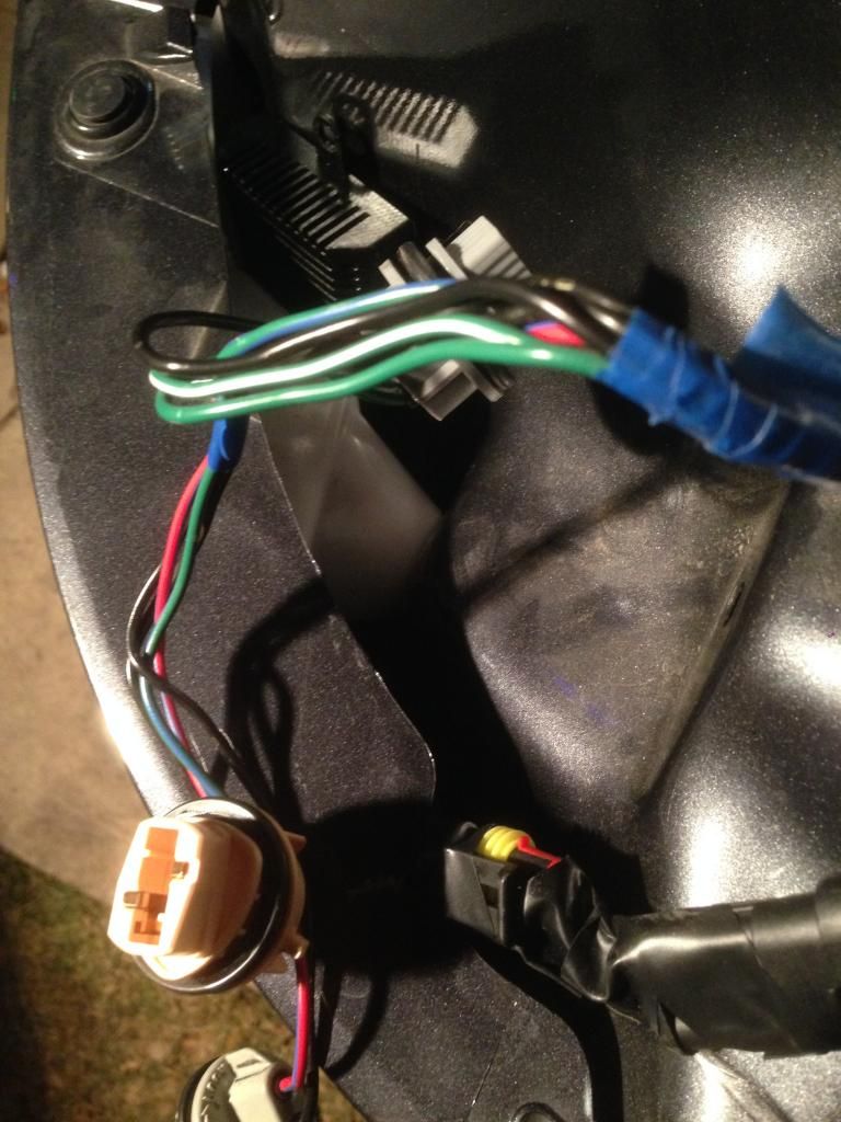

So the Tritions have these control boxes, that normally wouldn’t be a problem… If i had room… However, there is just enough to set it down below the assembly in a gap in the body and plastic of the bumper cover. Here I hard mounted it, and ran the cables from below it up around a white plastic spacer that was back there.
From this picture you can see the box mounted at the top, the white spacer in the bumper, and the triton cables coming out at the bottom.

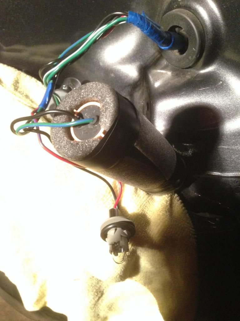

So, again the triton system is very modular, so the adapter to the 7443 bulb in addition to the stock socket are kind of a long assembly (about 4”)… This needs to go somewhere, and not rattle around. So I decided to use some 3/4” pipe foam insulation I had lying around and wrap it around the connectors. This then got shoved down into the space between the steel of the body and the plastic of the bumper.
