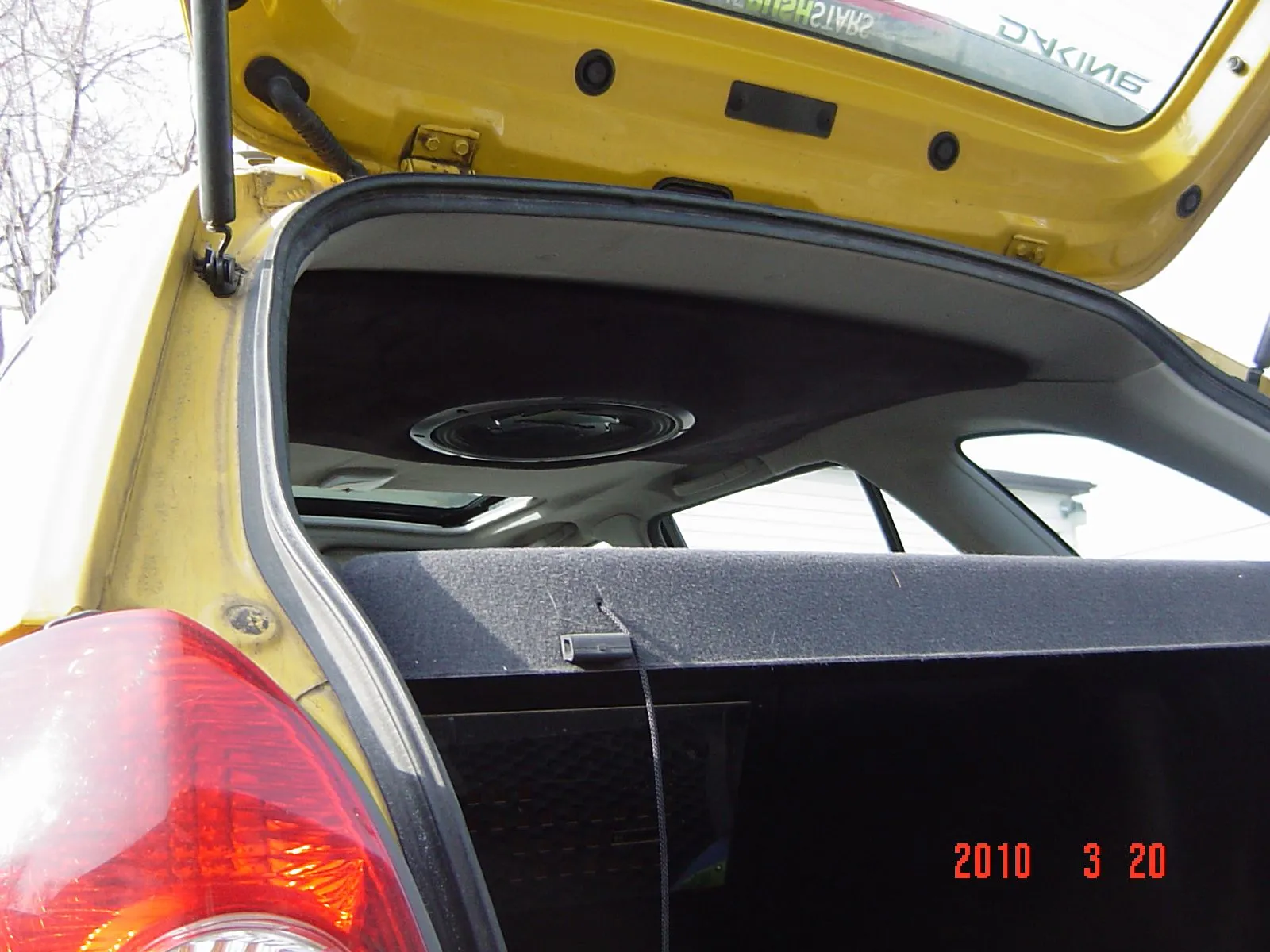

Have you seen my setup with the Rear Strut bar in...I know I have yet to post pics of the Trunk Reinforcement bar, but it is easy to tuck a 10" and amp to make it clean with lots of trunk space...allows you to keep everything in the car also...both allowed all panels installed and the two bars to be put in...the bottom box was a bit large, and I had the amps hidden behind it...just happened to be sitting on top in this pic...
This is a 12" woofer...sealed box...
This is a 10" woofer...ported box...

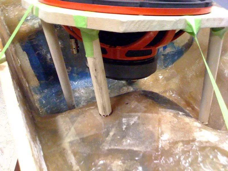

So I was lazy today and decided just to go to walmart and get some fiberglass and resin.
started glassing on the lower half of the mold just to get the MDF in place. (taking a break right now to cure) Once its dry ill work on the upper while the panel is laying down. Because I sure as hell aint glassing upside down. lol

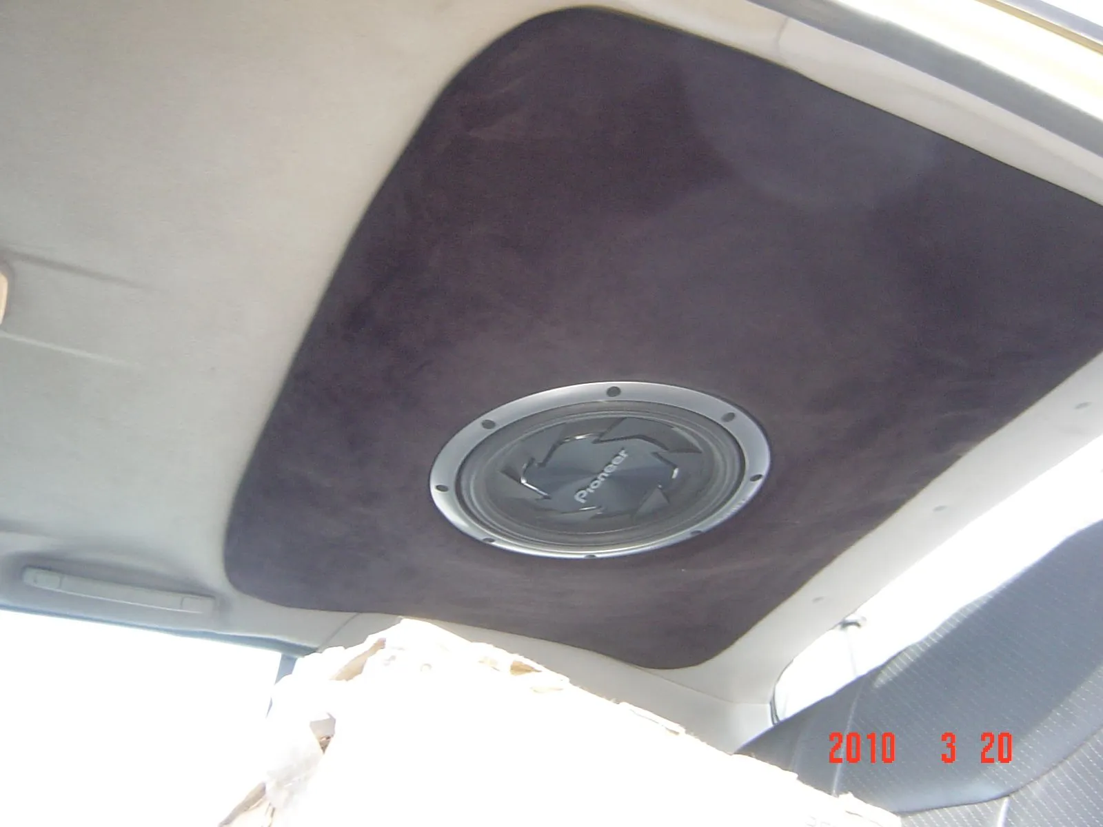

Have fun and take your time with the fiberglassing, the end result will be worth it. This is my little fiberglass project...
nice! I seen your write up on how you did it. Pretty clever lol did you get any heat damage on your roof from welding?
Thanks! No heat damage, just tacking the cross braces into place then did the finish welding out of the car.
Hmm its been a while..lol I have beenw waiting for the speaker ring to come in. lol

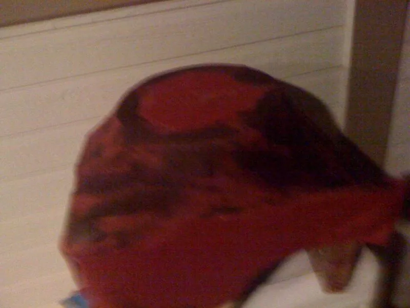

Anyways I have put up the dowels, fleeced and laid the first coat of resin. then I ran out before I could finish. (the fleece soaks up the resin good!)
So tomorrow ill pick up more resin and add another coat before adding the fiber.
Im still thinking about sanding it down and painting it when the time comes instead of carpeting it.
Well see how that goes...
Looks like a good start. Little tip for next time, use grill cloth or something like it instead of fleece. Easier to stretch into shape, soaks up resin faster (and needs less) and is less prone to warping and cracking. I use to use fleece when I first started glassing, now I pretty much only use grill cloth.
