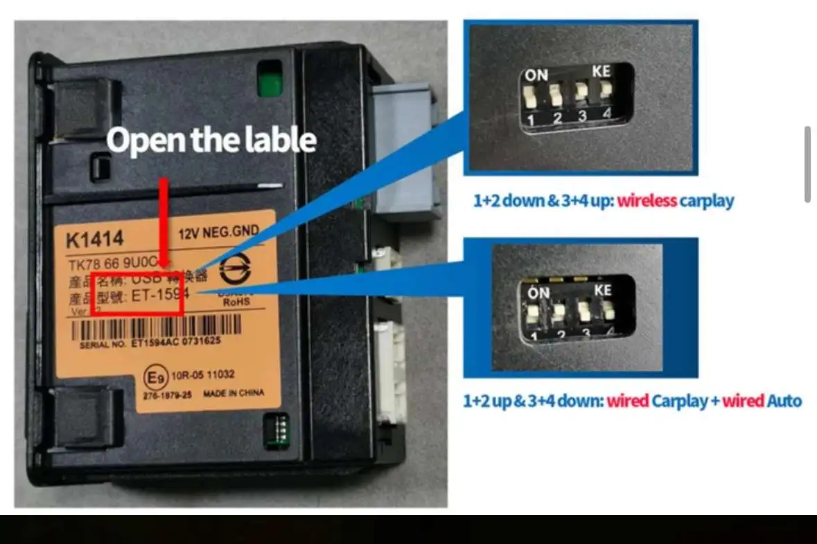

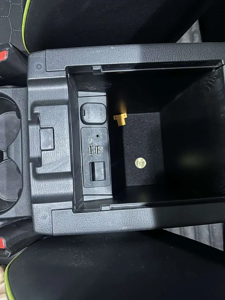

Good afternoon. I currently have a 2023 Mazda CX 5 from South America. As you know, the specifications here are poor and the CarPlay that comes with it is wired. I am currently looking for the carplay module to make it wireless. Has anyone been able to update it? I have asked and on Aliexpress they tell me that from version 2021 onwards there is no wireless module :(
