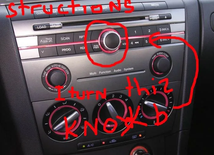

There's a thread somewhere on the cowl creak. You notice it in cooler weather. The fix is fairly straight forward and simple (though I haven't tried yet).
I posted my how to. Here it is if you missed how to fix the console squeak.
but seriously...thanks for the note, robin! that does sound like it's going to be my problem, because it doesn't look like a loose panel in my cabin! =/
